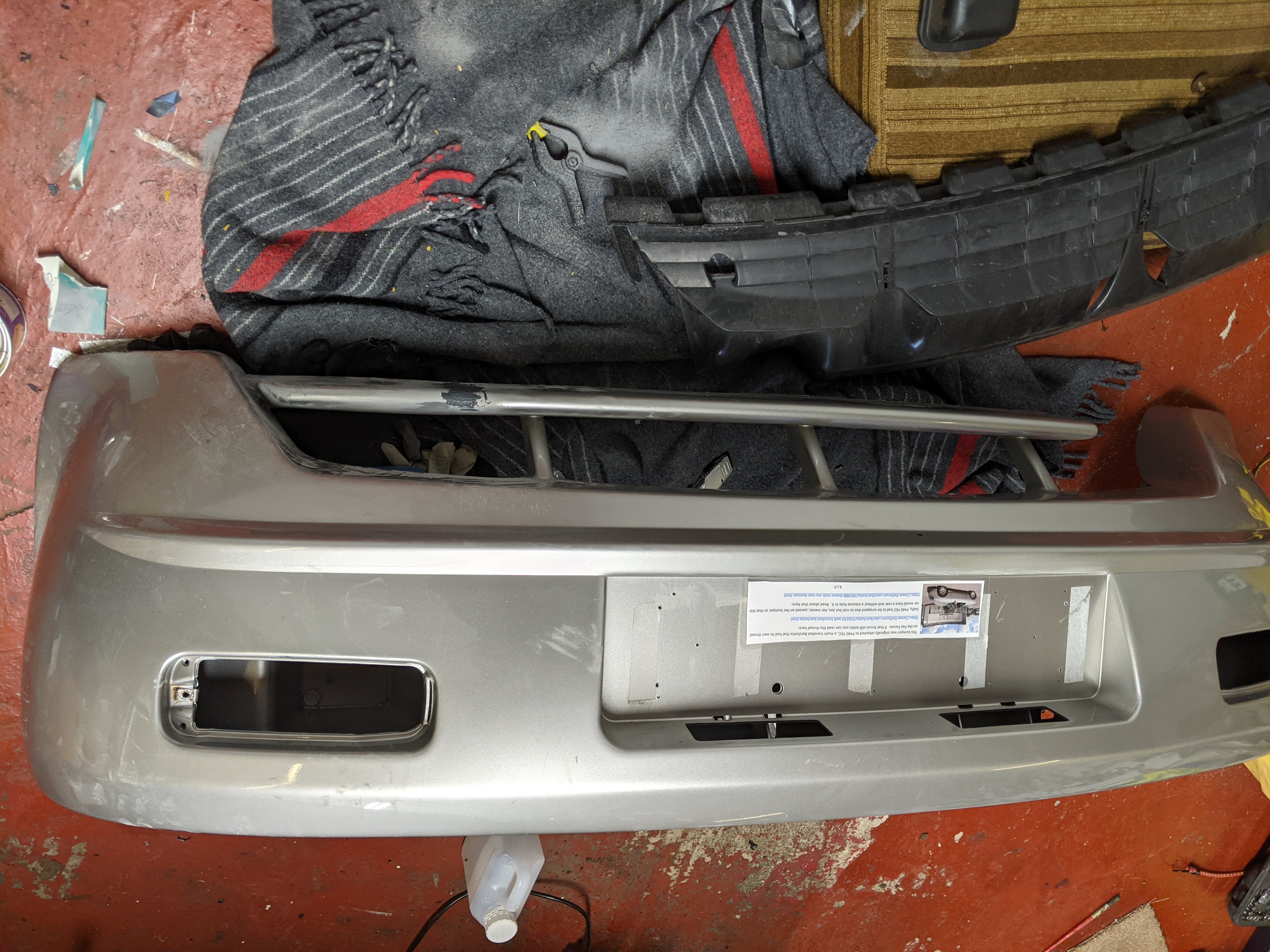

Progress update. I've now removed my bumper from the car, only destroying three rusted on fastenings in the process.
I've got the lower louvres removed from both bumpers and ready to be swapped over. However, the job before that was to transplant part of the bottom bar from mine to Jon's where his had been cut away for the exhaust. It's secured internally with glass fibre and resin and I'm just in the process of filling the gaps and sanding down before paint. Overall I'm happy with how it has gone.

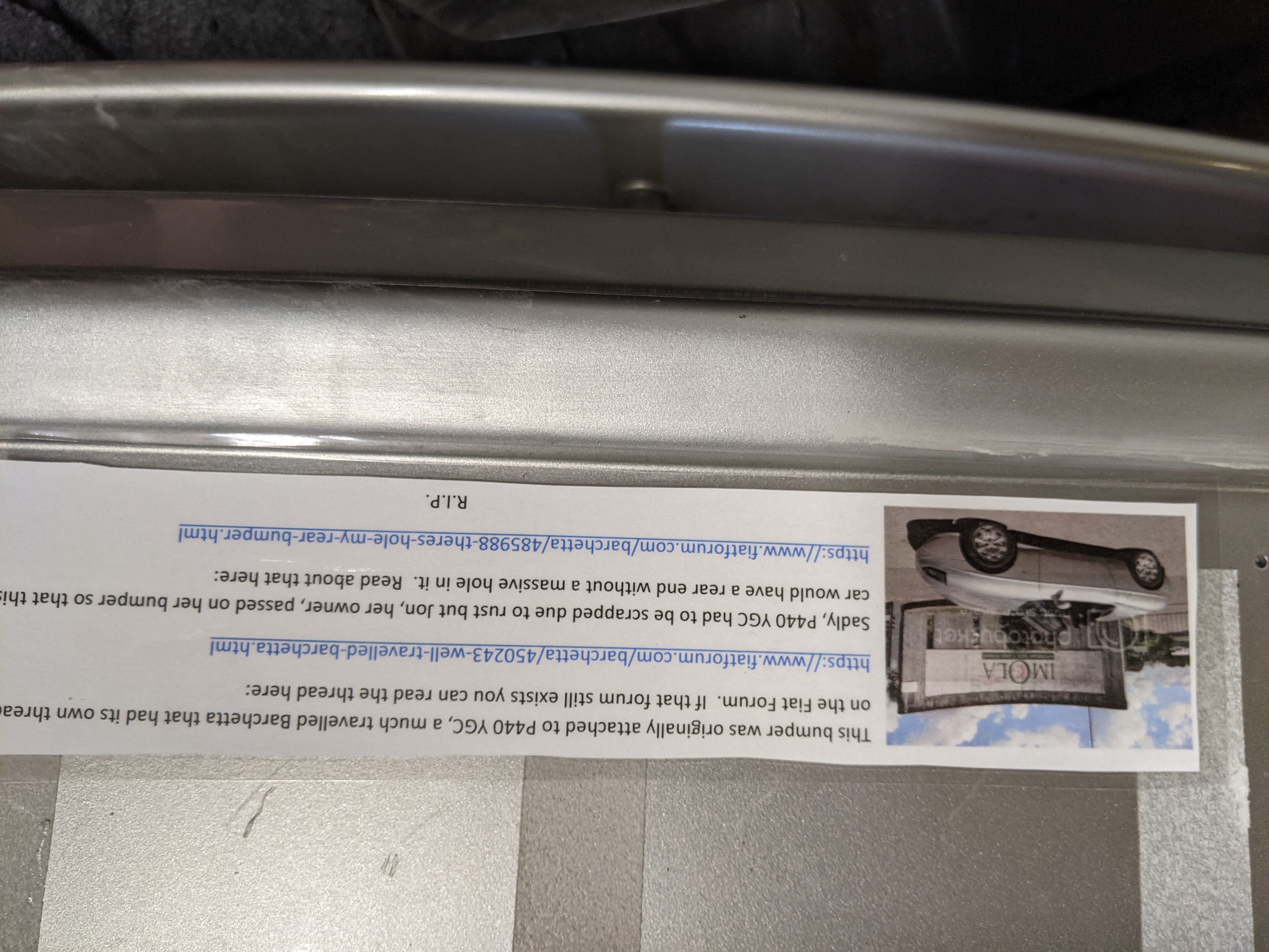

While I was at it I decided to leave a nod to the bumper's ancestry by hiding a little laminated message behind the number plate as an easter egg for a future owner/dismantler, hopefully you can see that in the second picture, I'll secure it in place when I put the plate on.

Just seemed a fun thing to do.

Bumper is finally back in place and I'm mostly happy with it. The join between the two parts of the lower bar is good enough for me. The rattle can I got made up came out a little on the dark side and so I sprayed the whole bottom bar and the fact it's in shadow means you can't really see the difference in colour. The louvres plastic welded back on OK and it's all back on the car.
I'm a little annoyed that the shut line on the right is narrower than on the left so I may end up having a little fettle with that at some point. Just waiting for the clips to arrive so I can refit the interior and I'm done.
Thanks for the help and advice, particularly to brianpoole for putting me on to plastic welding and to Barchetta Bloke 440 for passing on his bumper - she rides again.

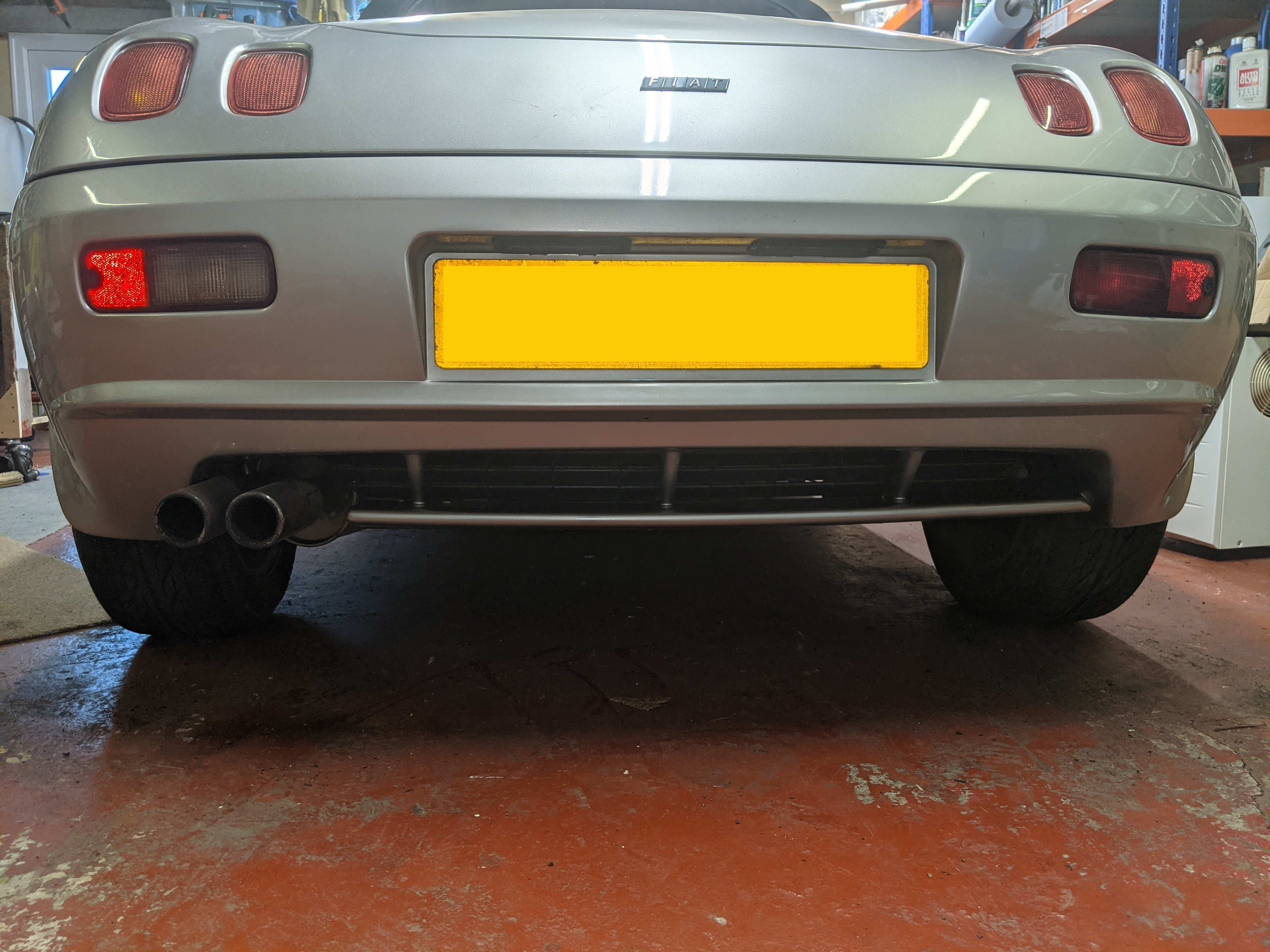

Here's the pic of the dual exit system on mine .

You can see a chunk of the bumper been removed to make space for the second set of pipes.
Is your dual exhaust a custom build, or is it available on the aftermrket? I´ve been thingking about it on mine, but hasn´t gotten to it yet.

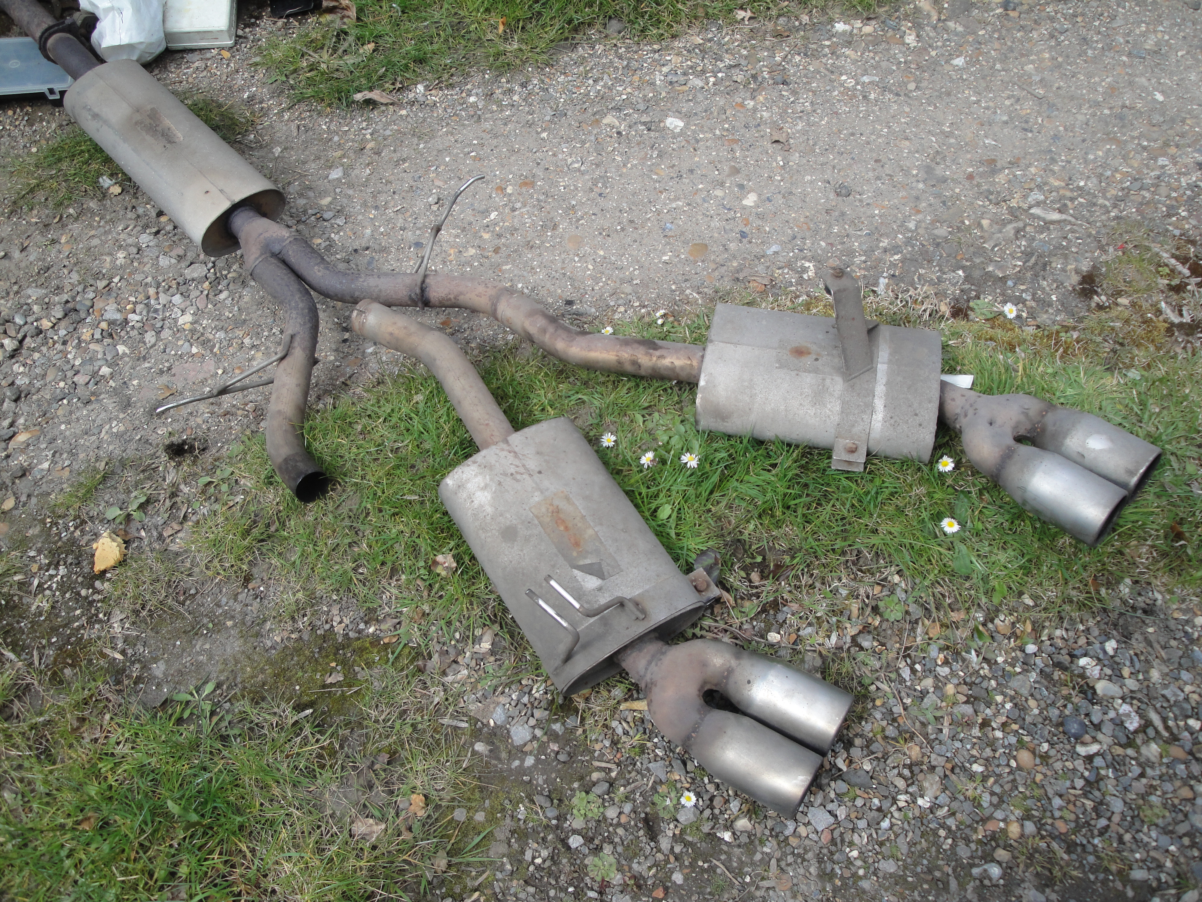

The twin exit system as it was called was a DTR Sportscars exhaust .
I was told when I bought the car in 2012 that it was the last they had and weren't going to make any more , but I believe they changed their mind later and may have made some more .
It needs the obvious mod to the bumper as seen and also needs an extra hanger mounted under the car to hold up the extra pipes as the split comes out of the end of the central pipe ,it's not just a back box .
