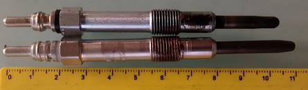

First thought was glow plugs, so had a look but someone had already put in 4 new NGK Y534J plugs. They all showed a resistance of 0.6Ohms. Then checked the plugs relay and this looked to be working in that it closed the relay and gave power to the plugs. Also checked the fuse and made sure that it had a good contact.
After looking around at plugs, it appeared that there were two options for the Multijet, one being longer than the other. See attached image.
So, I wondered if the NGK were shorter ones and whether a longer glow plug would solve the problem. Picked up some longer Bosch plugs (0 250 202 132) at half price on Mister-Auto.ie. Put them in this morning and the car started far better than it ever did, although not perfectly! The relay looks like it is acting up now. :mad:
Verdict:- if your Multijet is difficult to start and everything else looks OK, then the plugs fitted could be too short, as in the image attached.
What do you all think, could this be something?

Putting in the longer glow plugs did help a lot, but it's not like it should be.
