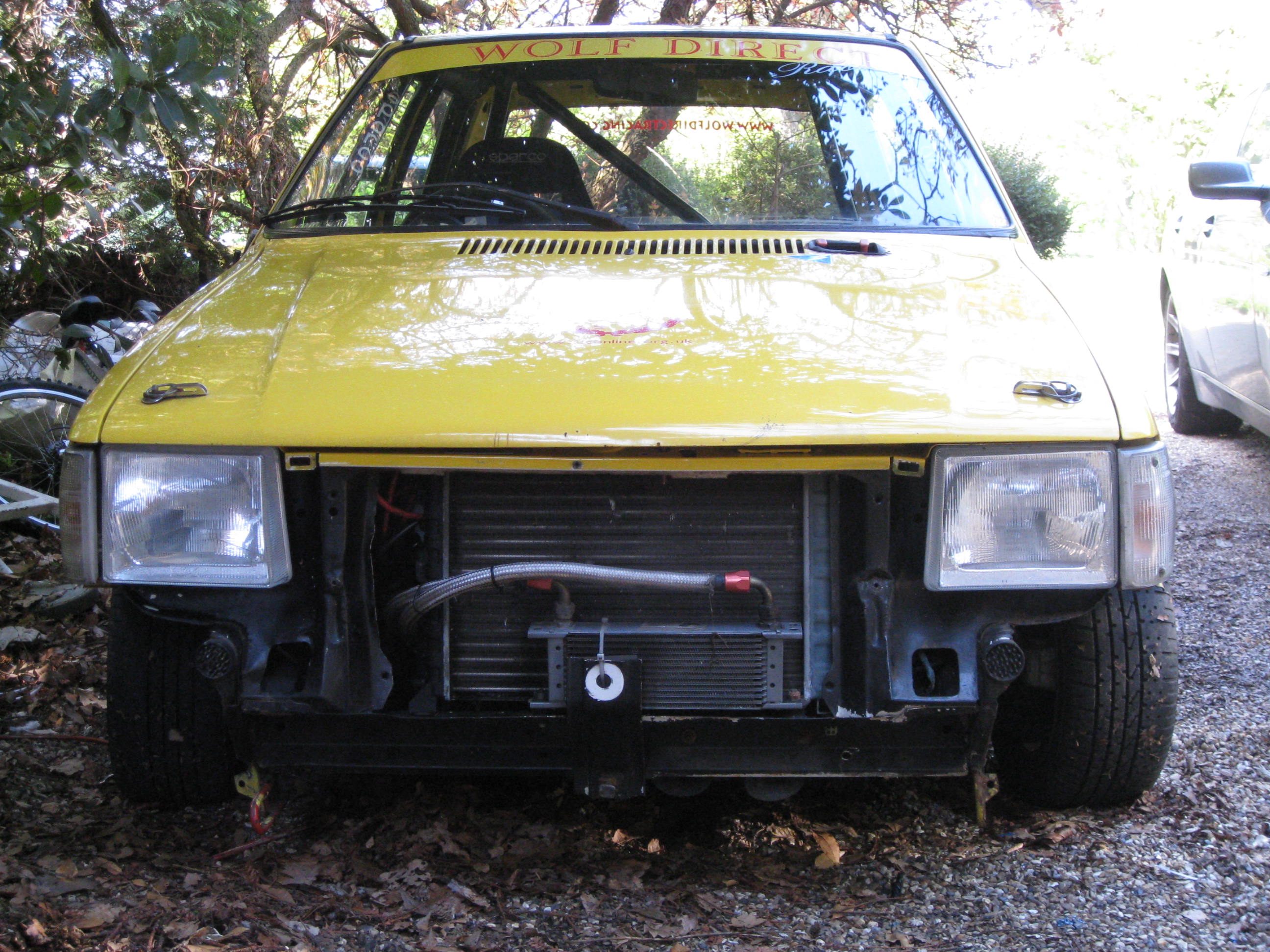

I want to get the whole car yellow, so i took the bumper off and began spraying over it in primer - I hadn't researched it properly and it turned out completely ****.
I was using paint from a can, and in the wrong conditions so its a total mess - Im going to strip it off and have a go when i get my proper spray gun sorted.
I defo prefer it with a black grill:

The headlights were really cack and rusty so i bought some new ones to go in there (thanks fiatunoturbo1) i think they look loads better.
They also wernt working, it was the bulbs, so I got some new ones that are 80/100w -big mistake! they are too much for the unos wiring and full beam heats the wires up big time... I think ill go to 70w and do the relay mod from alex
They are brighter tho - 100w on the right 60w on the left

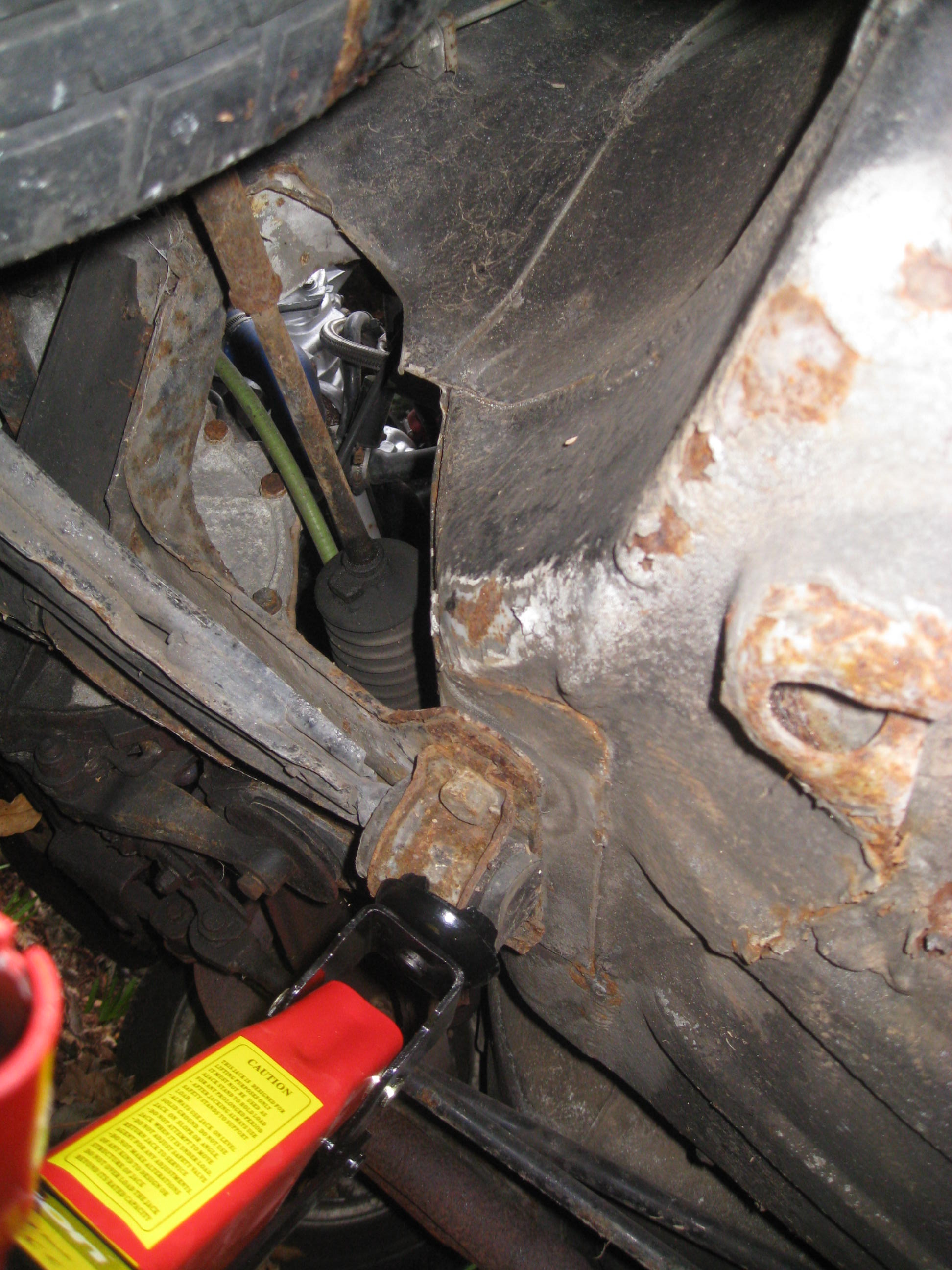

ive also refurbed the rear springs off my uno turbo, to stop this car killing me (it has a mental rear end, because the rear springs are SOOO hard, these are a bit softer :) )
Ive got some rust free doors: (thanks wayne)

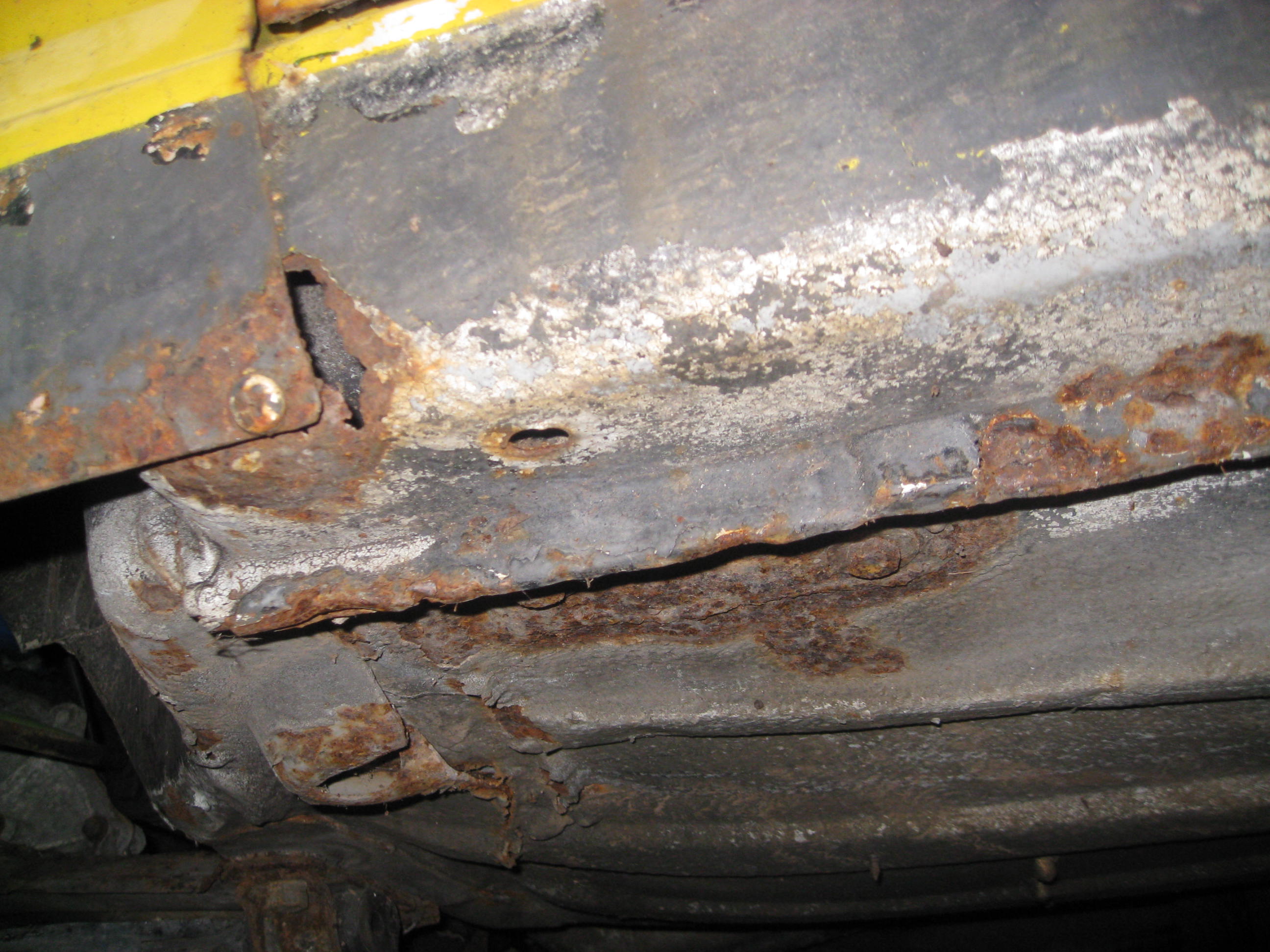

and some brand new sills (!) (thanks ebay)
to go on when i get my spray gun sorted, and nick my dads welder
whilst admiring how rusty the underside is :banghead )

started to patch the current sills to get through MOT:
treated the rust:
got some P40 on 'em::eek:
that will need sanding sown and finishing off with p38, just to get through this mot

dont like this windscreen based rust:

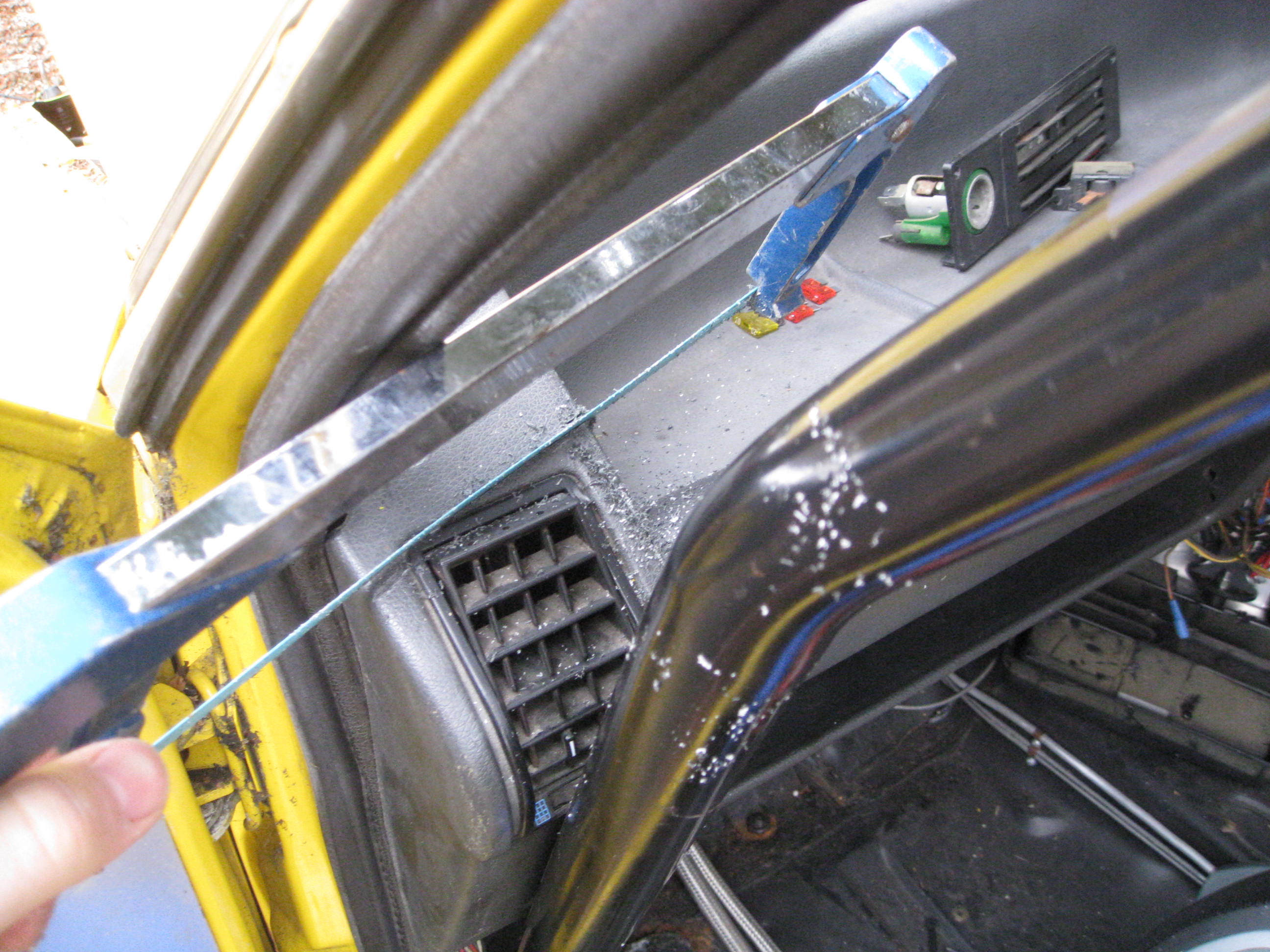

Loving the pictures Matt (y) It's a cool looking project and I look forward to seeing more progress!
I have to say though that I went :eek: :eek: :eek: when I saw you taking a hacksaw to the dashboard! Is there no way you could get it out without cutting it? It's quite flexible and pulls UP from the mountings so you may just have been able to squeeze it past the roll cage. Talking of which, is the the roll cage bolted or welded in? If bolted you might have been able to unbolt it and move it back a bit just to get the dashboard out.

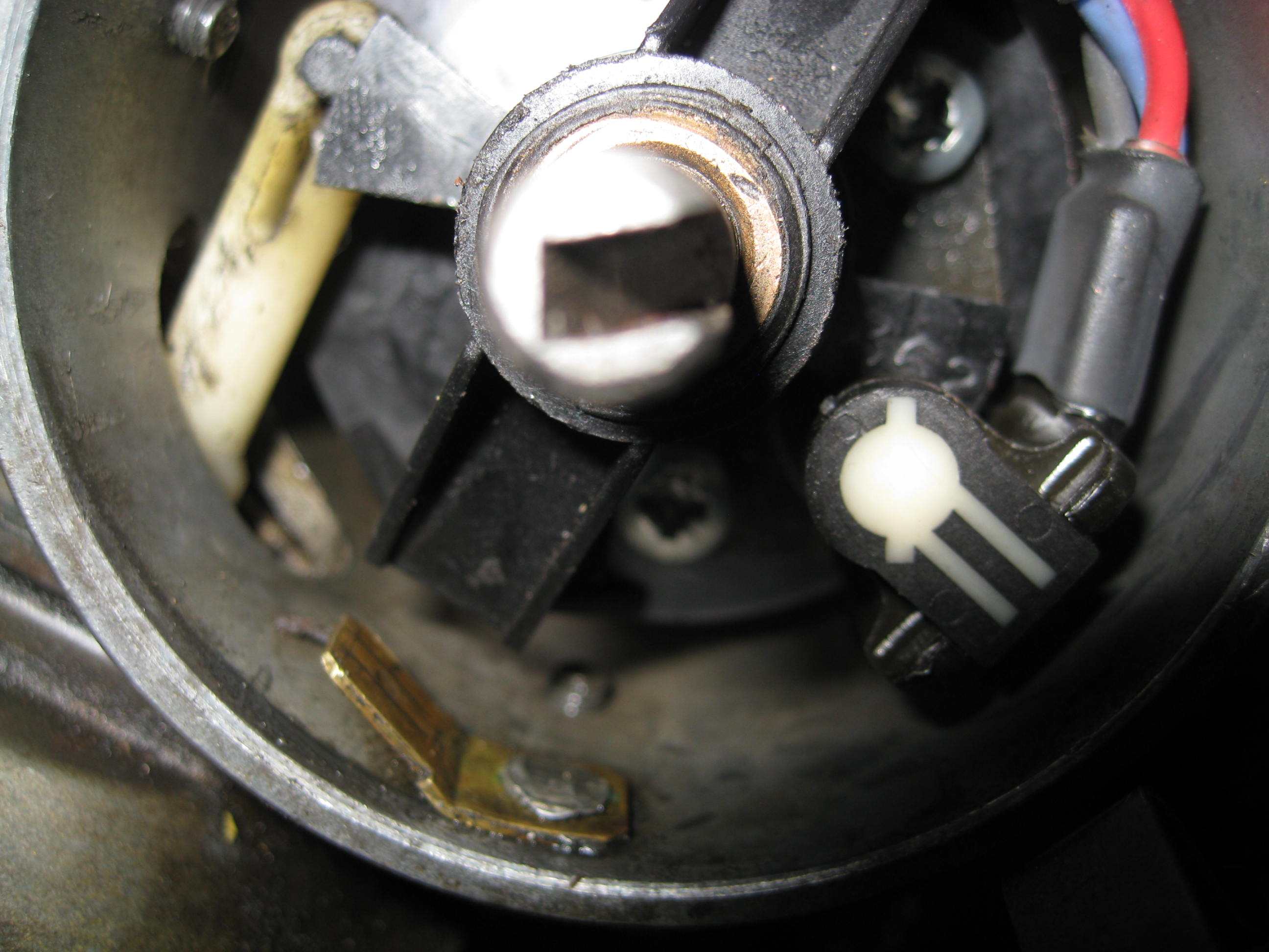

also, the fuel pump makes lots of noise and some ticking,and dosent prime properly i.e., when the ignition is on, the fuel pump is running and dosent turn off by itself - to get it to run i have to syphon fuel to the carb through the pump before i start it - is the pump buggered or is it just the wrong type or something ?
any ideas appreciated
if you got an electrical pump, that would flood the carb with gas, and that would mean that the car wouyld need much revs and air to at least run, and it would go spitting and misfireing because of all the fuel. the pressure in the fuel system of a car with a carb (after the mecanical pump) is about 0,2 - 0,3 bar.

yeah distributor is on the list of things to check when i next see it...

Usually when toy have manual points, these is a capacitor (Known as a condenser) which (I think) helps give a better spark. The two are usuely replaced at the same time. I have had a failed condenser back in my poor student days which took ages to work out!

the condenser is sort of a battery, which is connected in parallel with the points (?) and the only thing it does is to make sure that when the points open the circuit is broken instantly. because these things happen really fast, as an example, when a four sylinder engine has 3000 revvs, there is 6000 sparks per minute, that means 100 sparks in a second:eek:
so the condenser is only helping the points breaking the primary circuit in the coil instantly.

i though someone would have that reaction - notice i too the hacksaw pics first person - texas chainsaw massacre style :D

yeah im getting rid of the 100w bulbs - they are WAAAAY too much hassle, and totally the wrong way to go for the uno if your looking for brighter lights
