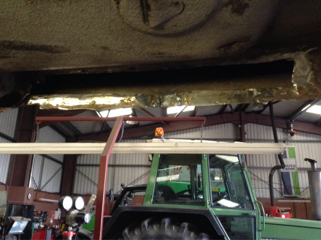

ImageUploadedByFIAT Forum1433193933.596903.jpgImageUploadedByFIAT Forum1433193987.040857.jpgImageUploadedByFIAT Forum1433194026.940225.jpgImageUploadedByFIAT Forum1433194058.983606.jpgImageUploadedByFIAT Forum1433194120.158814.jpgImageUploadedByFIAT Forum1433194232.457589.jpgImageUploadedByFIAT Forum1433194260.823529.jpgImageUploadedByFIAT Forum1433194298.265053.jpg

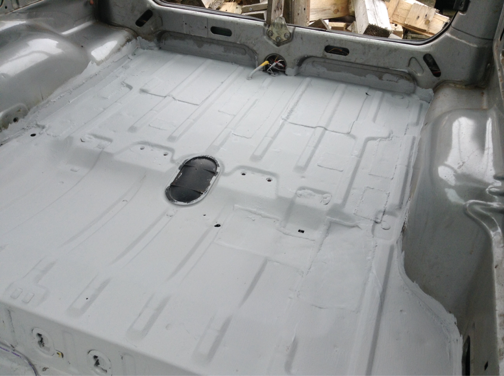

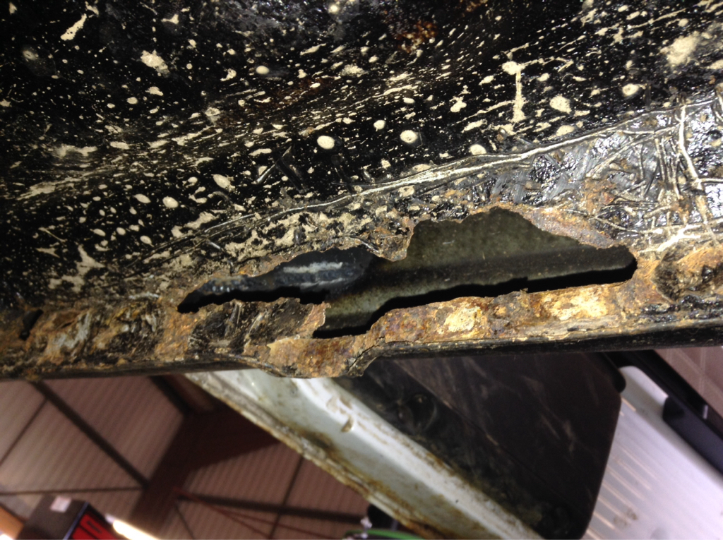

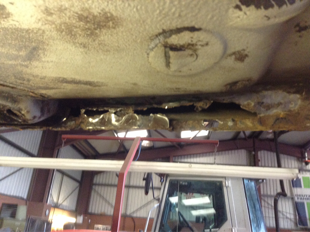

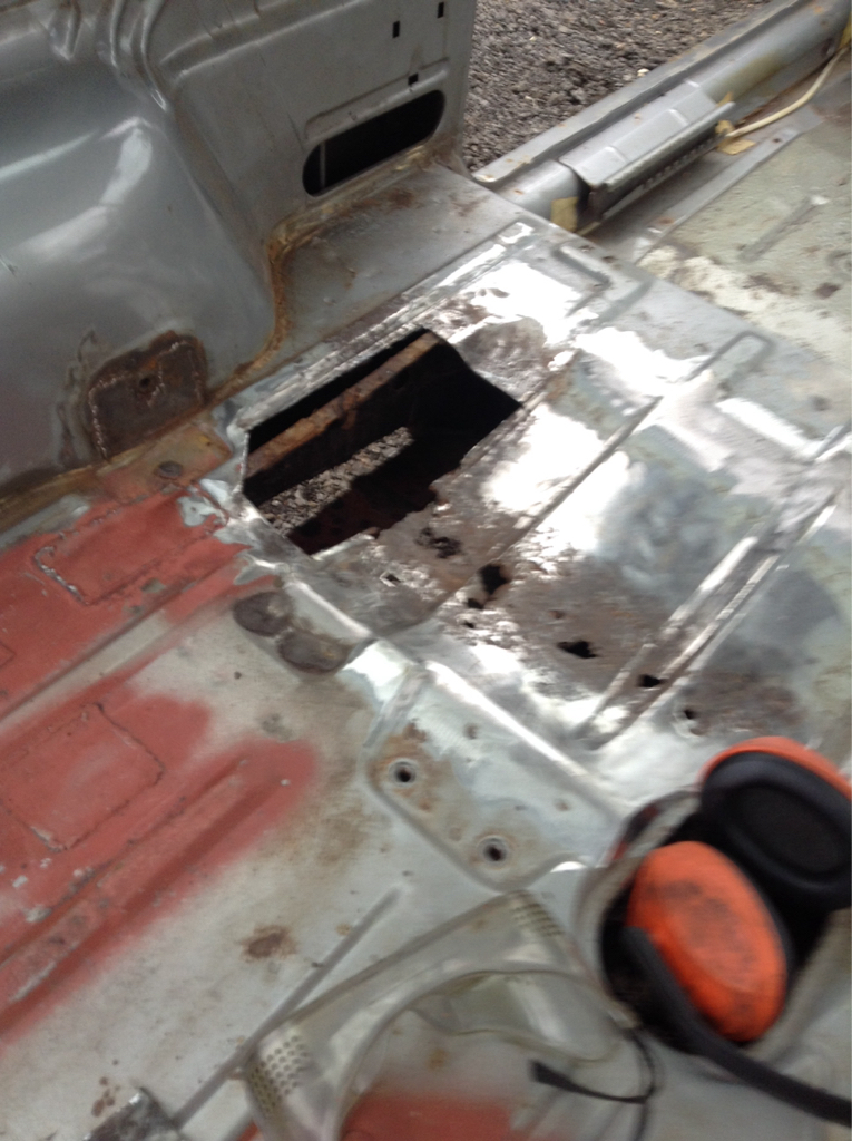

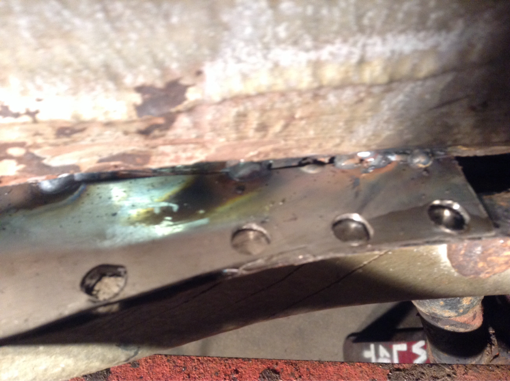

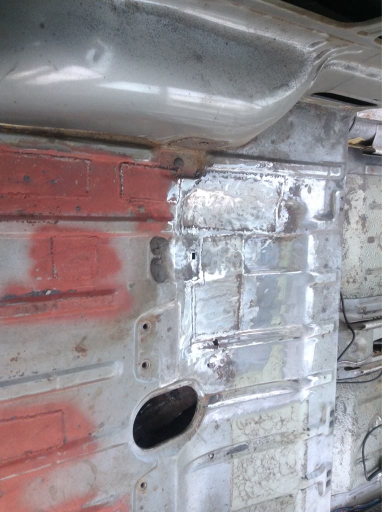

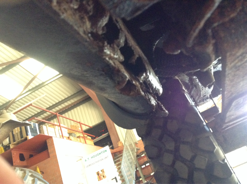

I then had to rebuild the wheel arch which was fun ����

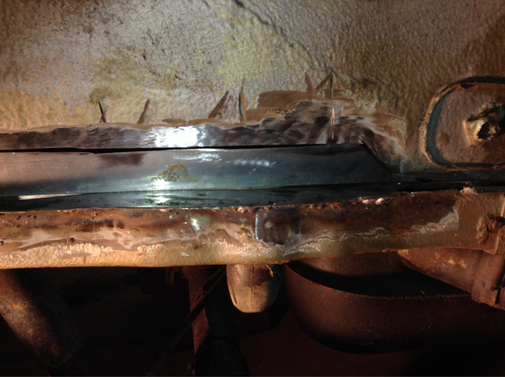

ImageUploadedByFIAT Forum1433194430.981749.jpgImageUploadedByFIAT Forum1433194495.934432.jpg

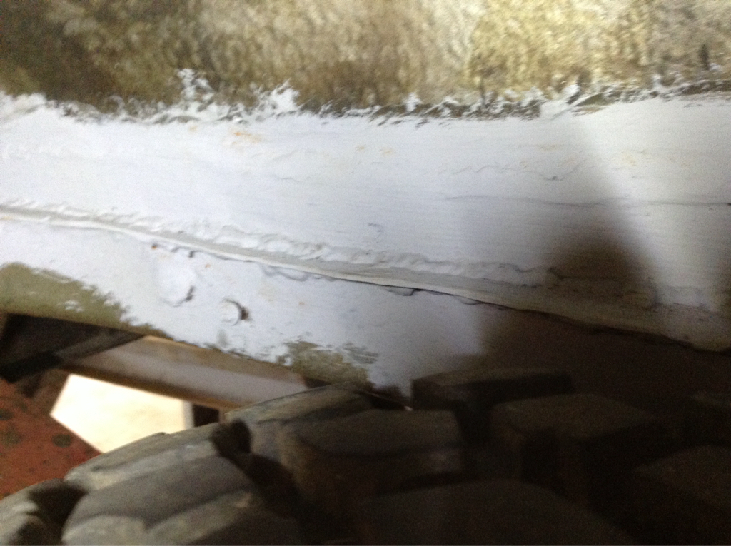

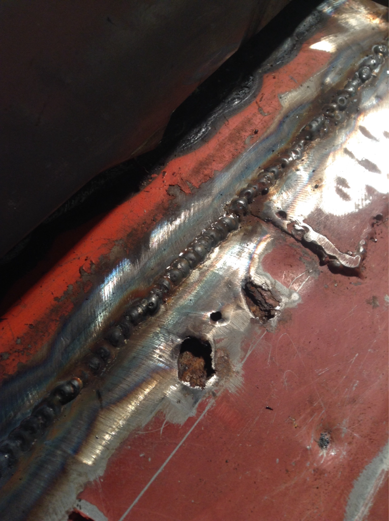

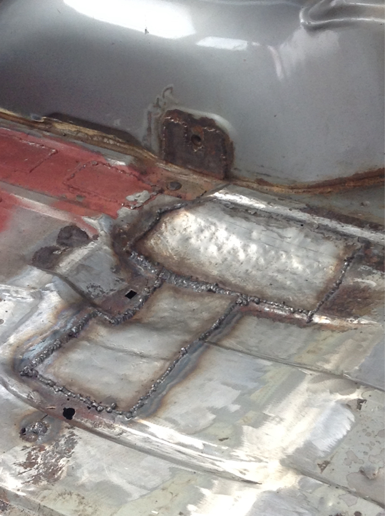

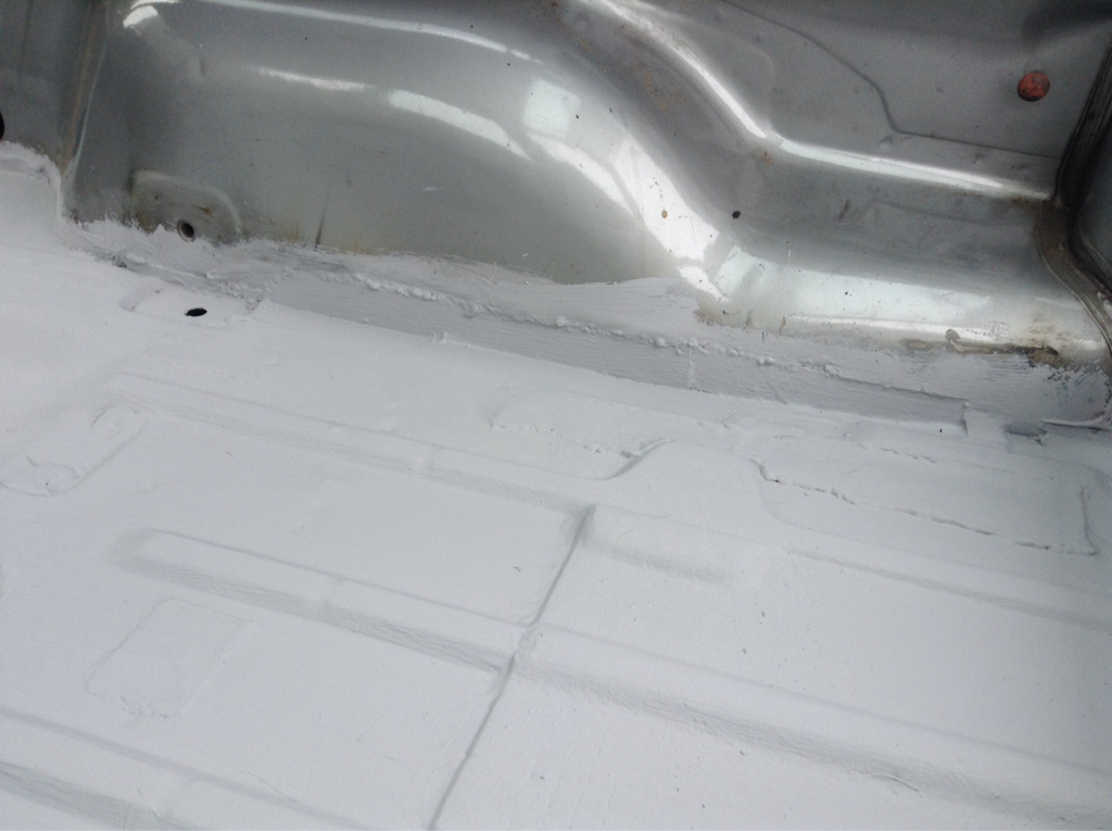

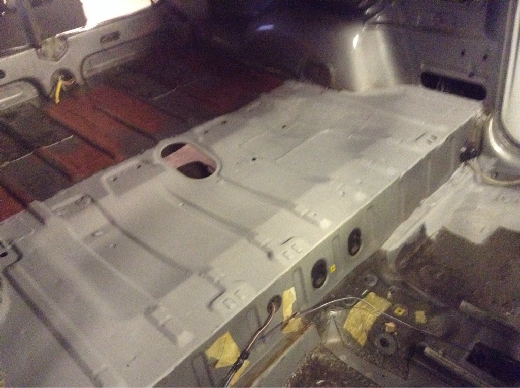

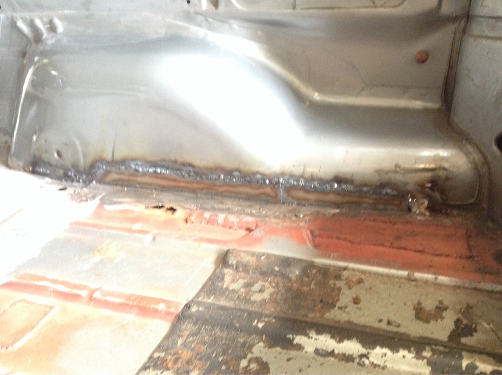

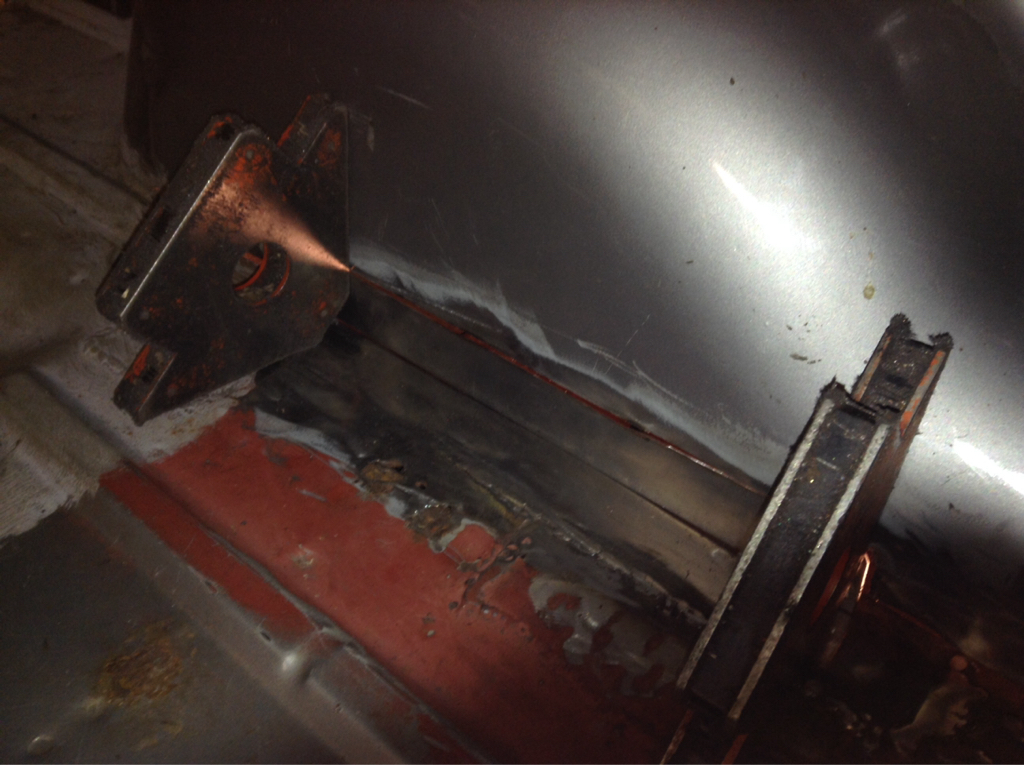

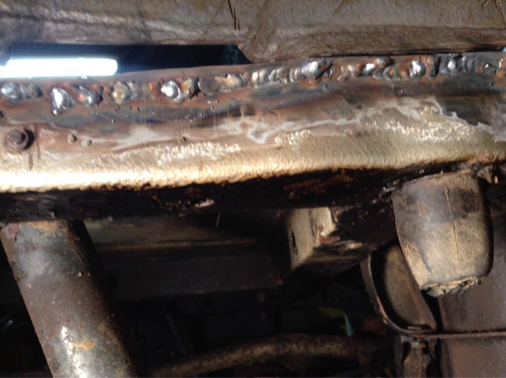

I used thicker steel to replace the chassis rail flange and floor steel in one go just for the ease to be honest.
ImageUploadedByFIAT Forum1433194733.971872.jpgImageUploadedByFIAT Forum1433194805.629749.jpgImageUploadedByFIAT Forum1433194881.194470.jpg

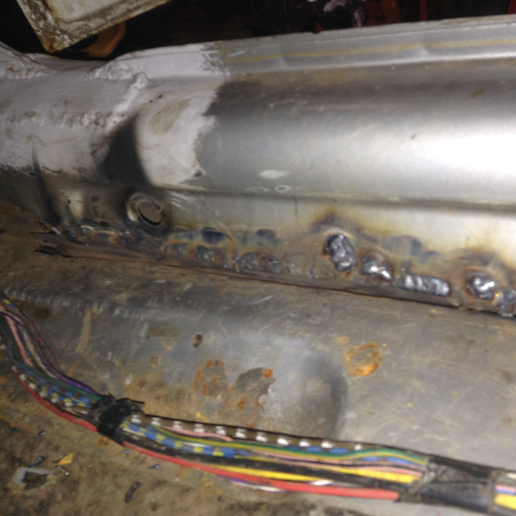

instead of the three pieces of arch, floor and chassis rail that were originally spot welded together I just welded a sort of tee fillet, this seems to have worked well for me
ImageUploadedByFIAT Forum1433195158.018873.jpgImageUploadedByFIAT Forum1433195213.208764.jpgImageUploadedByFIAT Forum1433195279.195334.jpgImageUploadedByFIAT Forum1433195323.904525.jpg
still looking for a new wheel arch cover as mine is missing.

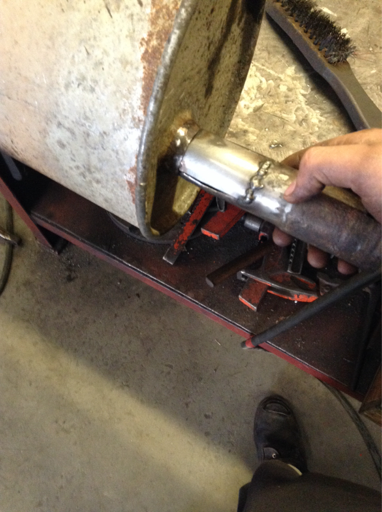

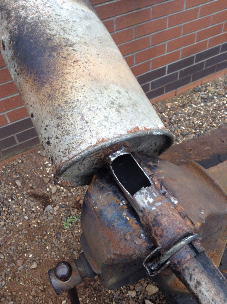

Time to address exhaust
ImageUploadedByFIAT Forum1433195851.627080.jpgImageUploadedByFIAT Forum1433195893.788154.jpgImageUploadedByFIAT Forum1433195997.862184.jpg

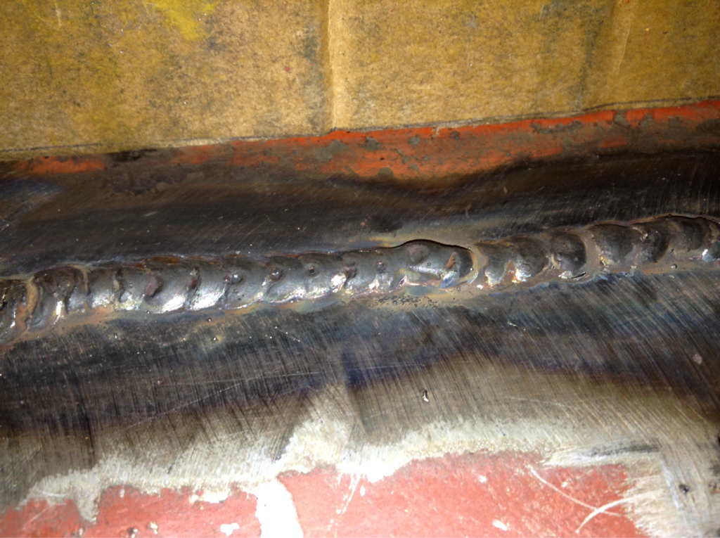

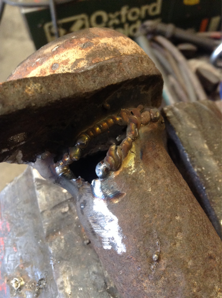

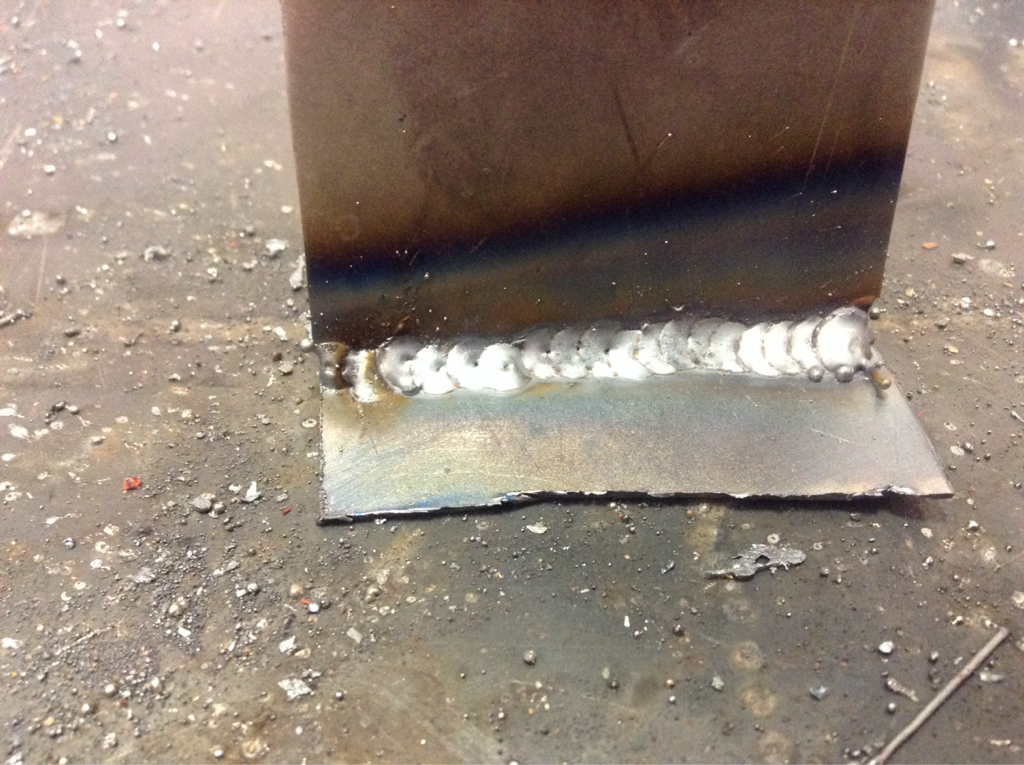

just some practice welding
ImageUploadedByFIAT Forum1433196160.717122.jpgImageUploadedByFIAT Forum1433196224.754320.jpgImageUploadedByFIAT Forum1433196268.890588.jpg
I would recommend anyone to get a panda classic as a project their boxy shape does make welding and repairs a lot easier!

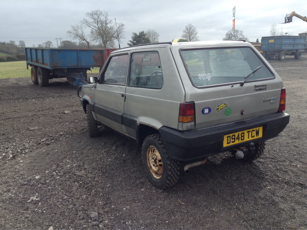

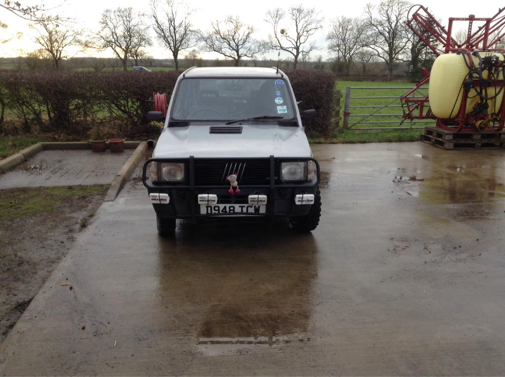

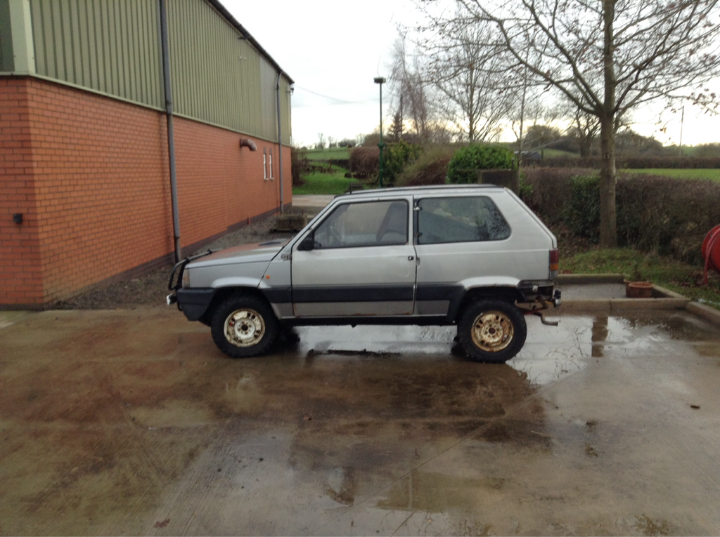

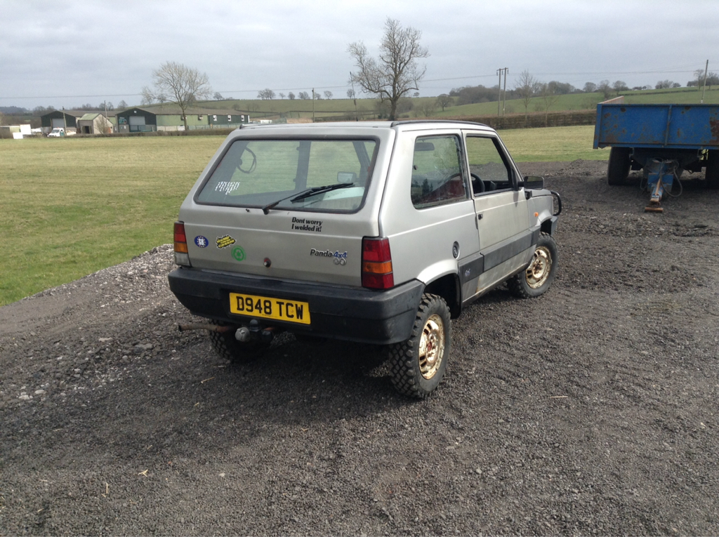

I'm in Leicestershire Andy. it's still not got an MOT I need to fit my new rad, windscreen and there are some rubber boots missing on the suspension arms and fit the exhaust I've welded and painted today
when it's done I'll be sure to let you know. Then again I'm 17 so I'm still having driving lessons at the moment �� Alrite as a first project to practice my welding
