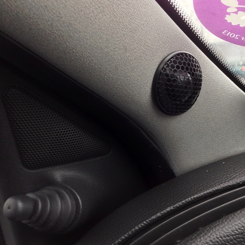

The tweeters wouldn't fit in the existing slots, by the mirror controls: so have been installed in the A-pillars:

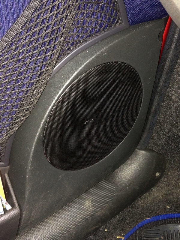

Also: the speakers needed new 'pods' to fit in the doors. Personally, I think these are rather neat... (although, sadly, I've lost that useful little pocket that used to be there...:

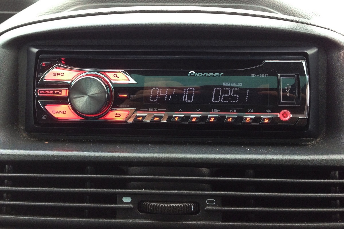

Here's the HU, for sake of completeness:
Haven't yet had time to look at the rather large PDF of a manual; but a quick fiddle with the controls means that Radios 3 and 4 are now pre-set; and that Joni Mitchell (yes, I have eclectic tastes...) now sounds clear as a bell... -- even whistling down the A46 at 70 mph with my hearing aids on.... :D

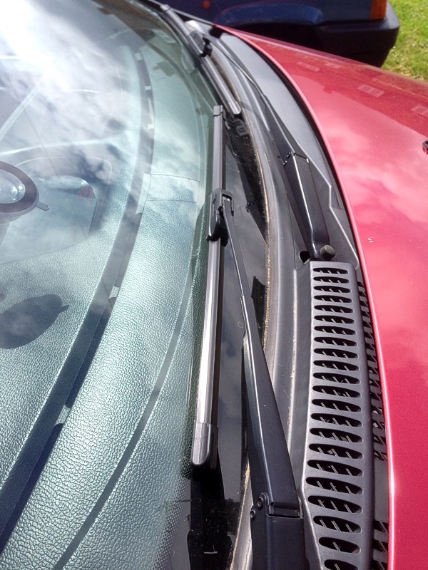

I started with the easy stuff: new side repeaters (as I rather like all the dark stuff on the side of the car -- mirrors; rubbing strips; wind deflectors; mudflaps, etc....), and new wipers -- a pair of Bosch Aerotwin Retrofit Flats. (One of the repeaters was slightly cracked; the other kept filling up with condensation. And both wipers were, at a year old, starting to reach the end of their usefulness.) :eek:

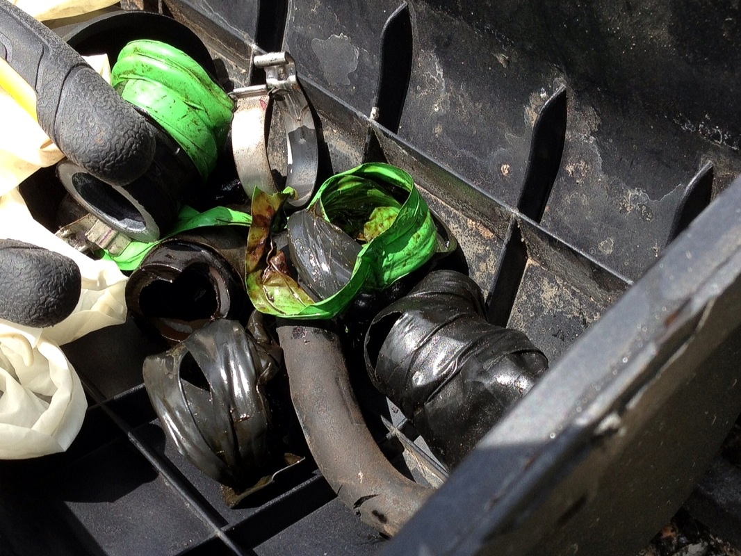

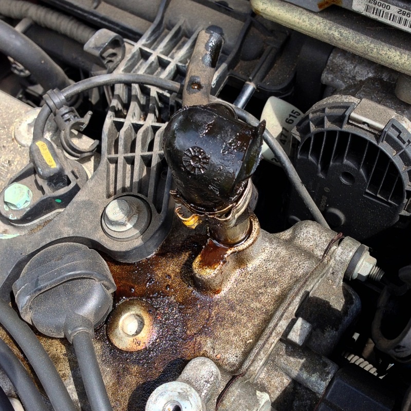

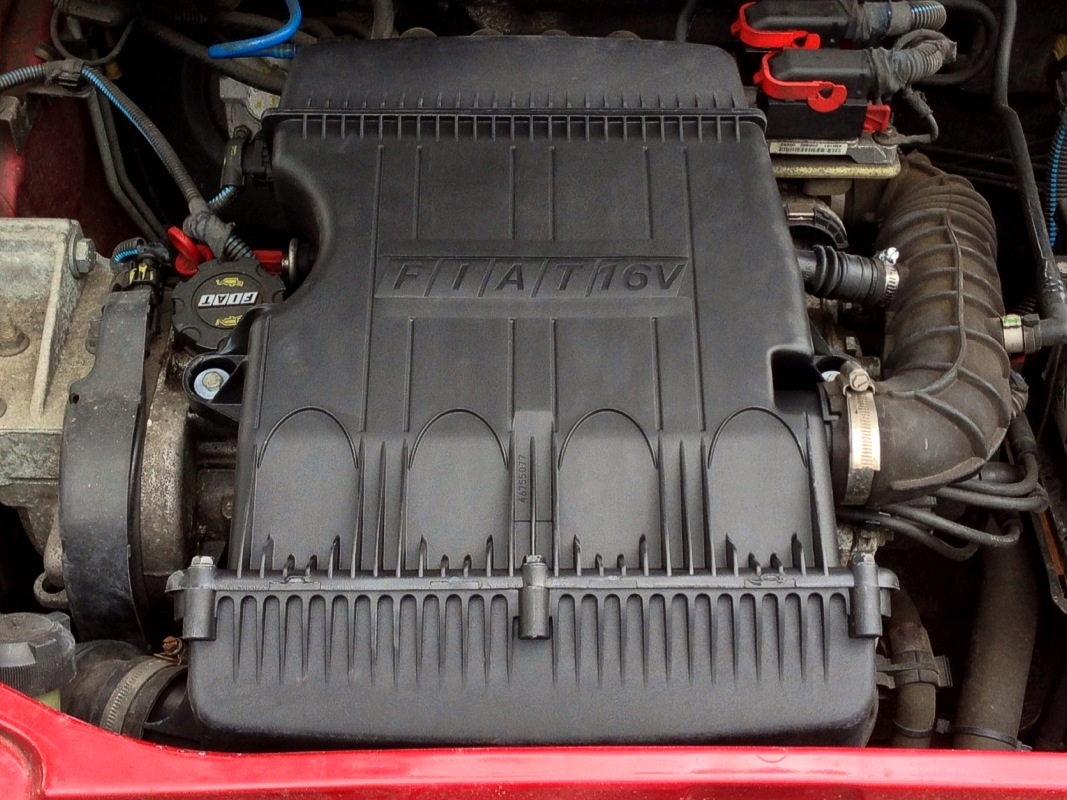

The next thing to tackle was the leaking breather hose -- which was starting to mess up the engine compartment... -- and the cracked air filter box (which was also lacking a bolt: and therefore vibrated annoyingly at certain revs...). :(
After taking the old box off (and throwing away the year-old filter -- which seems to have attracted rather a large number of dead wasps, during its short life...), the hose simply disintegrated.... :eek:
It actually came off in three pieces -- one of which was very badly perished -- and was more repair/tape than rubber.... (n)
I cleaned everything up; got out the new air filter that I'd just bought; discovered there was already one in the new box; and then reassembled everything -- using jubilee clips, rather than those stupid metal bands that FIAT so seem to love.... :rolleyes:
If anyone can spot the 'deliberate' mistake, then I'll buy them a drink at Stanford Hall. :confused:
Anyhoo: the car now seems quieter (especially on tickover); and it'll be interesting to see if this has any effect on economy.... :idea:

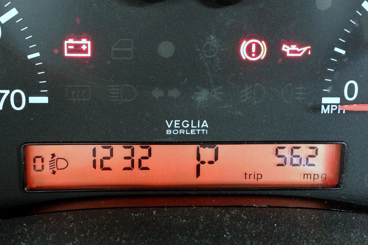

Well, I must have done something right...! :D
This is from a 170-mile trip of mostly motorway miles.... And, yes, I know the gauge is optimistic... -- for instance, for the last tankful, it said 47.4: versus a calculated figure of 43.83 (so about 8% over...) -- but my reckoning is that this equates to about 52.0 real miles per gallon. (y)
PS: According to automobile-catalog.com, the official consumption/economy figures for my Punto are 33.6 mpg EU urban; 51.4 mpg extra-urban; and 43.5 combined... -- which is pretty much what I'm getting (using Shell's V-Power Nitro+ super unleaded...). :)
