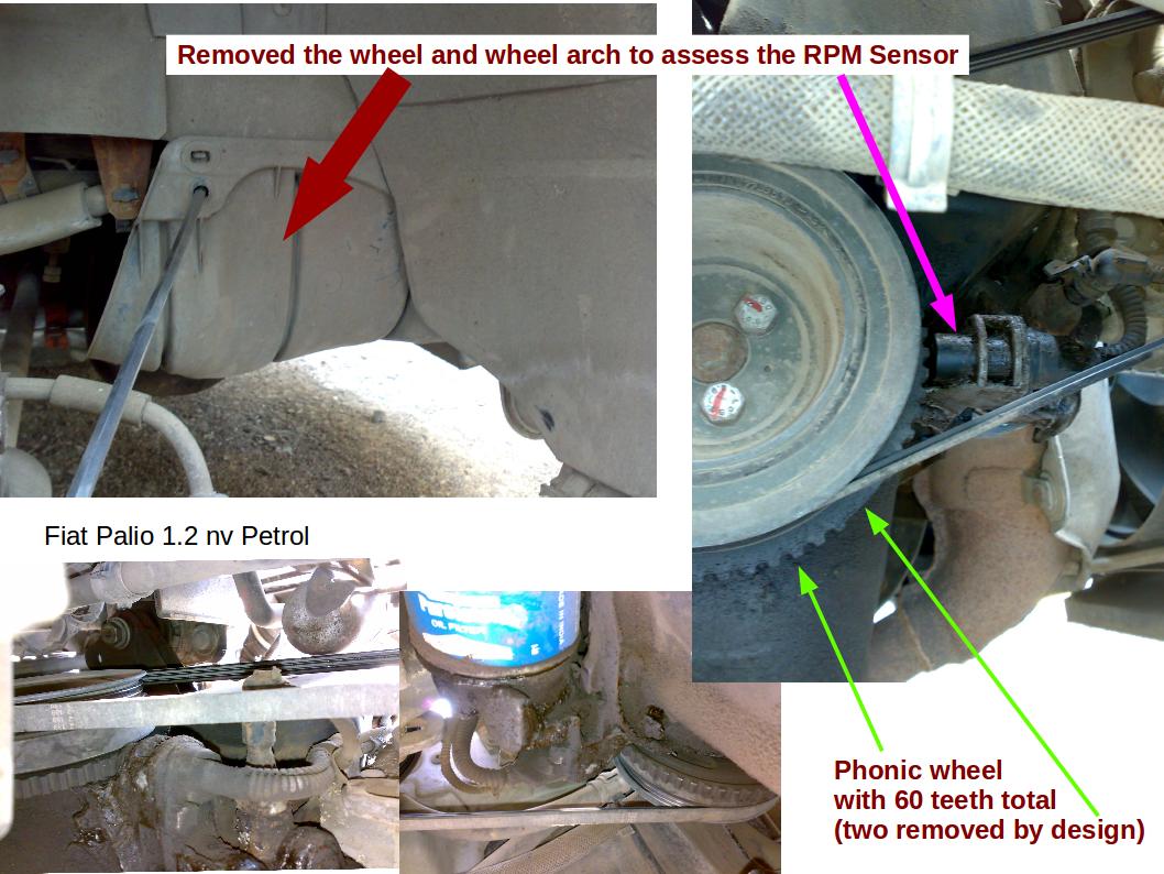

As per my previous post, I am updating herewith detail about how I replaced the RPM/TDC Sensor.
The new original sensor was perocured from 99rpm.com.
It has undermentioned specification:
Part No. 55189518
Description: SENDING UNIT
Embossed marking ; 55189518, C148, Magneti Marelli, 4E26
Imported & Packed by: FCA (Fiat Crysler Automobiles) India Automobiles Private Limited
Using multimeter, the resistances were measured. Between its 1 & 2 terminal it has 1142 Ohms resistance where as between 2 & 3 and 1 & 3 the value is Infinite.
(NOTE: All values in older sensor were 0.7 Ohms – showing SHORTED status of the sensor).
PROCEDURE:
1). Lifted the car on a jack, stabilised by supporting through virticle stem and took all applicable safety precautions. Battery was also detached as per the prescribed method in the manual.
2). Removed the front right (driver)side wheel and wheel arch/cover. This facilitates easy assessibility of the parts replacement and fittings.
3). Cleaned the mounting and peripheral space completely and also released the wire holding clamp and bolt fitted to fix the old sensor. Pulled the old sensor and detached, Also detached the electrical connection of it lying just above the enging head cover in the bonet. And finally removed the old one.
4). Recleaned the mounting space and mounted the New Sensor following the steps in reverse order described in abov #3 . reconnecte its electrical connection.
5). Care is taken that its wire must not touch any of the belts around it and the location/position of none of the pully/belt should be disturbed. Otherwise setting of crank will be disturbed amd will/may cause misfire.
6). Battery was reconnected. Key was kept on MAR for a minute. Ther car was started and was idled for a minute. This was repeated twice to get setting of the ECU.
7). Now you can start the car and move. - I took a round of about 6-7 Km. And also doing well for last about 10 day or so.
Please refer the photos having self-explaining notes in them.
Thanks to you all for sparing your valuable time for reading this. If I am missing something, please correct it. That will be highly appreciated.

The concerned pictures are uploaded here.
