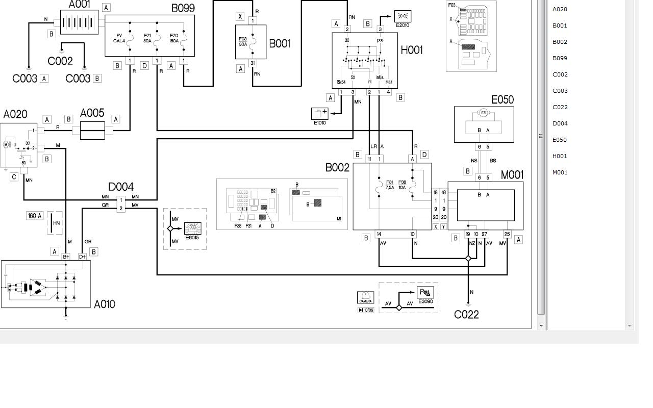

"The connection between connector B (D+) of the A010 alternator and pin 25 of connector A of the M001 Body Computer allows the performance of the alternator itself to be diagnosed (in the event of an insufficient recharging level).Once a fault has been discovered, the M001 Body Computer, through the CAN network, will light the "insufficient battery charge" warning light on the E050 instrument panel"
Therefore you need to check the D+ voltage. this is the same D+ that switches your fridge to 12v when on auto and engine running and split charging. Do these work when the battery lamp is on?

@rayc thank you for the comprehensive reply and diagram.
I didn’t check the fridge on 12v - I will when next with it.
You say in the event of insufficient charge level but to add to my confusion the alternator is charging…..
It wasn't me saying it, I was quoting the explanation in the document. The D+ output of the alternator inputs into the body computer which 'interprets' it and switches the lamp on and off in accordance with some, to me, unknown criteria..It is the B+ output from the alternator which charges the battery.
