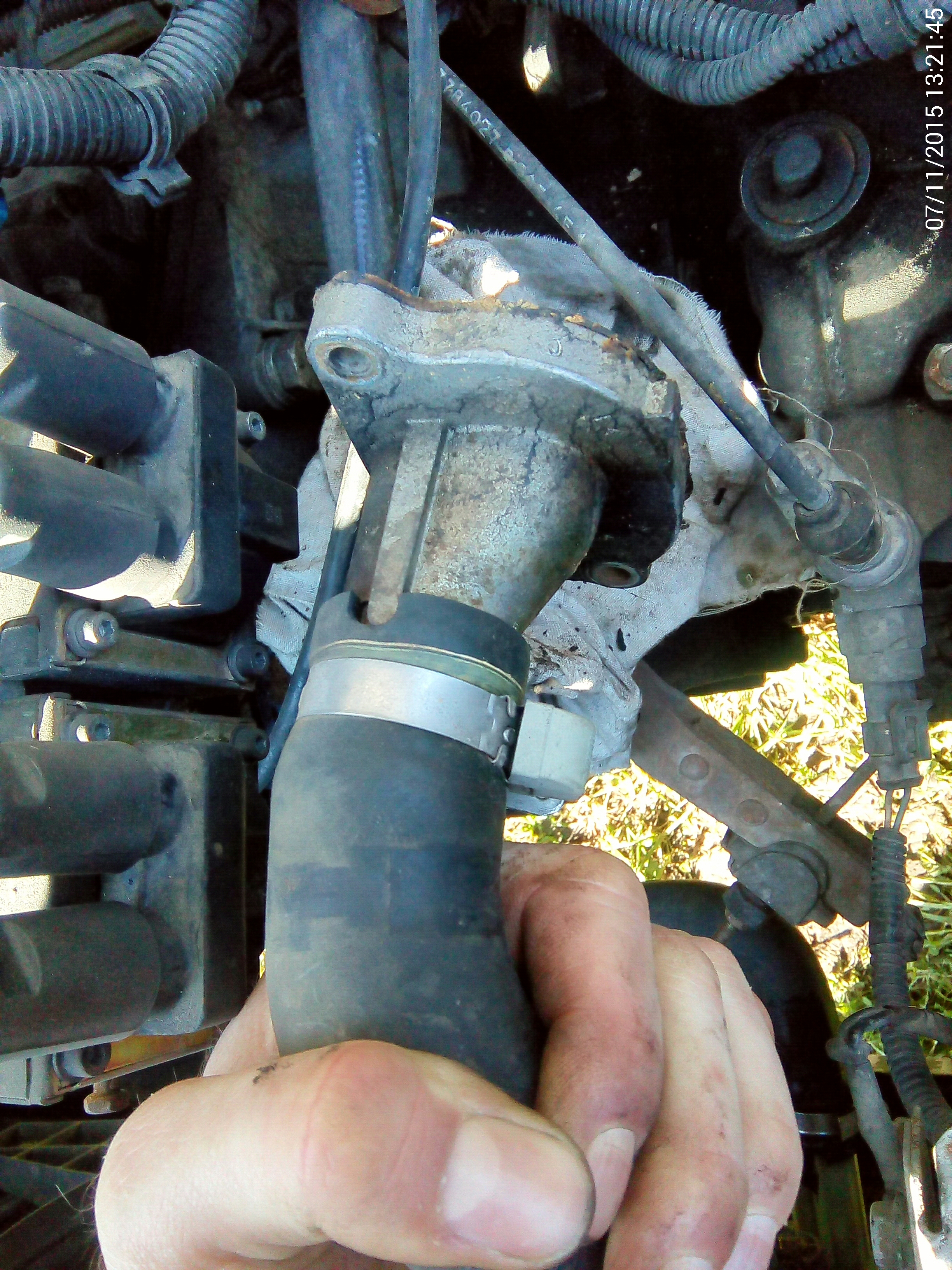

while changing thermostat also found out water pump was leaking, that explains minimal coolant loss over few months
original factory fitted thermostat 20 years ago? cant believe it lasted this long if it is infact the first one

temp rising was due to bad thermostat which didnt open fully when temperature was high -tested thermostat in pan
coolant loss was due to water pump leaking
fan didnt turn on due to bad relays, dunno which one is for fan but i replaced both of them (pic above) and fan now works normally
Well Done! Always difficult when more than one problem; also watch out for a leak from the metal pipe that goes from the water pump to the rubber hose. This corrodes at the back where you cannot see it.......
