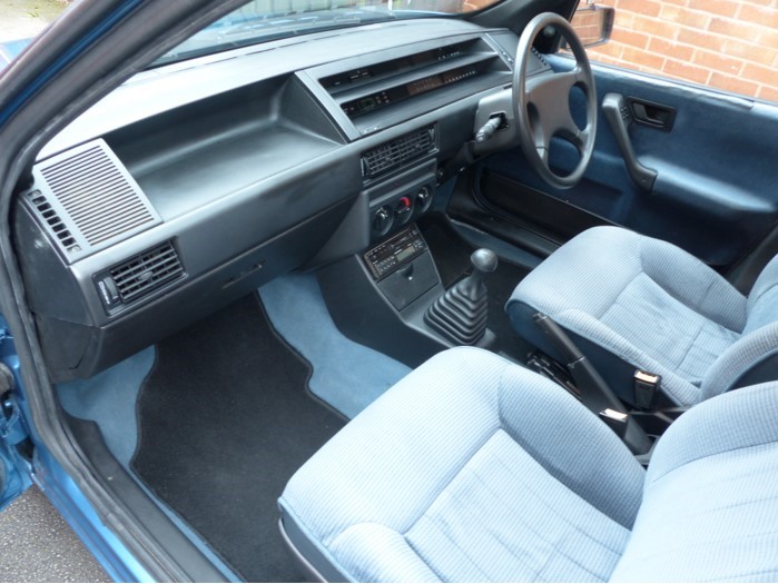

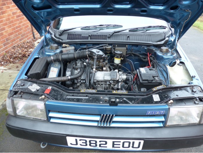

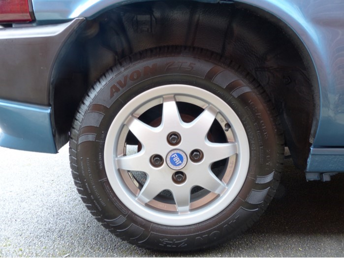

Some photos at last!

Thanks for the compliments Michael. Yes, very pleased with the result and runs as well as it looks. Respray cost me £1500 all in which I think is fair, given poor condition of original paintwork and large number of parking dings on panels. As I said earlier, not concourse standard but more than acceptable for a car in regular use.
