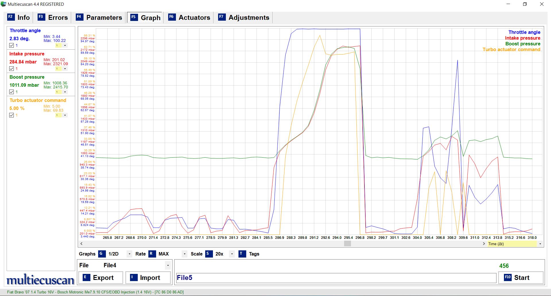

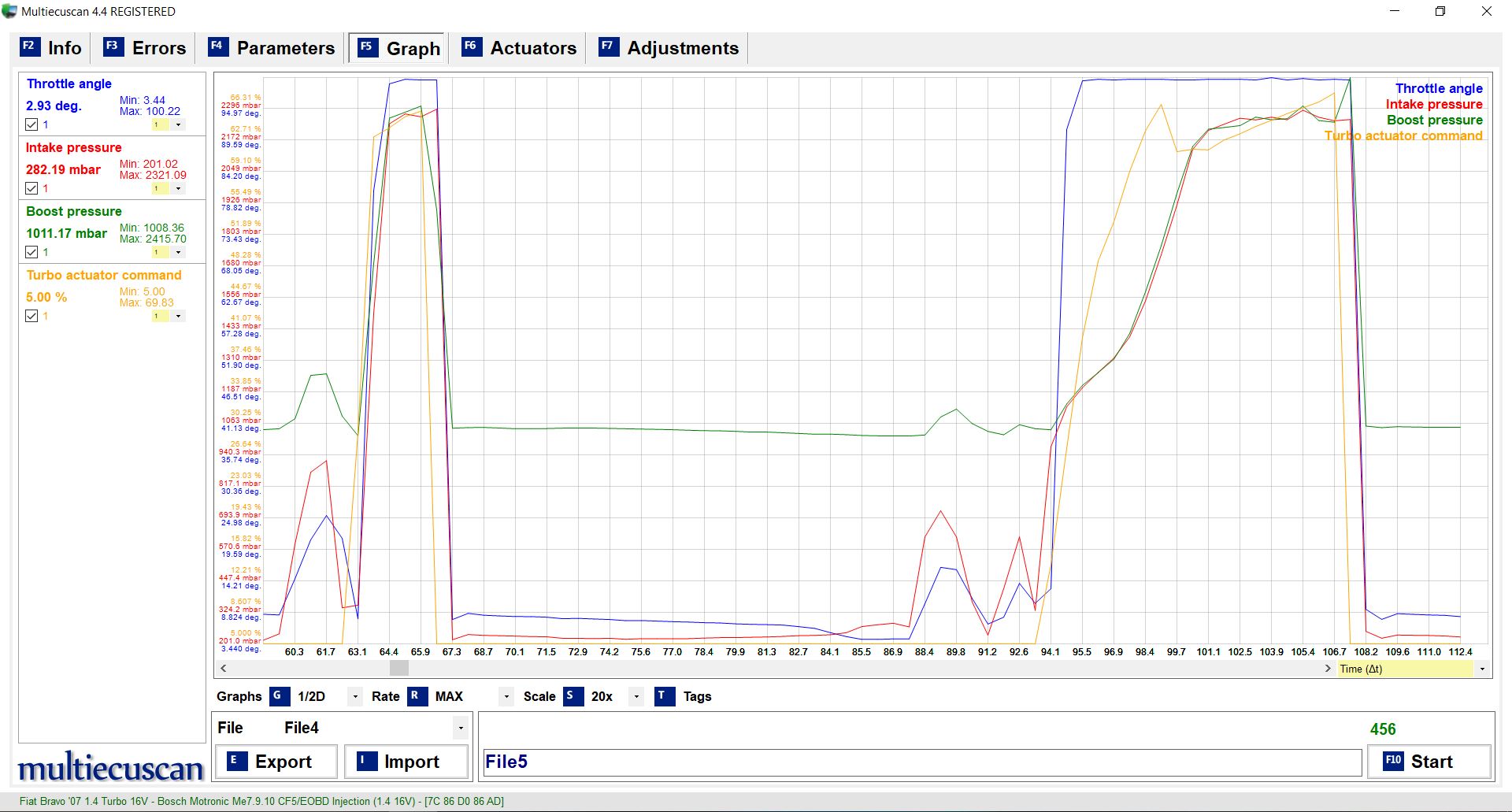

Good afternoon, I have attached a MES graph, I hope I got the right information for you aurick86?
attachment.php
attachment.php
attachment.php
I’m trying to understand the graphs a bit more, I’m looking at it and seeing no fluctuation? Can anyone confirm, my boost gauge was only showing peak 1.1bar but I’m seeing 1.3-1.4bar on the graphs aren’t I?
Yah... that is what i'm seeing. no fluctuation, no boost cut (can see that in throttle angle).
-Depending on the boost gauge sampling rate you might be loosing some data ...so the reason you're not seeing the same boost levels.
-The boost gauge might just not be very well calibrated.
Is the DeltaT in seconds? so 10-12 seconds to get full boost? that's not great, BUT depends at what rpm you start at. For example: if you start at 2000rpm, it will take much longer than if you start at 3000rpm.
-RPM and Vehicle Speed would help; So a few runs with what you have selected now, and a few with "Intake manifold pressure", "RPM" and "Vehicle speed".
I'd suspect the boost gauge/sensor: electrical connections (so worse when engine is bouncing about under load); or maybe it's just bad.
You could try fitting a restrictor in the hose to the sensor; the smaller hole will act like a capacitor on an electrical circuit.. it will smooth out the pressure to the sensor.
Was the gauge acting up while you were taking these graphs?
