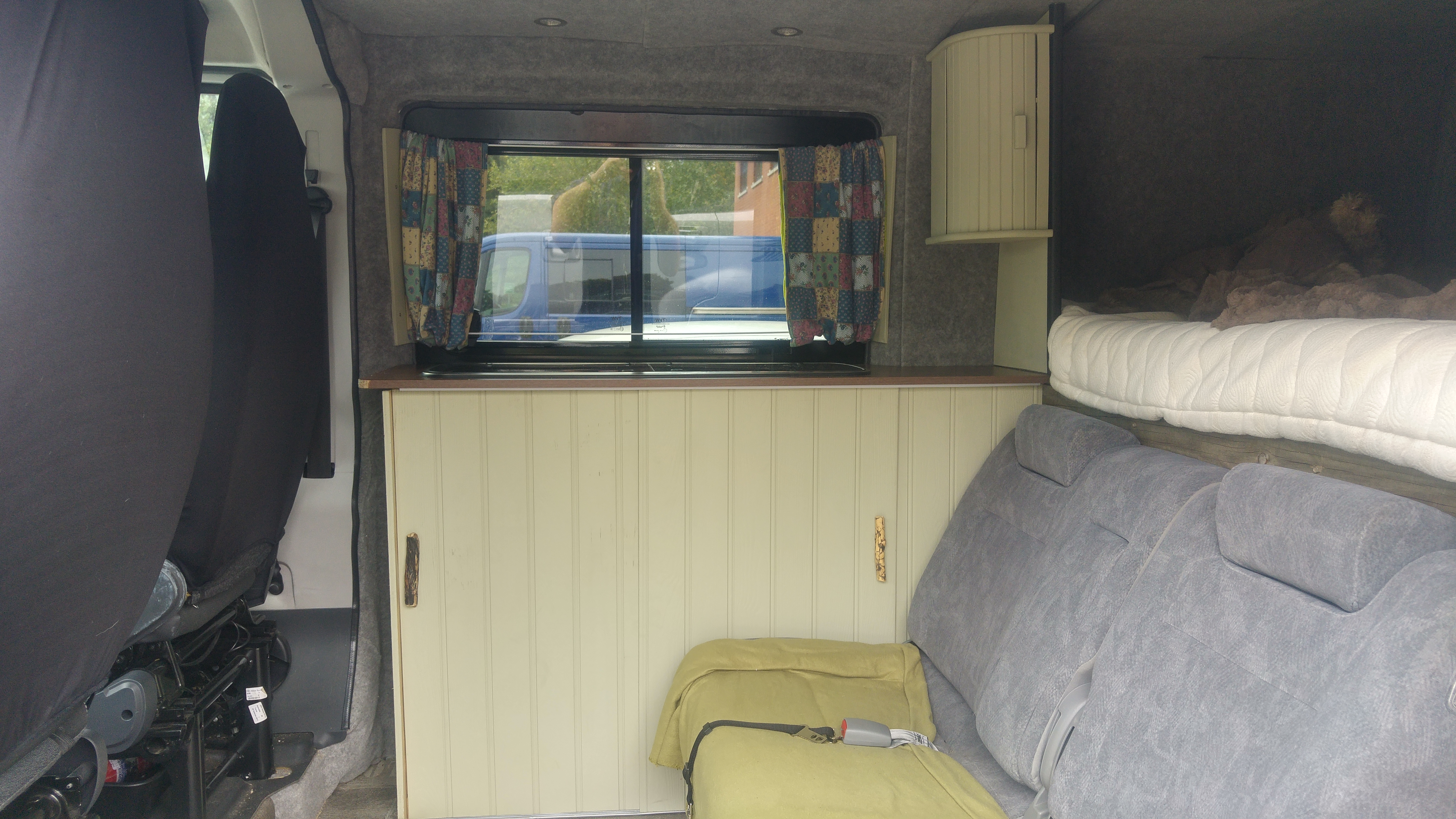

I converted our 2011 SWB into a campervan, never looked back. A summer of hard work but it paid off. Good luck with your conversion.
A couple of photos...
I got the swivel plates from Kiravans.co.uk, the single passenger seat from an eBay outlet.
