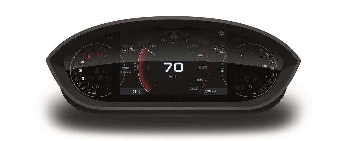

I have a motorhome based on a Fiat Ducato (2021 or 2022 - not quite sure which). It's got the Partial LCD instrument pack, with the speedo dial labelled in KMH (picture below). I need to get the speedo dial labelled in MPH, to register the van when I bring it back into the UK, in a few months time. I can see the following options . . . .
1. Buy a Partial LCD cluster (with speedo labelled in MPH), from either a breaker or a main dealer. Does anyone know the part numbers of the Partial LCD instrument packs, labelled in MPH? Any thoughts on the best UK breaker for Ducatos?
2. Get a Full LCD cluster, and change the labels in software settings. Does anyone know if the Full LCD is a direct replacement for the Partial LCD (physical size, electronic connectors, and software)? If so, do you know the part number of the Full LCD version?
3. Open the existing (Partial LCD) cluster and fit an MPH-labelled speedo dial. Unfortunately, the big supplier of replacement dials - Lockwoods - doesn't do one of these. Does anyone know of another supplier of MPH labelled dials? And, it is possible to open up the cluster and replace the speedo dial?
Any other ideas most welcome :)
It has an Auto gearbox (if that makes a difference). VIN = ZFA25000002X144NN
Thanks very much in advance
Nod
Here is the PARTIAL LCD instrument cluster (which I currently have - just need to switch the labelling of the speedo dial to MPH) . .
And here is the FULL LCD version

So far it looks as if the best way is just to take out the kmh partial LCD and replace it directly with an mph partial LCD, via a Fiat main dealer.
To get to that point, I have tried dozens of breaker's yards (I guess the mph partial LCD unit will turn up eventually, but it's only been on the road for a couple of years). I've also tried Lockwood's (who specialise in printing new Speedo dials), who don't currently have that dial tooled up, but who *might* be able to do it (I don't have time to take that chance).
I hope that helps and best of luck.
I'll post the part numbers here, when I get them. The Fiat dealer is, understandably, reluctant to tell me the part number, as that's what all the breakers use.
New cluster is about £500. Which is a lot. What I'm more annoyed about is the waste. This is a 50p change that ends up costing £500 and I have a spare instrument cluster (kmh) stacked in my garage . ..
