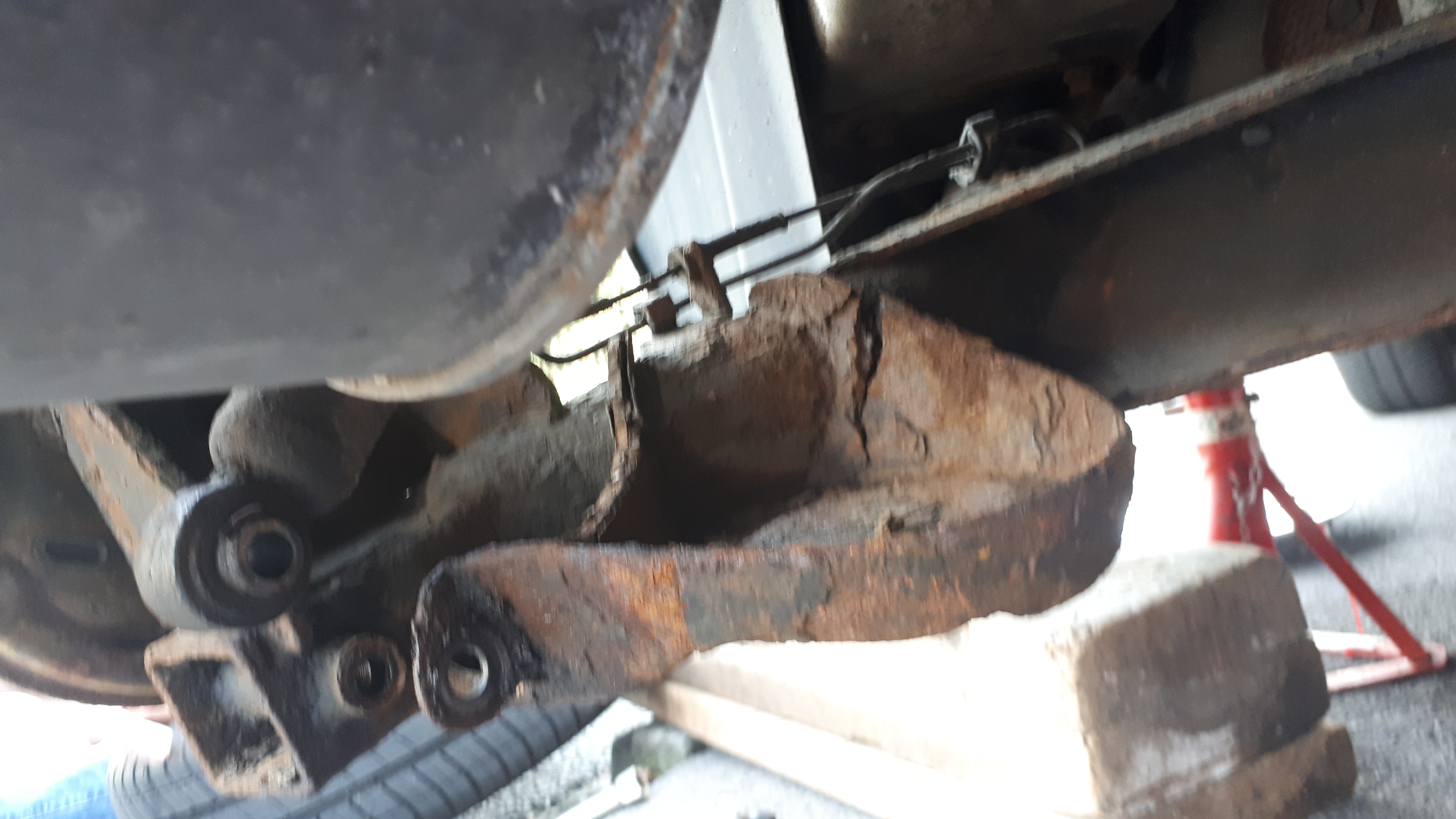

Whilst on check the rear beam suspension spring cups lower, ours had almost cracked off at this age there will be many age related issues if you want to keep the car for some time then it could be quite a few jobs but once done you're good for probably 6 more years, this was our car

regarding the rear cups, mines still good but it’s on the list to get rid of the flaky coating, Bilt Hamber rust converter then I’ll spray dinnitrol 4941 and that should be good for years.
