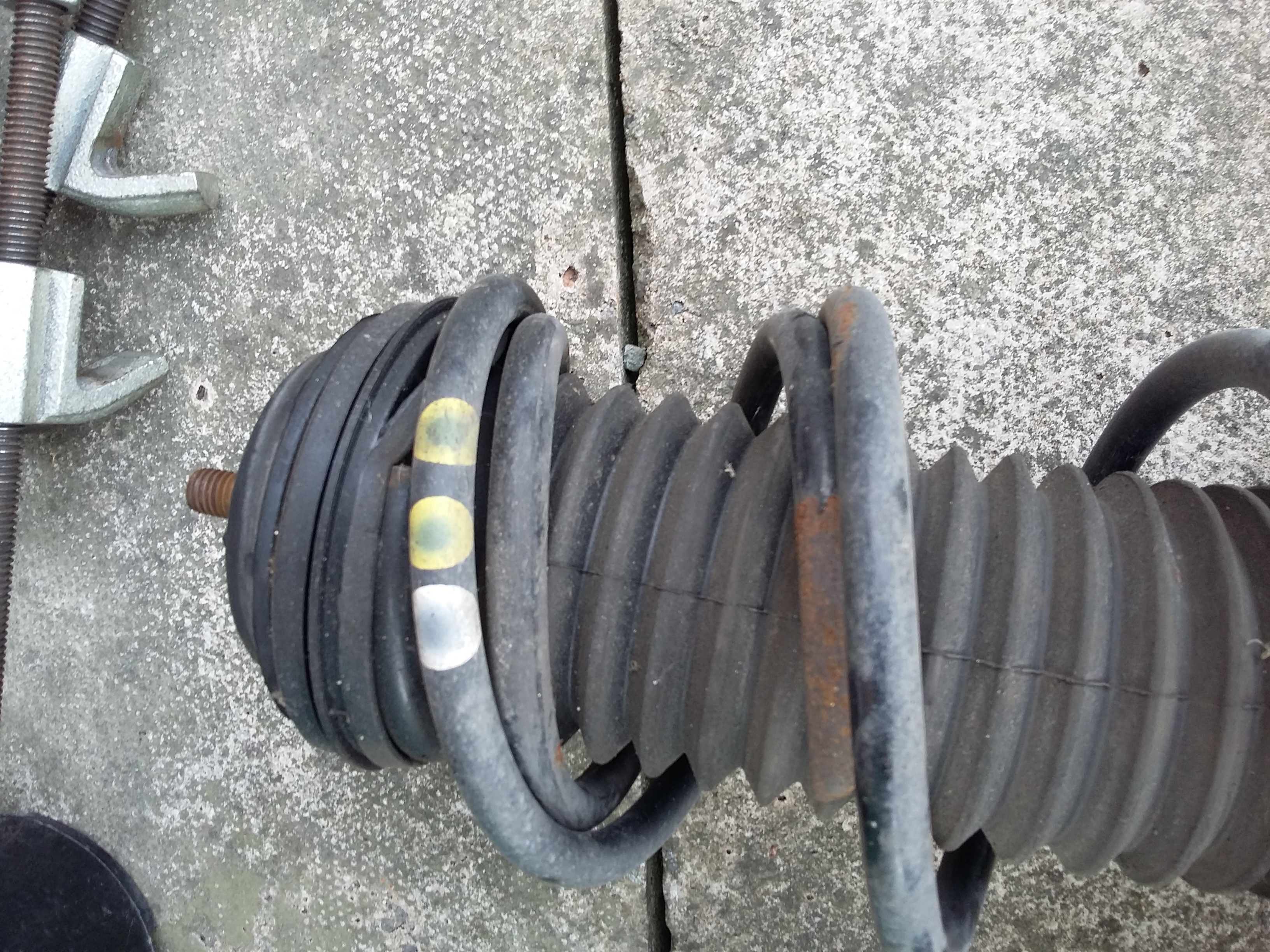

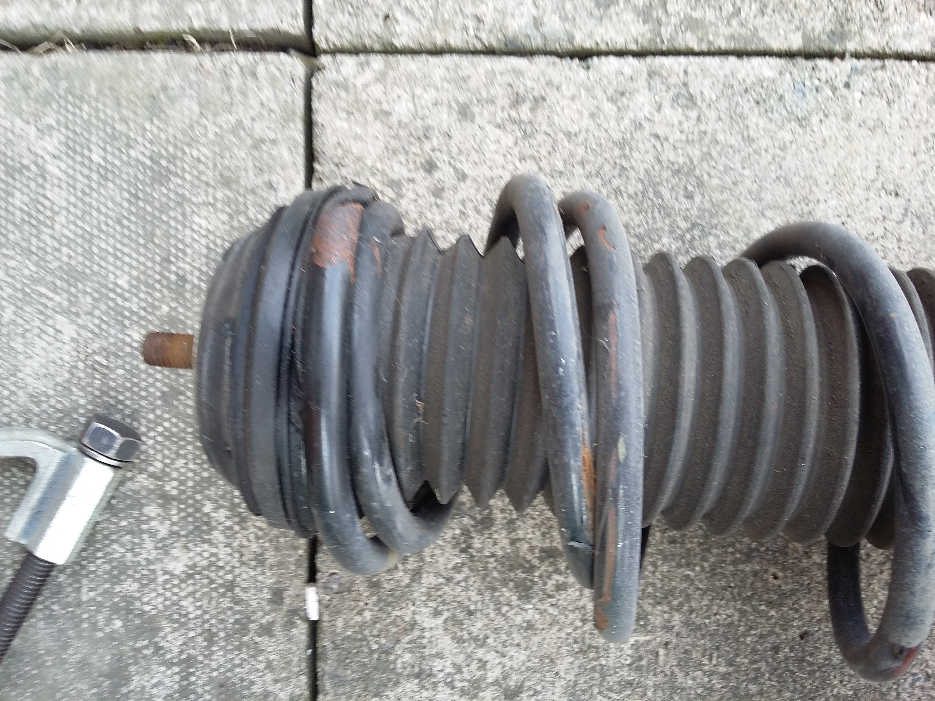

Tip :
Carefully put your hand turned sideways
Between the top of the tyre..and the cars bodywork
I got 4 fingers tall one side
Only 3 fingers gap the other

Tip :
Did this, thank you.
The left side was a good inch or 2 lower than the right
