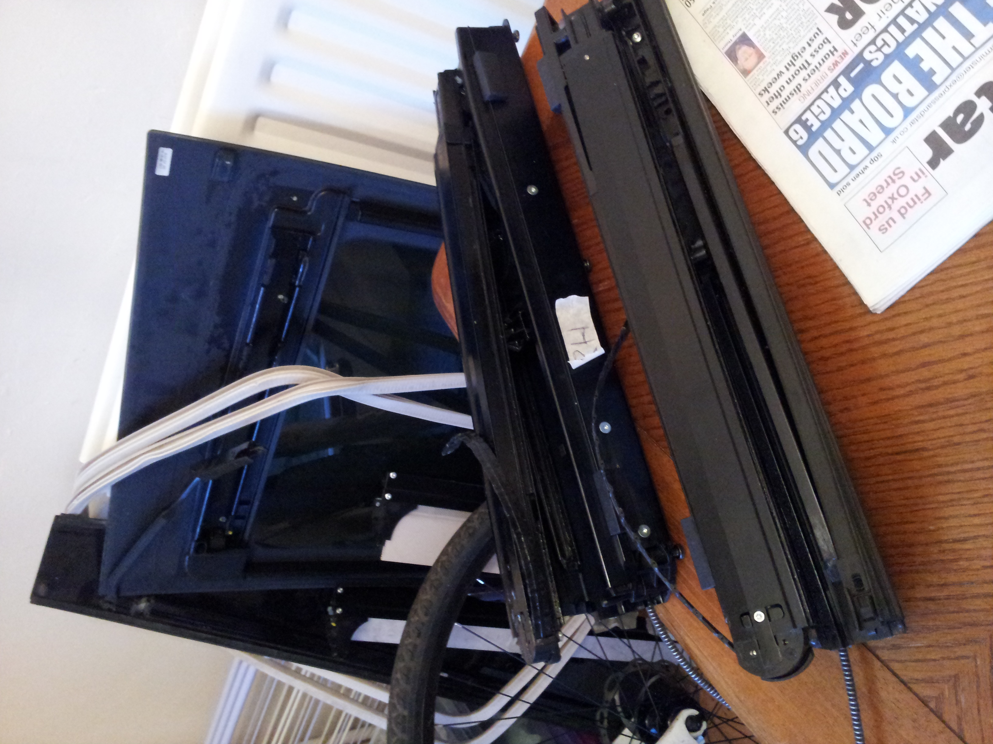

So, thought I'd share my Easter project story. Started off with a very lucky bargain I got from a nearby breakers, which looks as follows:

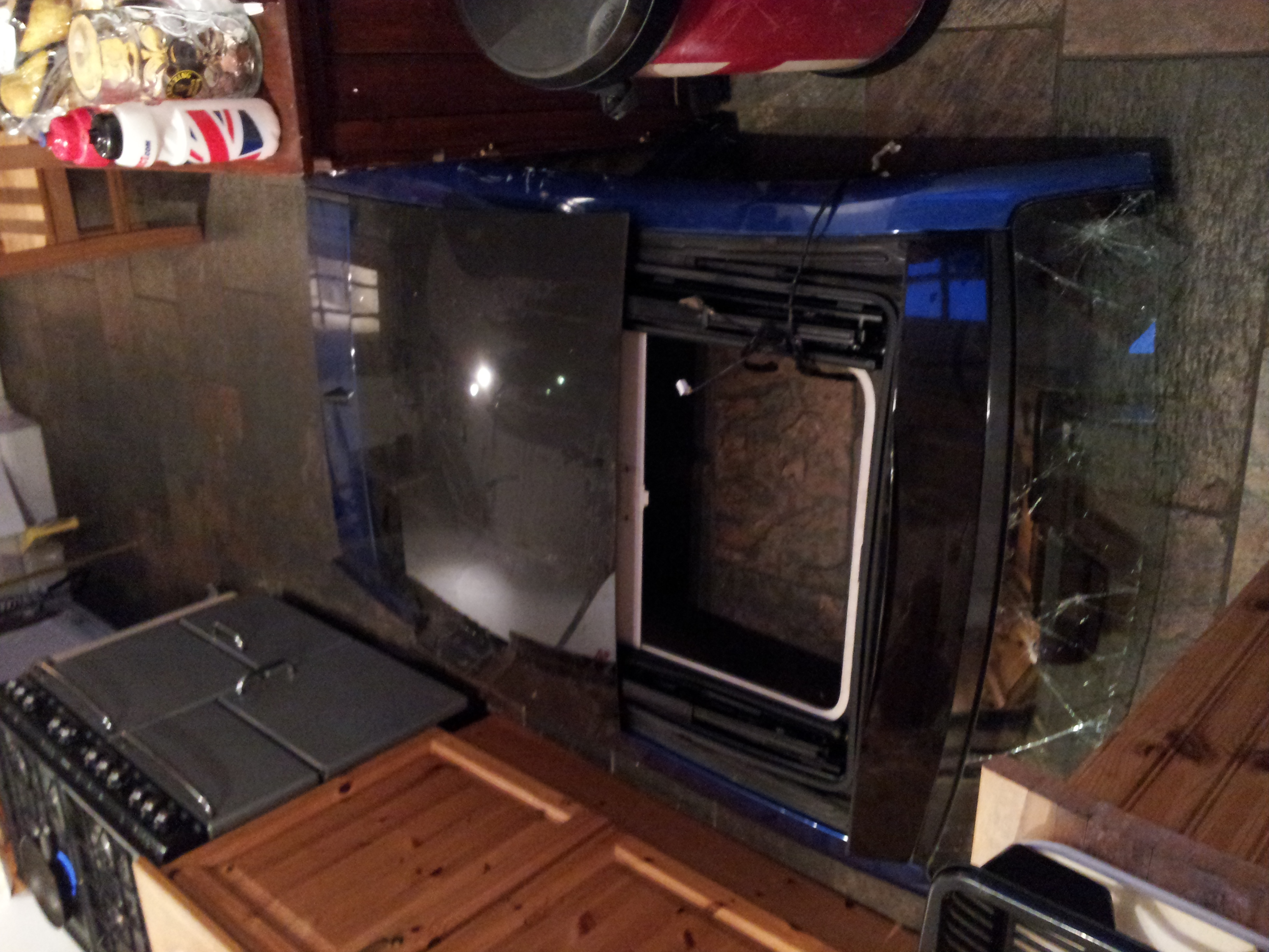

I couldn't believe my luck. So, with help from the Fiat elearn manual, I dissected the new roof, which gave me good practise for when butchering my own car.
Once the vessels were out, I had to wait for a good clear day to take my car apart. Over the course of two full days, I had the whole interior apart, and saw exactly what had broken.
The vessels have a secondary rubber strip that extends, giving the roof the extra opening. You can just about see this strip in the middle of the photo. This strap seems hardly more durable than a watch strap, and when I took the glass roof off my own car, these rubber straps just fell out! It scared me that I'd been driving round for a year with my whole roof pretty much balancing on these broken straps! One had obviously got stuck; I presume some grit had made its way in there. Then, the other not able to take the force.
Since I could clearly see the difference between my new and old vessels, I popped the new ones in, reconnected the motor/cables (plus muchos grease), and after a recalibrate my roof was as good as new. Never have I felt such relief! Then, after another hour/two putting the interior back together, a cold beer. I regret not taking photos as I went along, but once I started this job I just wanted to get on with it. Had I taken photos, I would have made a proper guide of this.
So, keep an eye out for scrappies. For a job Fiat do for £247 EACH vessel, plus labour (I should imagine pushing £700), I managed to do for less than £100 and a few scraped knuckles. Satisfaction!
