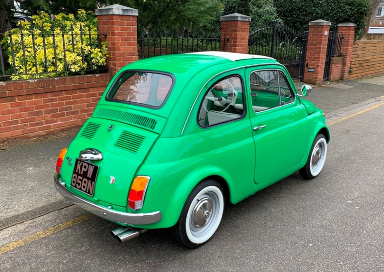

Thought about white sunroof, couple that with white wall tyres and looks great, but I would say that . .
