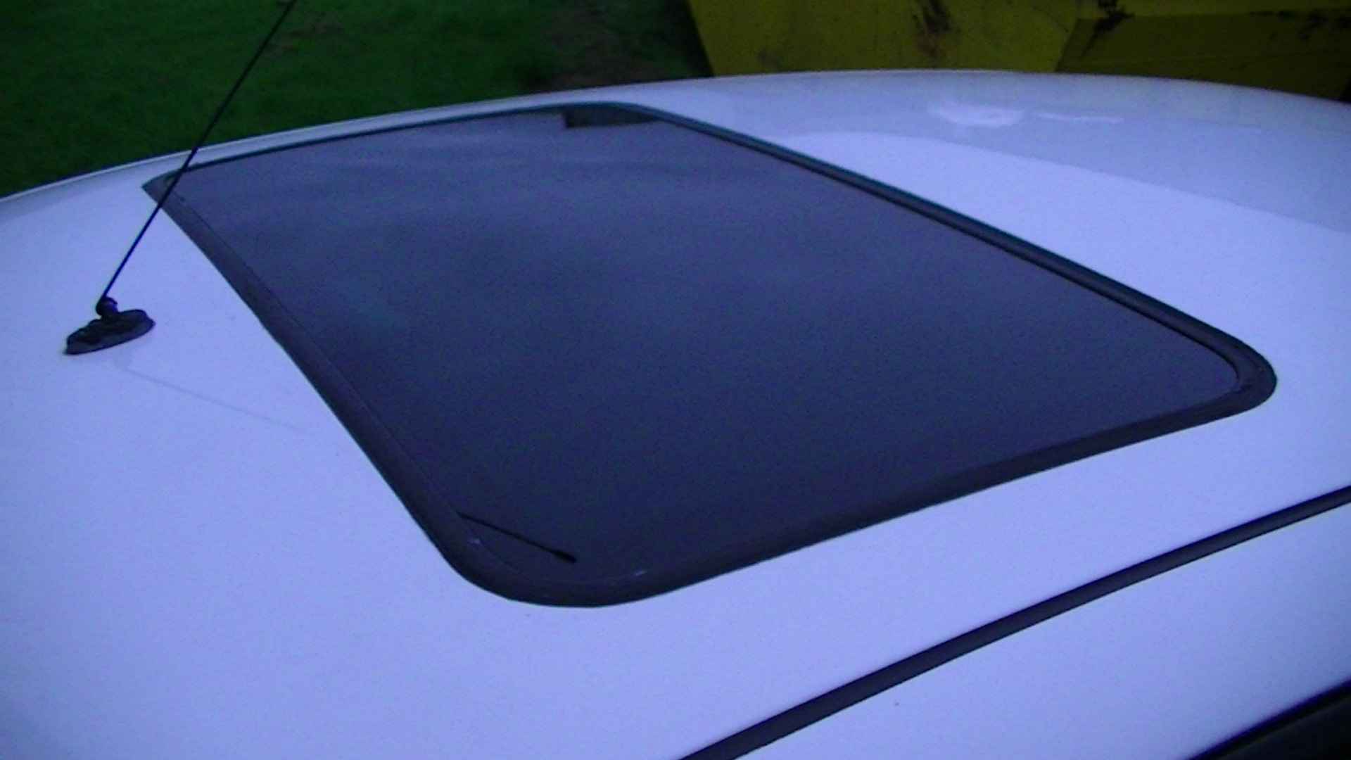

I did mine using black perminantly flexible silicone sealant from a motorfactors, I put masking tape around the metalwork. Opened the sunroof all the way, put as much round the metal as i could then closed the sunroof and filled the rest from above. You will be fine just doing it from above since yours is jammed.
I would not change my decission to seal the sunroof up really happy with it, and it doesnt look a mess..
Looks like a grand tidy job alright.
did you lift the seal on the glass and seal under it so stop any water weeping in?

Ok, I got around to doing this job this evening with the mechanic ( a very nice guy btw)
We managed to open the sunroof by the easy way of removing the the screws and ripping it out :D
A shed load of Tec7 and masking tape later and now all I have to do is wait till tomorrow to see if the job is done. Im going to pour a few buckets of water over it and hope there's no flood inside :yuck:
I'll stick up a few pics when I have it tidied up.

Got the job done. No Leaks so far anyway and we've had some crappy weather since.
I made sure the drain holes were clear ahen we had the roof off, they were blocked solid.
I left the tape on for a day and used some degreaser from work to disolve it off, I had to use duct tape on day one so the roof was covered in residue anyway so it sidnt really matter.
One thing I would say to anyone else doing the job is to tape a sheet or similar to the roof coz having an unnoticed blob of black Tec7 on your elbow when working on a white car can be nasty :eek:
