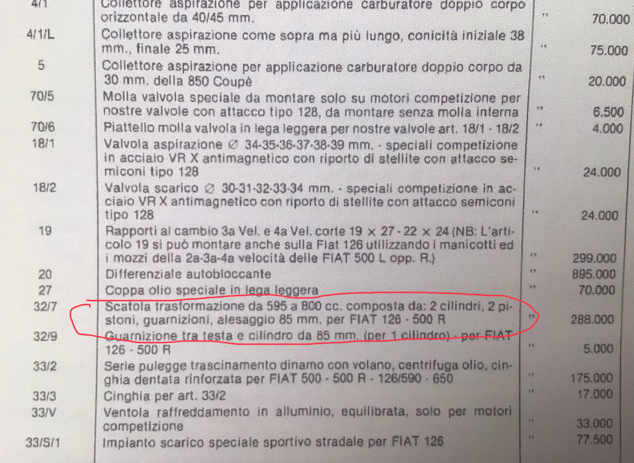

First pic shows the bits arriving home in the back of our car. Then the original Alquati badge that I came across in New Zealand then the Alquati price list which shows the 85mm kit which was available in 1977 and possibly earlier.
