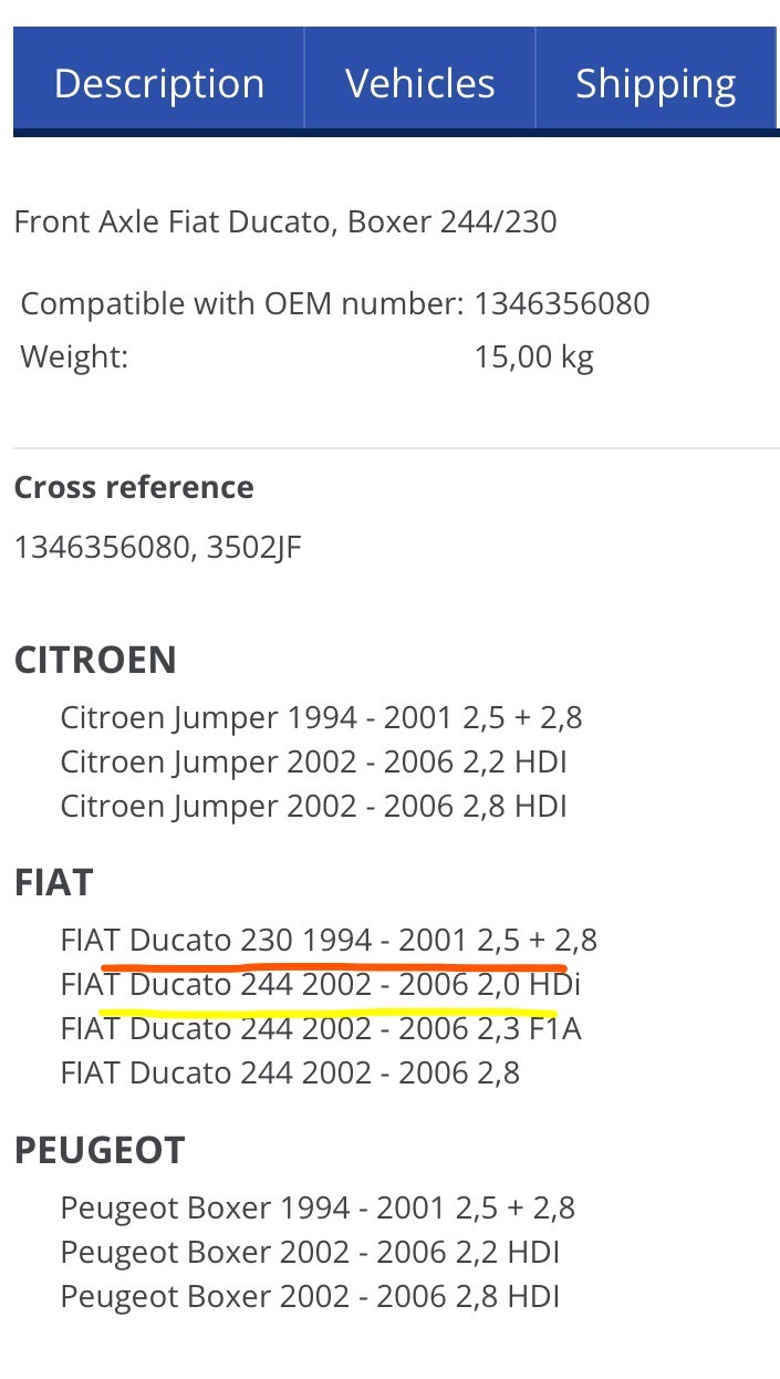

There’s a lot of interchangeability on the 1994-2000 Ducato, even later ones up until 2006 will fit the earlier ones. My 1996 2.5d subframe was rotten, turns out a 2006 2.0 HDi one was identical so just do a bit of research like I did and found an interchangeability reference chart 👍🏻
Ps I did a feature on this on March 9,2023 on this forum.

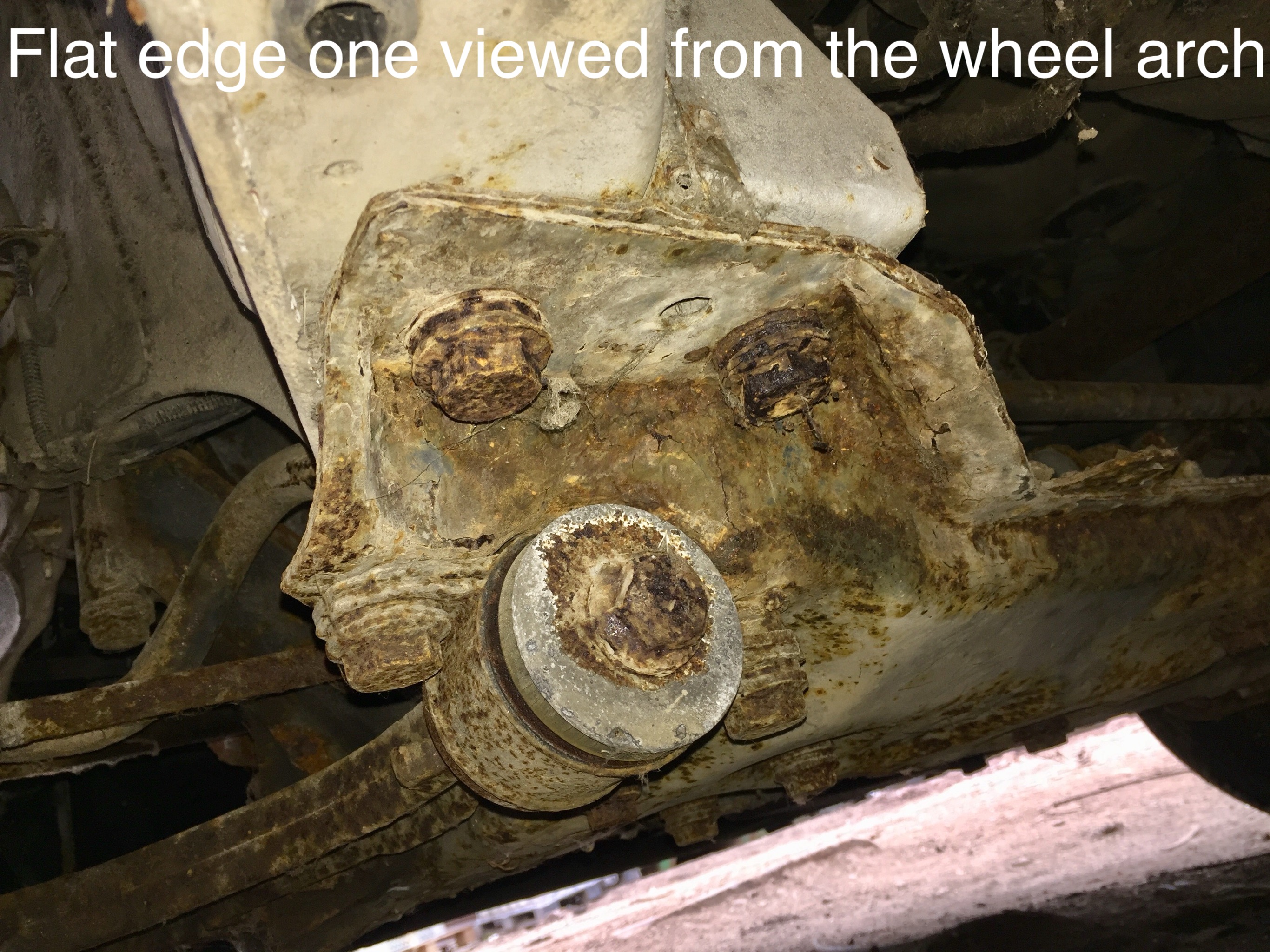

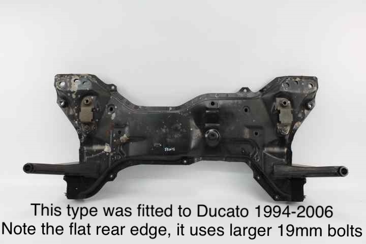

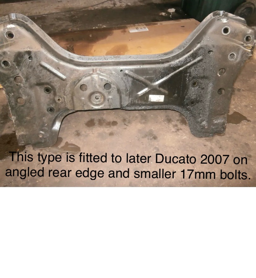

There’s two distinct subframe types, the early one that has the larger bolt fitting and a ‘flat’ rear edge and the later one which has the ‘angled’ rear edge and smaller bolts-the later type will not fit the earlier type and vice versa. A look underneath will quickly show what is fitted. Commercial vehicle scrapyards are the best bet for a replacement, normally the subframes are covered in oil and don’t rust much unlike our motorhomes that sit and hold damp 😬. Expect to pay £100-250 for a decent one.
