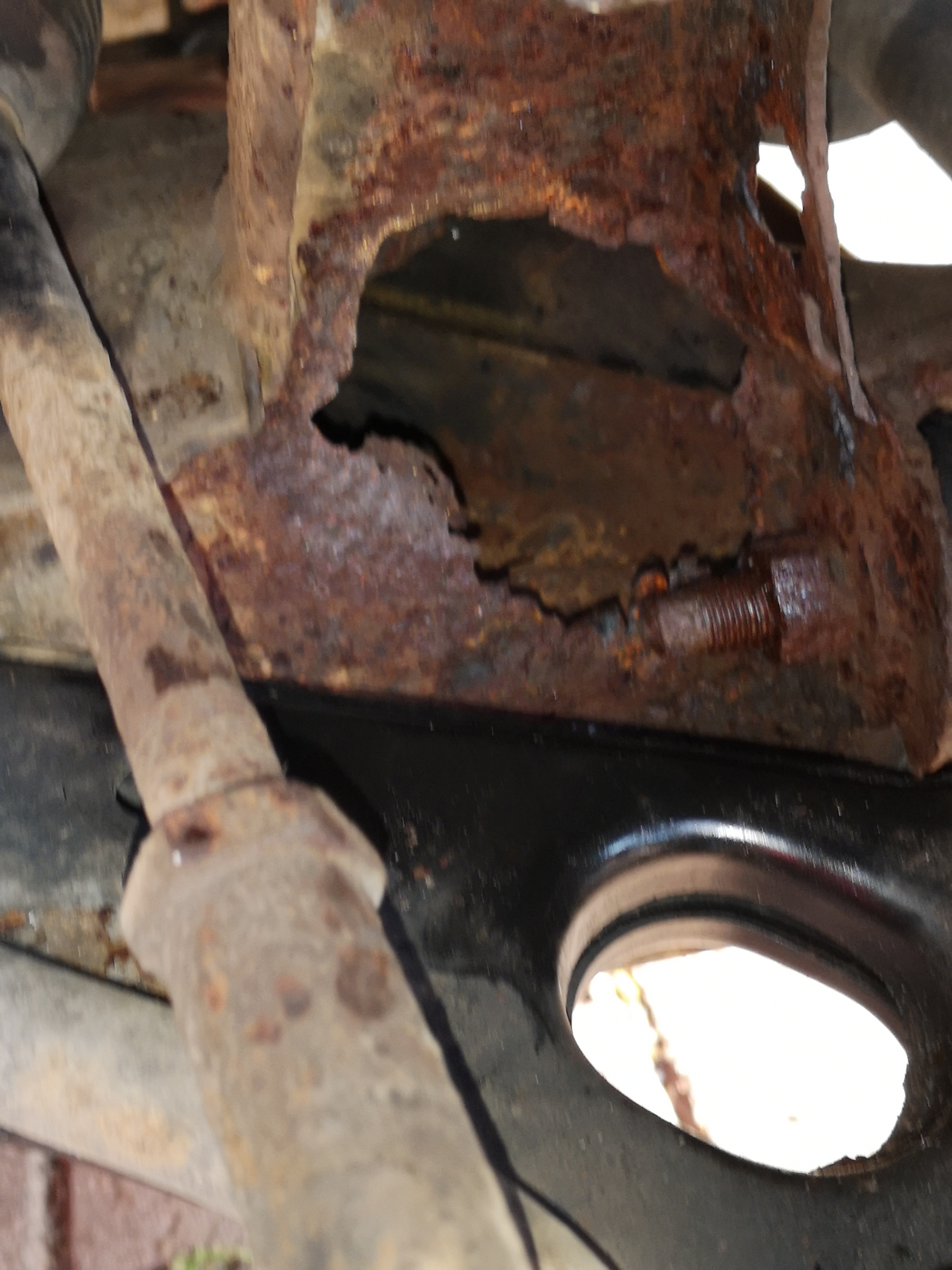

So after sorting the steering I decided to take a look at the noisey front brakes..simples BUT I then found a hole in the face of the subframe,behind the suspension leg.
Is it the subframe one piece???
As requested...I hope..

Ouch:-(. Strange how the rust damage looks looks to be only in one spot. Leaky brake line maybe?
In theory the subframe is one piece that can be replaced but in practice I wouldn't know how you'd tackle this since the car is resting on the subframe.
Or possibly a water trap..
all the old tipo..coupe..alfa line had parts thst just collected rainwater :(
Obviously less of an issue in regions bordering the mediterranean ;)
