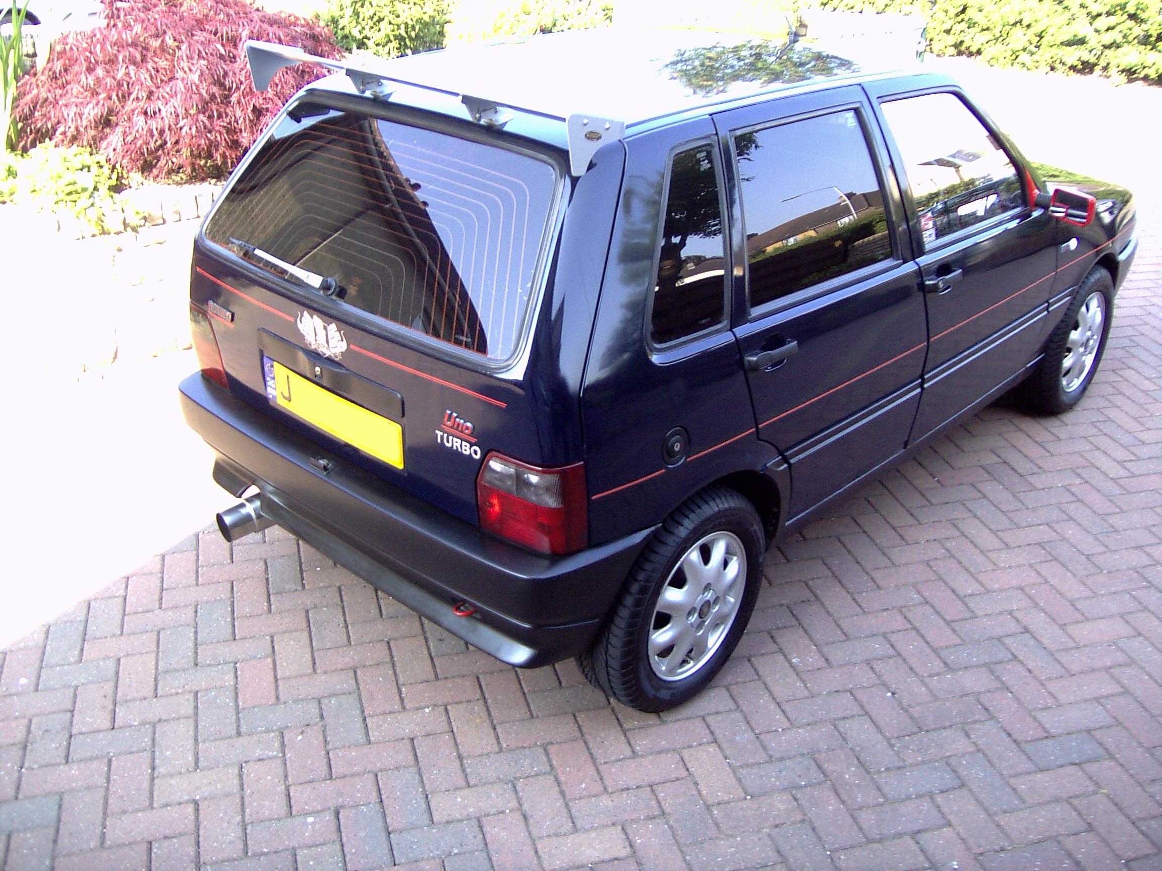

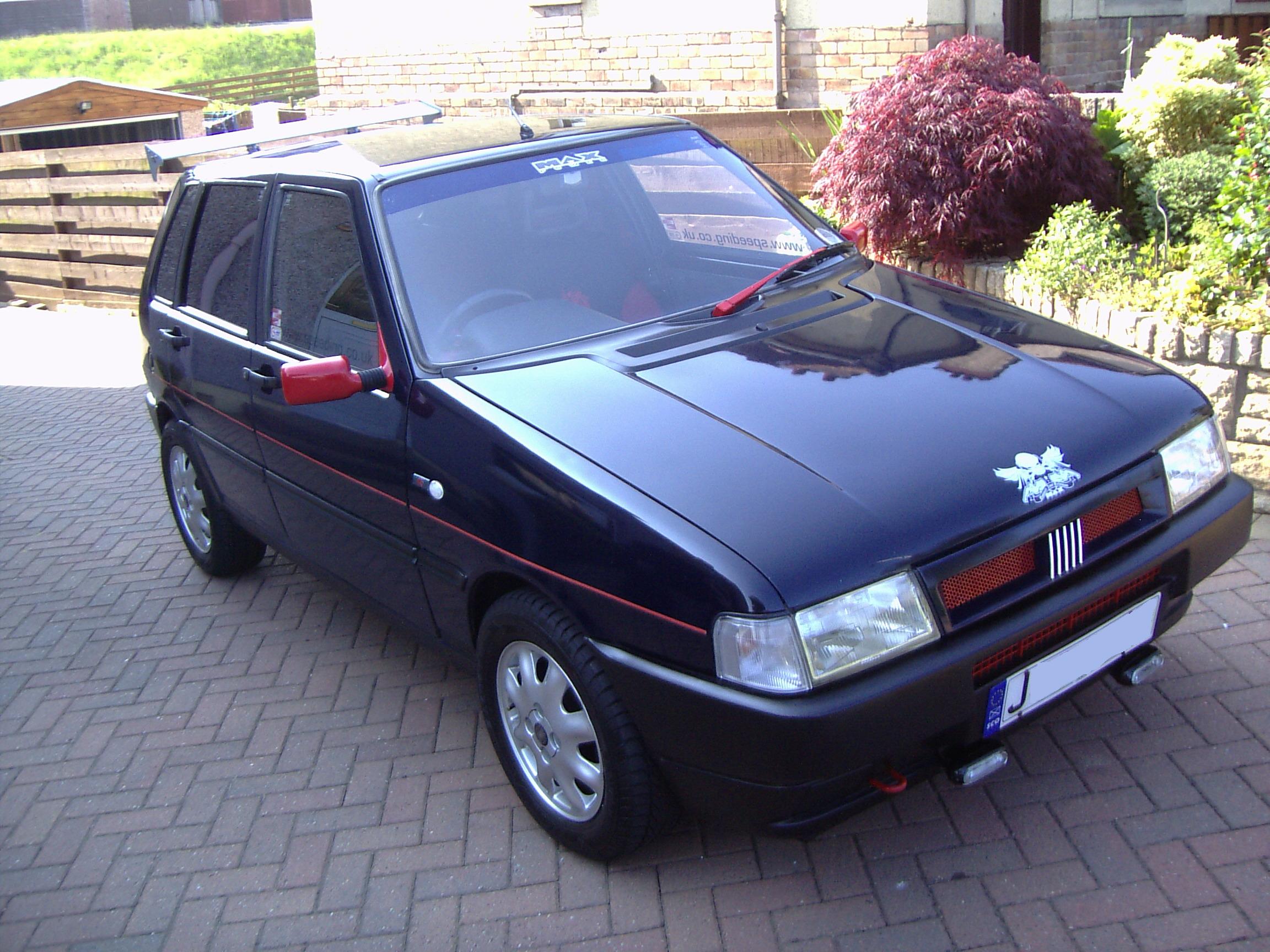

Hi all just wanting some help with what else i can do with my uno done some bits but get a bit limited with getting stuff abroud shiping cost's a bit throu the roof (n) ??

right.
1. loose the spoiler. its horendous. Get a lip.. not an ironing board!
2. lower it! looks pretty high imo
3. Get some better alloys. there are plenty around that will fit.
4. smooth out the fiat badge at the front so the grill is fully open.
5. fit turbo skirts and arches.. will looks loads nicer!
6. bodycolour the bumpers
7. Remove all of the stickers
8. debadge the boot.
and thats about it
plus:
colour code mirrors (ie swap those nice red ones for a pair of black ones i have!)
colour code wiper arm
turbo bumper - faired in foggies
re-hang exhaust to fit more snuggly
niceeeeeeeeee(y)
btw are those vauxhall alloys? i do actually like the way they look on there!

Cheer's for your view and yes there vauxhall alloys think they look gid aswell and they say they wouldn't fit a fiat
