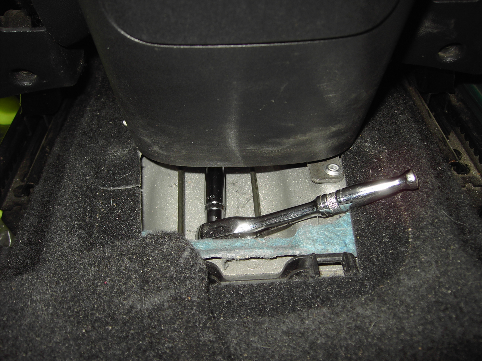

The garage may not have followed the correct procedure for adjusting the handbrake after replacing a calliper.
  1. With the handbrake off, loosen the cable adjuster nut 5 or 6 complete turns.
  2. With the engine running, pump the brake pedal vigorously about 25 times.
  3. Adjust the cable adjuster nut so the handbrake holds the car securely on 5 clicks of the handbrake lever ratchet.
  4. With both rear wheels off the ground and the handbrake off, check that the rear wheels spin freely.
  5. Test drive the car enough to get the rear brakes hot, then repeat step 4.
Handbrake cable adjuster is behind the center armrest.

Tidy, cheers Dave, will do that this weekend (y)
