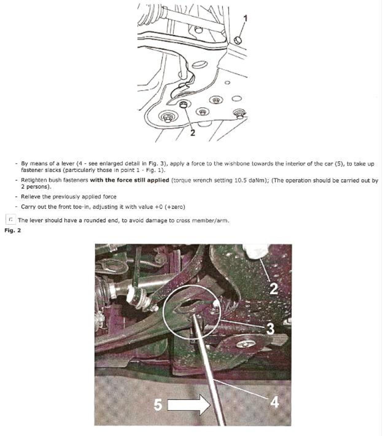

This is the service bulletin Fiat published about the problem.

I can't really see what the service bulletin procedure achieves.
By loosening the wishbone mounting bolts, then levering the wishbone outwards would just compress the rubber on one side of the bushes. Once the bolt is retightened, the rubber would revert back to it's original position.
The only situation I can think of where this would have any effect, is if the mounting bolt holes were manufactured too big for the bolts. I thought this could have been the reason that the wishbone and it's front mounting bolt were changed from 12mm to 14mm, but the service bulletin was issued in January 2003 whereas the the wishbone didn't change until August 2007.
