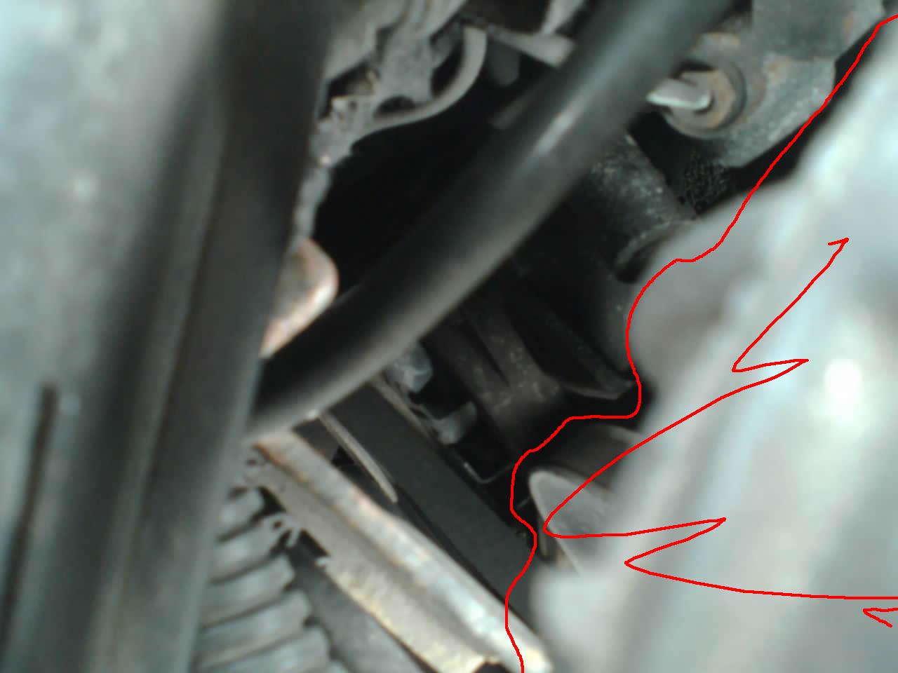

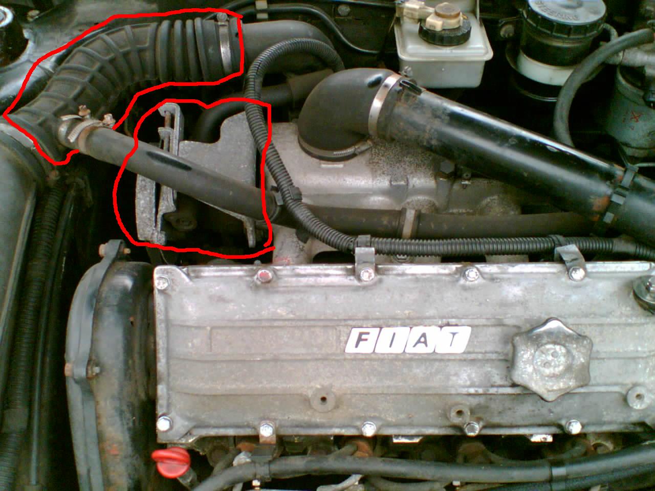

I'm glad I'm not the only one who has spent nearly a hour trying to remove the alternator through the bottom or side. The bulkhead, turbo and drive shaft all conspire to prevent it coming out... so I dove in from the top!
Removed all the bits in red (basically power steering pump and some brackets and pipes) and got it out that way. Once it was out I only changed the regulator/brushes but it was much easier to work on, made access to clean the armature with a fibre stick easier.

Hellcat said:
Very good news!, You should ask him if he would like you to recommend him to other Fiat owners.. so I dove in from the top!...Removed all the bits in red (basically power steering pump and some brackets and pipes) and got it out that way. Once it was out I only changed the regulator/brushes but it was much easier to work on,
That was how I did mine in the end, but what a so & so just to get to the alternator.
