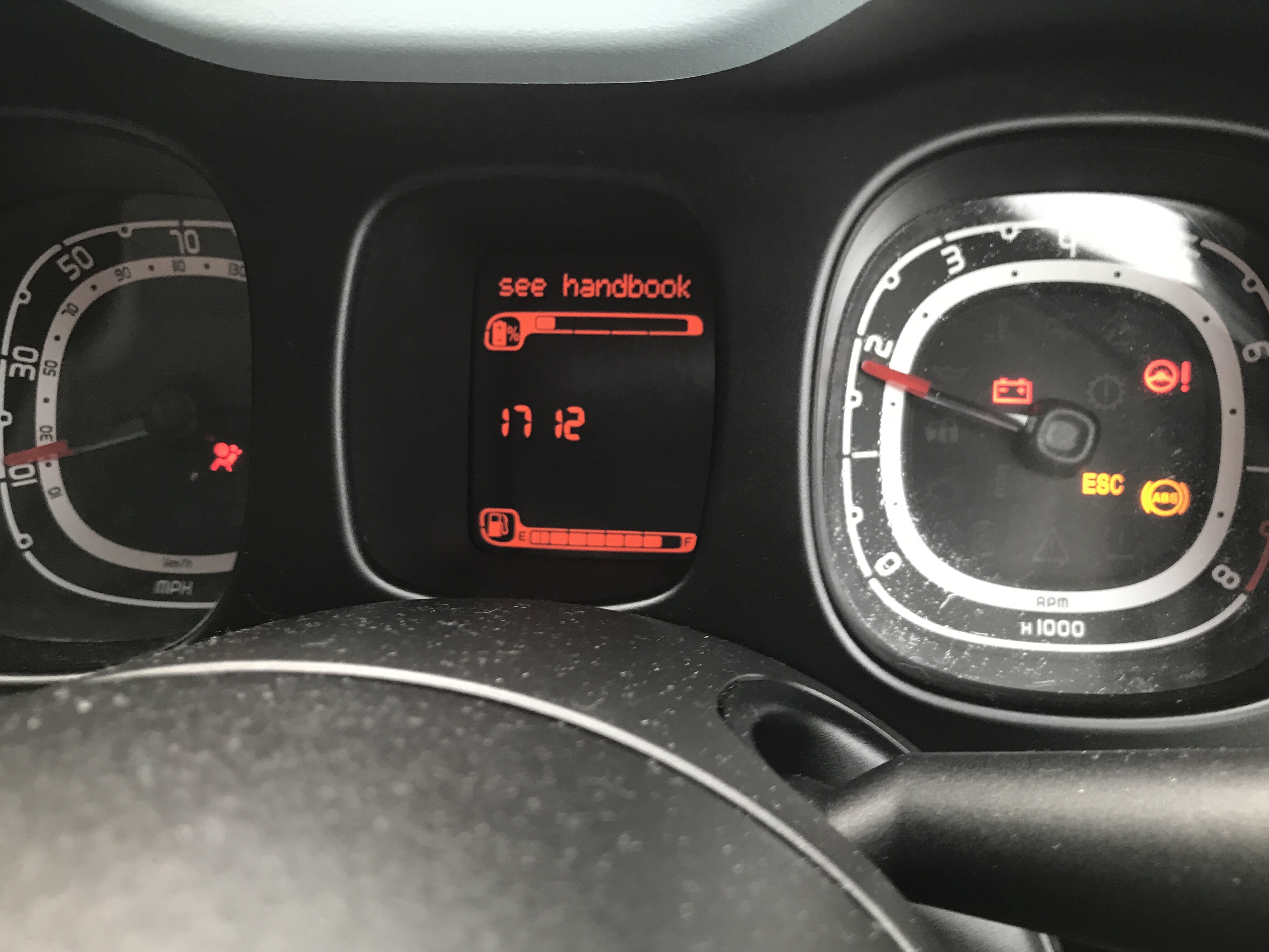

Halfway up the M6 on Friday afternoon, round about the junction with the M61 at Chorley; the power steering failed, this was shortly followed by a dashboard warning for battery, then ESC failure, then ABS, and then Airbags. At this point the car started to judder. I like to think that despite my optimistic idiocy of ignoring the other symptoms already described before this event, that I made up for it in managing to immediately traverse four lanes of busy traffic (two of them merging) to make it to the hard-shoulder, before the thing conked out.
Thereafter followed two hours on the hard-shoulder as the extended warranty had not been put through properly by the dealership, and then once this was resolved at the car recovered, the truth was revealed. The tensioner for the Aux-belt (I assume) has disintegrated, and been ingested by the belt, partially lifting the belt off the alternator. The car could not be repaired at the recovery depot, we spent the night in a Premier Inn in Preston, and returned North to Edinburgh by train yesterday.
The car will return by trailer in due course (or it can just not bother being returned as far as I'm concerned).
The outfit we bought it from in Fife assured us that it had been freshly serviced, despite it's low miles; and as an idiot I believed them. I thought; at this age and mileage, it'll be a couple of years before I need to worry about anything. How wrong I was!
