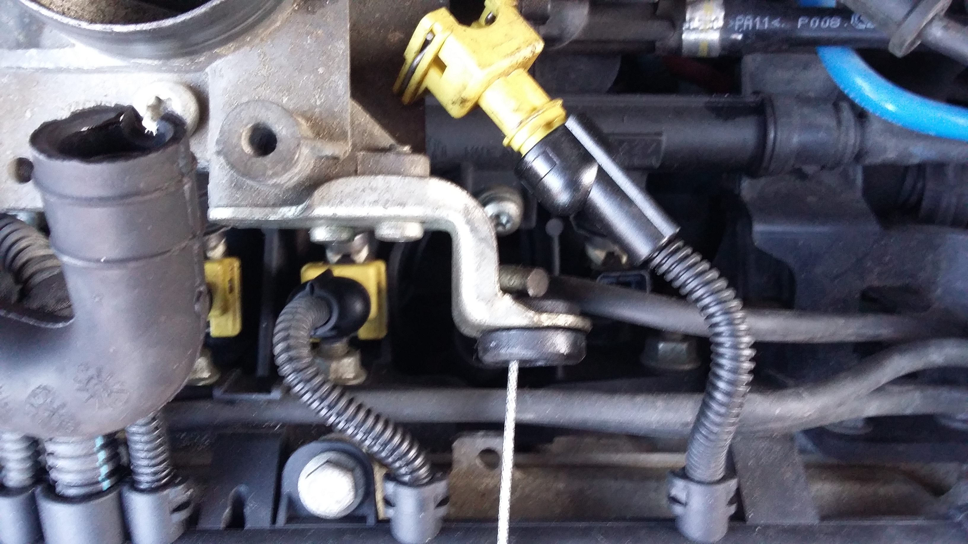

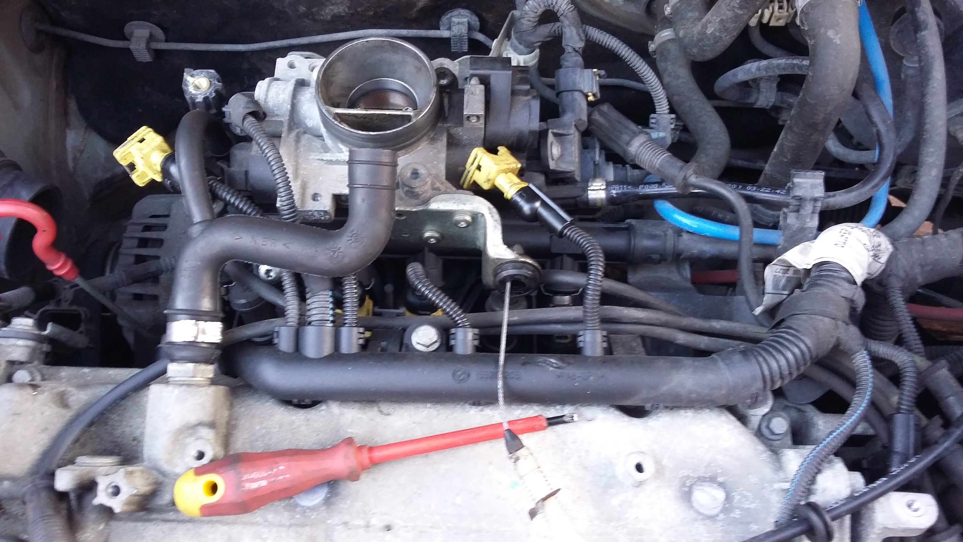

I would CAREFULLY, lift the bonnet , and see if there is any obviously damp / petrol smelling areas
as you stand at front of car , by headlights , the fuel area is BEHIND the engine top - fairly central in the car - there is often a
LIGHT BLUE hose to the left side of car - RHS as you look,
that's supplying the fuel to the engine - so 1st obvious place.
see where the BLUE hose plugs in,
BELOW it is the BLACK fuel rail,
if you look carefully there is a cast plastic "gutter" under the join.., this does capture a little spilt fuel when the joint fails / leaks.
at the REAR of the engine top there is a FUEL RAIL ,
that directs the fuel into the engines cylinders,
it's a BLACK plastic , with often a
RED cap at the LHS as you look
these are the 2 x most obvious common places,
