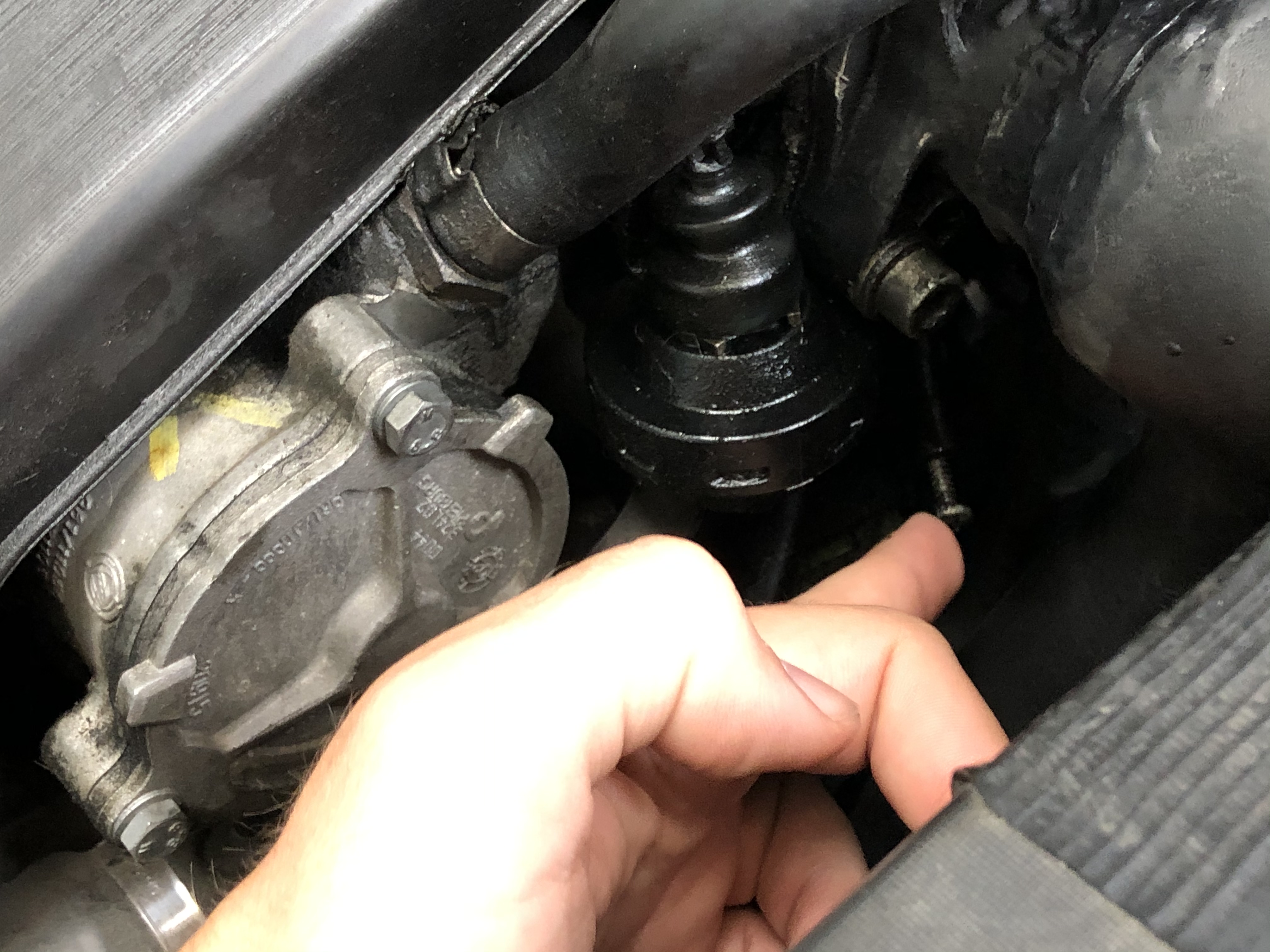

and why is this stroke into this black rubber on the photo ? what is it?

There should be one small rubber hose coming into that black valve next to your hand. I can't see much, but it looks like somebody put a screw in it for some reason.
Also you need to remove the EGR if you want to take a look at MAP sensor.
I couldn't get a socket there to remove it with EGR installed. If he's going to remove it anyway, it is just a reminder to do it when EGR is out.
