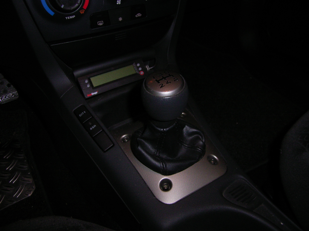

good god yellowstilo! that is rather creative! well done!
i hacked, chopped, burnt, mine till it came off piece by piece, then i used an angle grinder to take about 1.5" off the stick.
yours is soooooo short, it must be difficult to use? can you rest your arm on the armrest and still easily make gearchanges?
ooh and i loooove the surround, is it custom or nicked off an selespeed abarth?
hats off to you mate (y)
using the armrest was also a problem with the original lever - I only use it during long highway trips.....
Of course changing gears needs some more force now but I like the feeling of it....short and firm stroke !
the surround is from a selespeed Abarth and was modified to allow the full stroke of the lever in all directions.
I also shortened the lift-up mechanism, I chopped it just below the second rim and glued the part on top which slides into the gear knob.
The surround makes it look even shorter - the lever was only shortened aprox. 6,5 cm....
that looks mint, think you should shorten mine for mine?? how much you charge?? lol :D
im very impressed yellow stilo (y)
i like the surround as well, eyes immediatly drawin to it, also i like the (i presume) radar detector? put behind it, lol
yes, thank you, i'm also pleased with the looks of my shortened gear lever and surrounding !
The display behind it is a multifunctional gauge which shows all kind of OBD2 data like timing advance, engine vacuum,water temperature, rpm and lots of other info.
The backlight color is user definable and this gadget comes in handy in case of engine trouble - it is also possible to program commands like spark plug or injector tests or emergency start procedure (no need to use the accelerator-pedal method...)
look at www.scangauge.com for more info...
As I live in Holland it will be difficult to assist you shortening your levers but I can provide extra information if needed !
