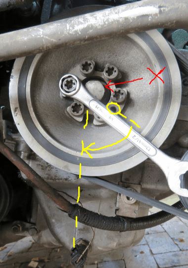

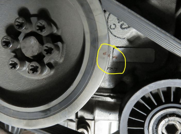

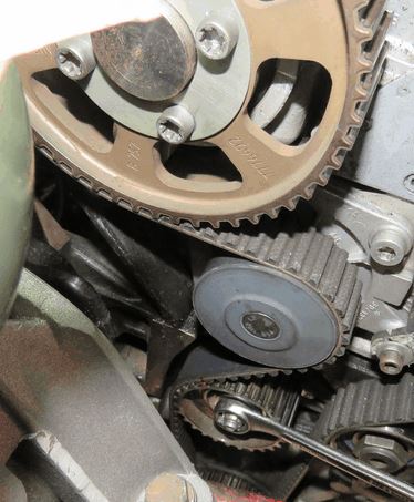

Turn engine to TDC and mark pulleys
1. Turn the engine clockwise to TDC
NB! Don't use the crankshaft bold to turn the motor (It is LH tread, you might loosen it!!)
I just use a 13 spanner over one of the Rife bolt and use the shoulder of the spanner as force area.

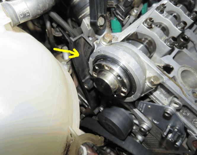

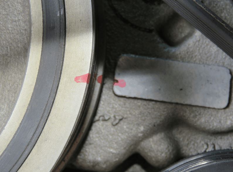

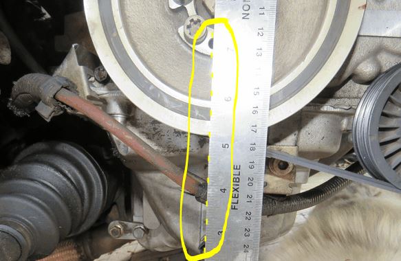

1a. Line up the hole in the pulley, now on the picture it is actually very easy the hole which also align with the Crank pulley in the back ground always face down to the centre of the bolt that hold the sump.
It also align with the LH straight line indent on the sump to the sensor, I tried to mark it in the pictures.
1b mark the pulley.

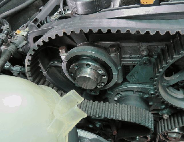

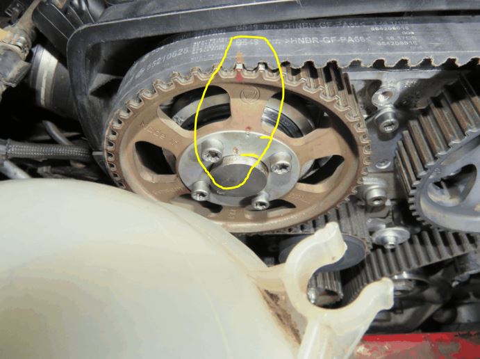

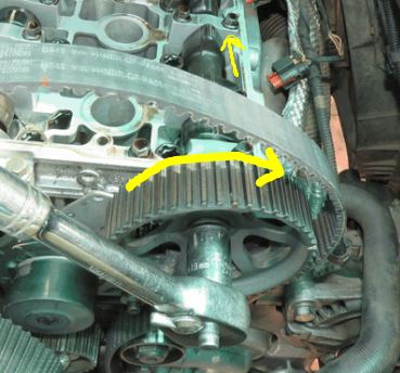

2. Mark the Inlet and Exhaust pulley's also the belt at those 2 points, it does not matter which teeth, I just take the 12 o clock position teeth.
3. Verify the tensioner is still 100% correct, it should be, in my case after the 2500 km since the rebuild I was glad to see it is.
4. Mark the Inlet pulley shaft / plate vs pulley position.

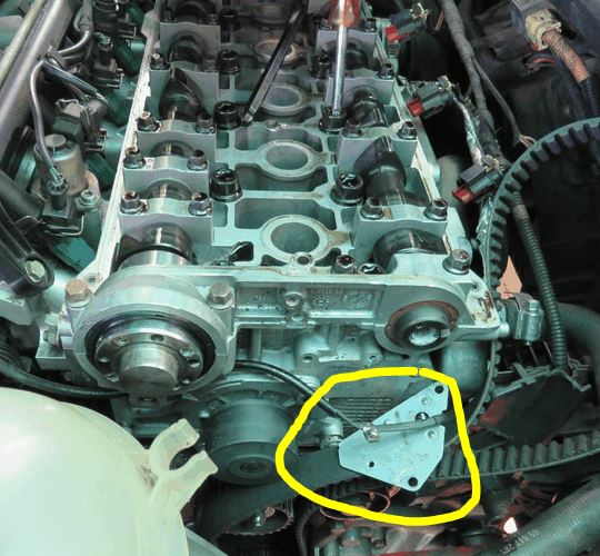

1. Loosen the tensioner.

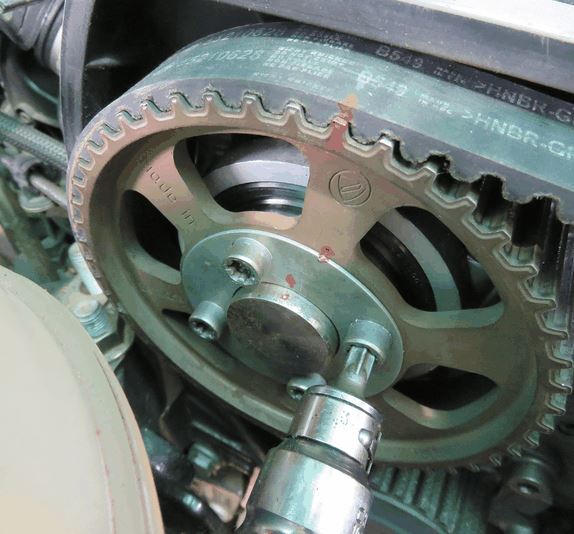

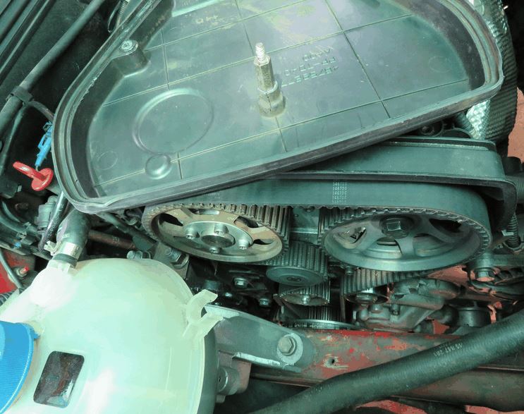

2. Remove 4x Ribe bolts on Inlet Pulley.
3. Remove Inlet Pulley.

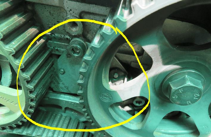

4. Remove LH plastic cover under Inlet Pulley.

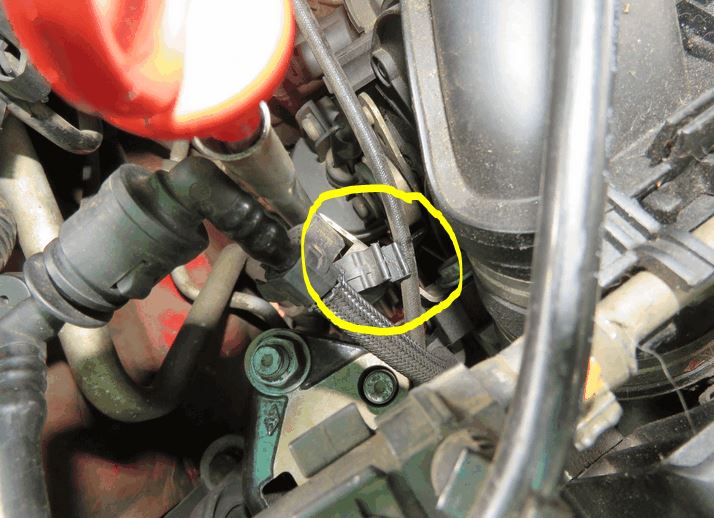

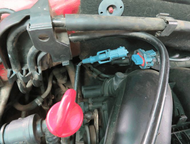

5. Unplug Blue plug of Cam sensor. (3 pin)
6. Remove cable from cable holder.

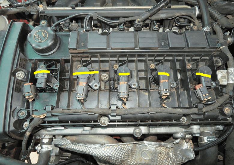

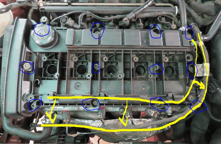

7. Remove 5x ignition coils.
8. Loosen cables attached to cam cover and move out of the way.

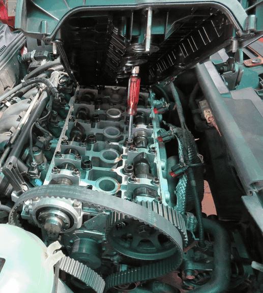

9. Loosen 12 cam cover bolds.
10. Well I did not remove the breather pipes etc. It is not necessary I just lifted the Cam cover with a socket extension as temporary lever (look at image)
This helps with material maybe falling in, or damaging a clamp, hose or even breaking a one of the cam cover hose connection pipes.
Be careful not to drop anything into the oil ports or even close by, this is a clean condition area!

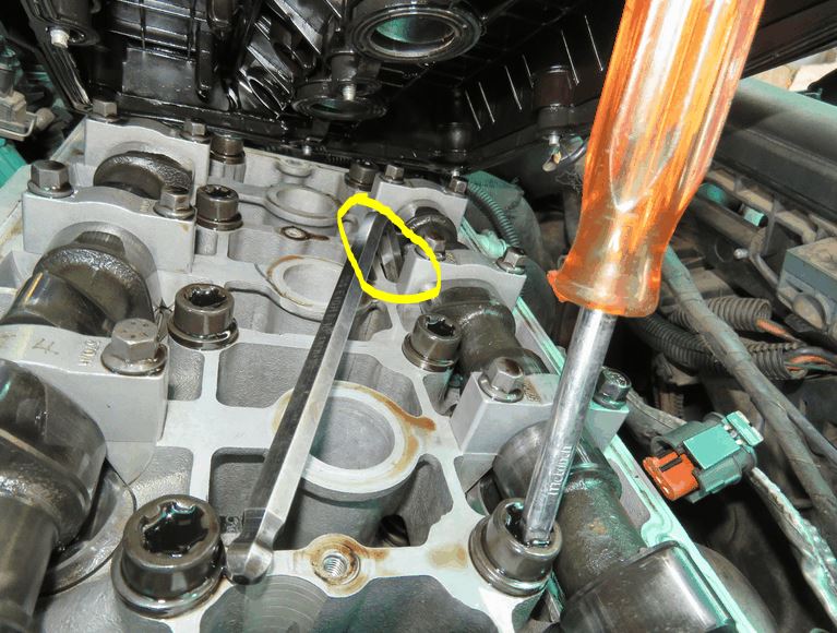

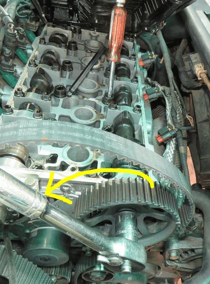

11. Now not everyone might agree with my method but really there is nothing wrong of how I "locked" the exhaust camshaft from turning anti-clockwise.
I looked for a cam lobe that were close to a head support shoulder and inserted a flat tight fitting Allan key for the cam lobe to press against while I loosen the cam bolt.

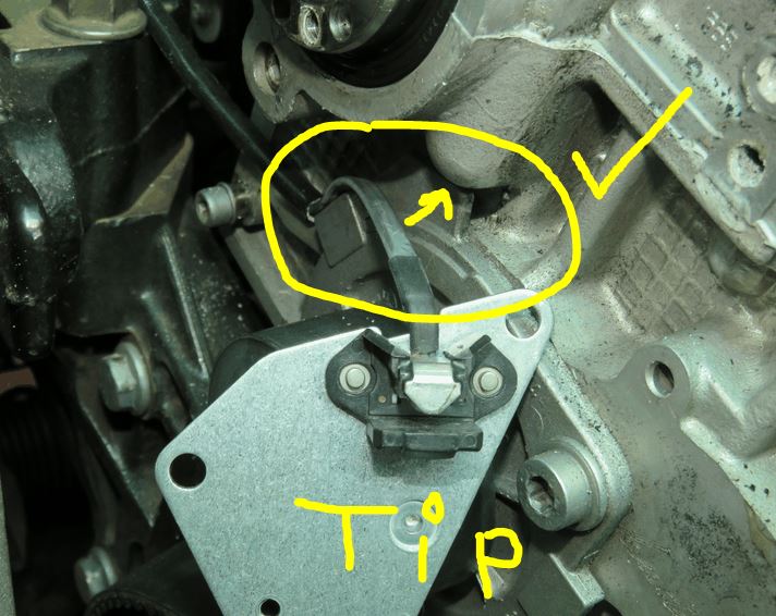

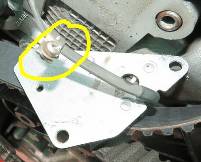

12. Remove the 2x Allan key bolts from the Hall effect phase sensor (Cam sensor)
TIP! Before I loosen remove the cam sensor I first remove the star (Phillip) screw clamp at the back of the plate so the flat cable is exposed more, then pull the sensor as close as possible to the known Water Pump area where there is a very thin tight opening, since the sleeve is now out of the way, the cable pull out much easier, so using same principle when installing the new sensor, eliminating any pinching.
Section 3: Install new Cam sensor and replace Pulley's

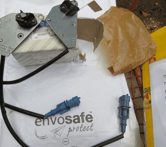

1. Install new sensor, Lightbulb, I use the procedure of removing the star screw and clamp to thread the cable to eliminate pinching, as described during the removal process and images.
2. Tighten 2x Allen Key screws with Loctite.
3. Pull the Sensor cable to its path and plug in.

5. Lock the Exhaust Cam again, now in the opposite direction with the Allan Key.
6. Torque the Exhaust Cam bolt. (Loctite)

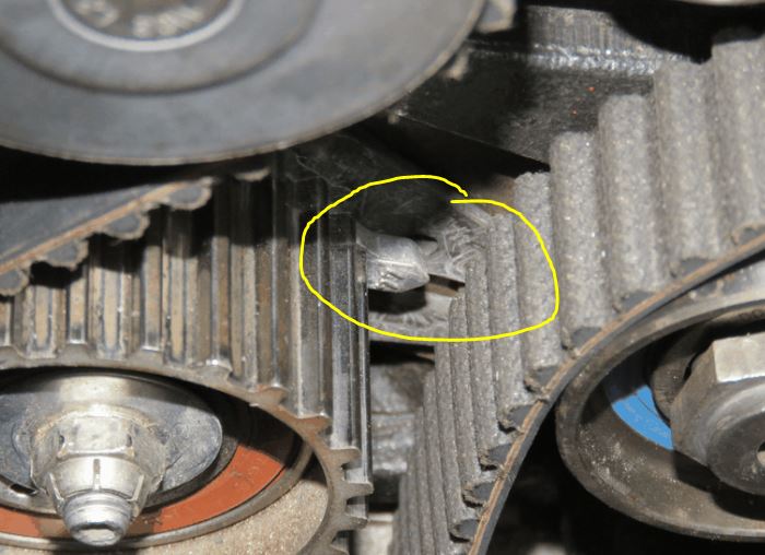

9. Pull the belt over tightly from the Exhaust Pulley to make and make sure the mark at the crank and exhaust match.
10. Now insert the Inlet cam pulley under Neath the belt aligned with its own mark and press upward till pulley fits over shaft.
11. Replace the plate washer and the 4x Ribe bolts, verify it align with the markings made, ( I used a punch and red marker during disassembly)
12. Verify Crank / Exhaust and Inlet marks correspond.

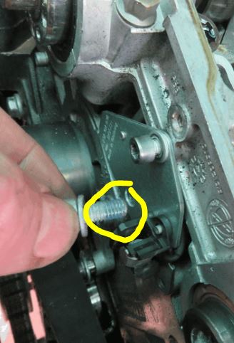

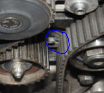

1. With all 3 pulleys on its marks, I tightened the tensioner just enough so it can slide with the screw driver wedging but has enough friction to stay in place. It took 3 times till I got it right.
2. Move Tensioner till it the pointer aligns to the dot (hole), now remember this you are now looking at an angle that can give you a parallax error so take your time!
3. Lock tensioner when correct position.
