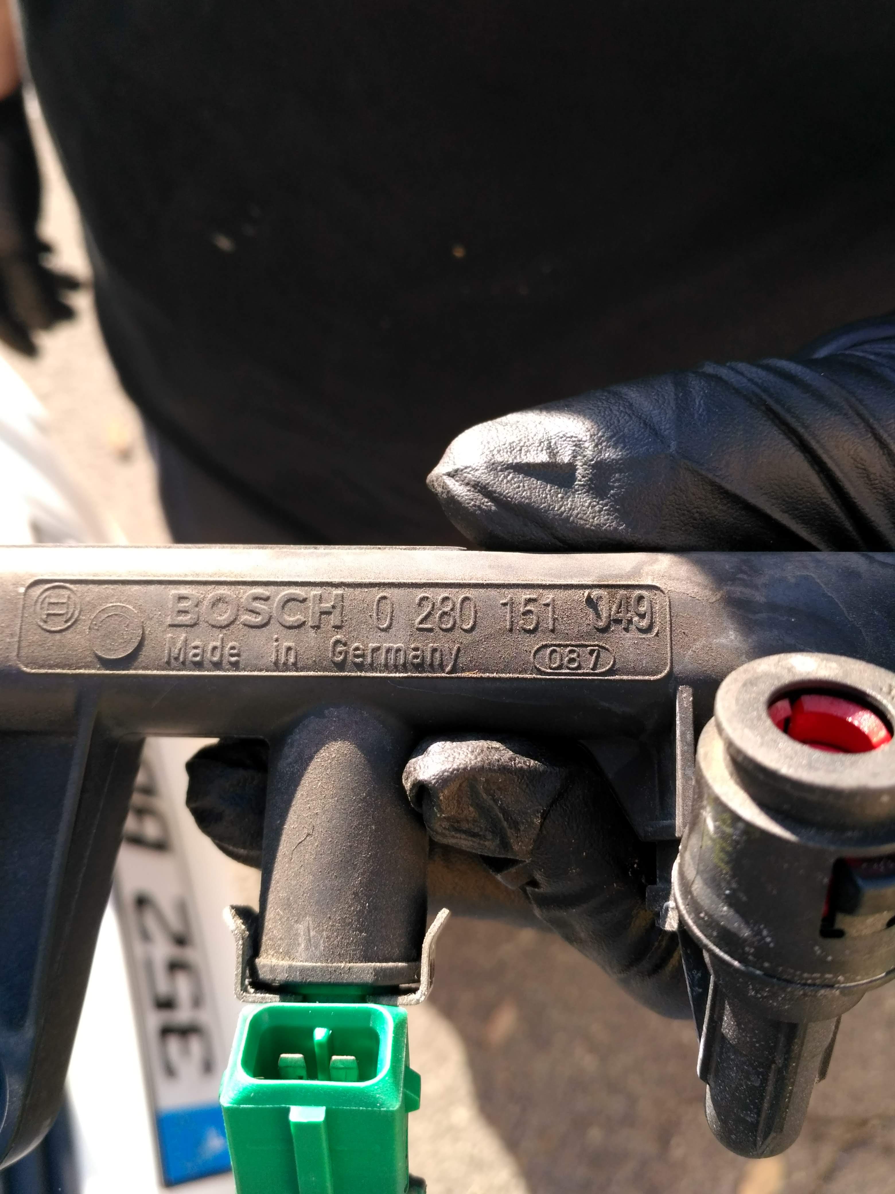

edit: with the picture below and the measurement of the cap from the fuel rail I should be able to do a good estimation

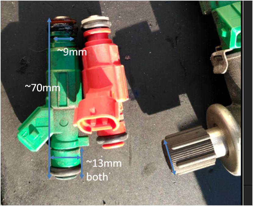

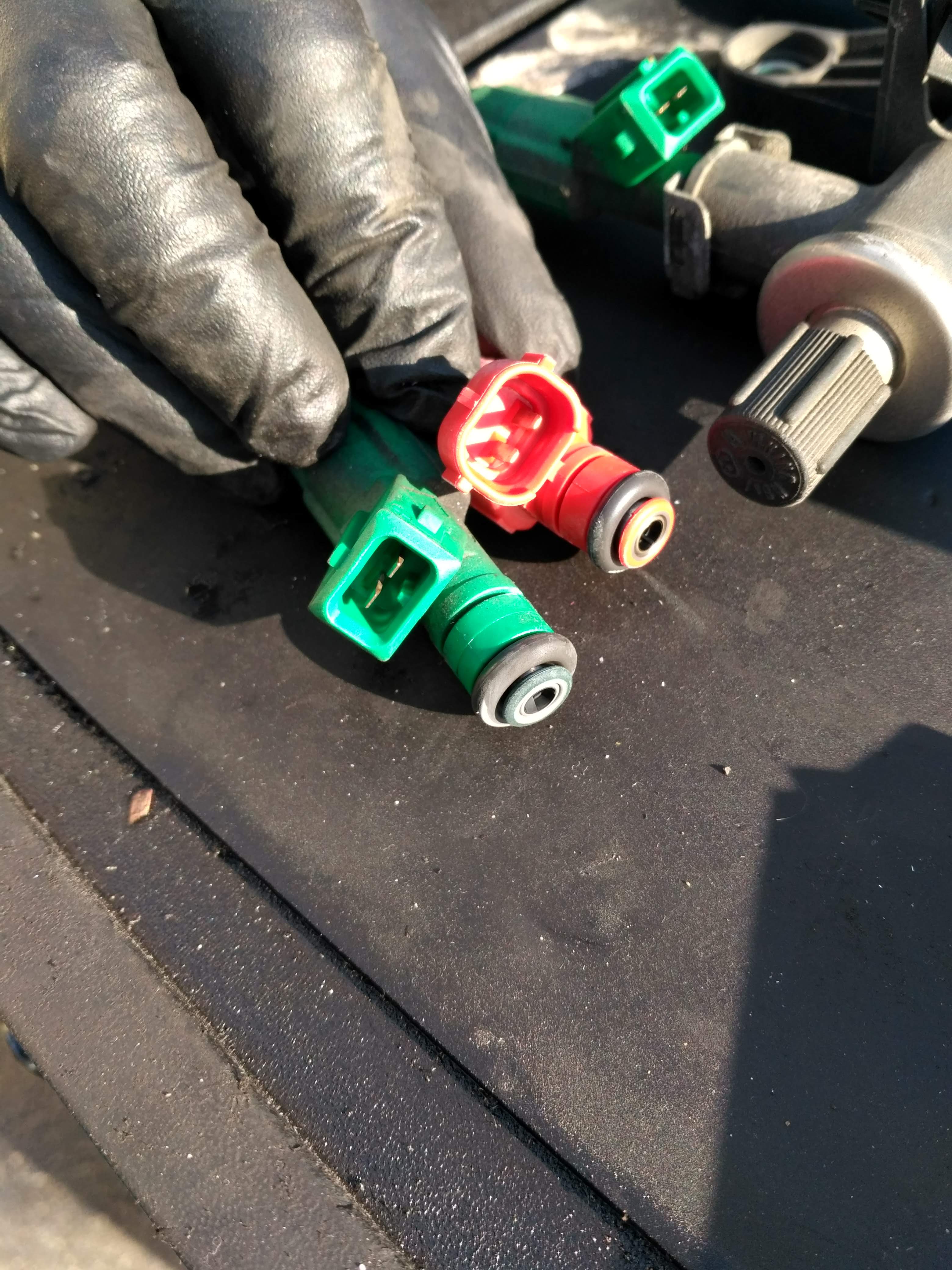

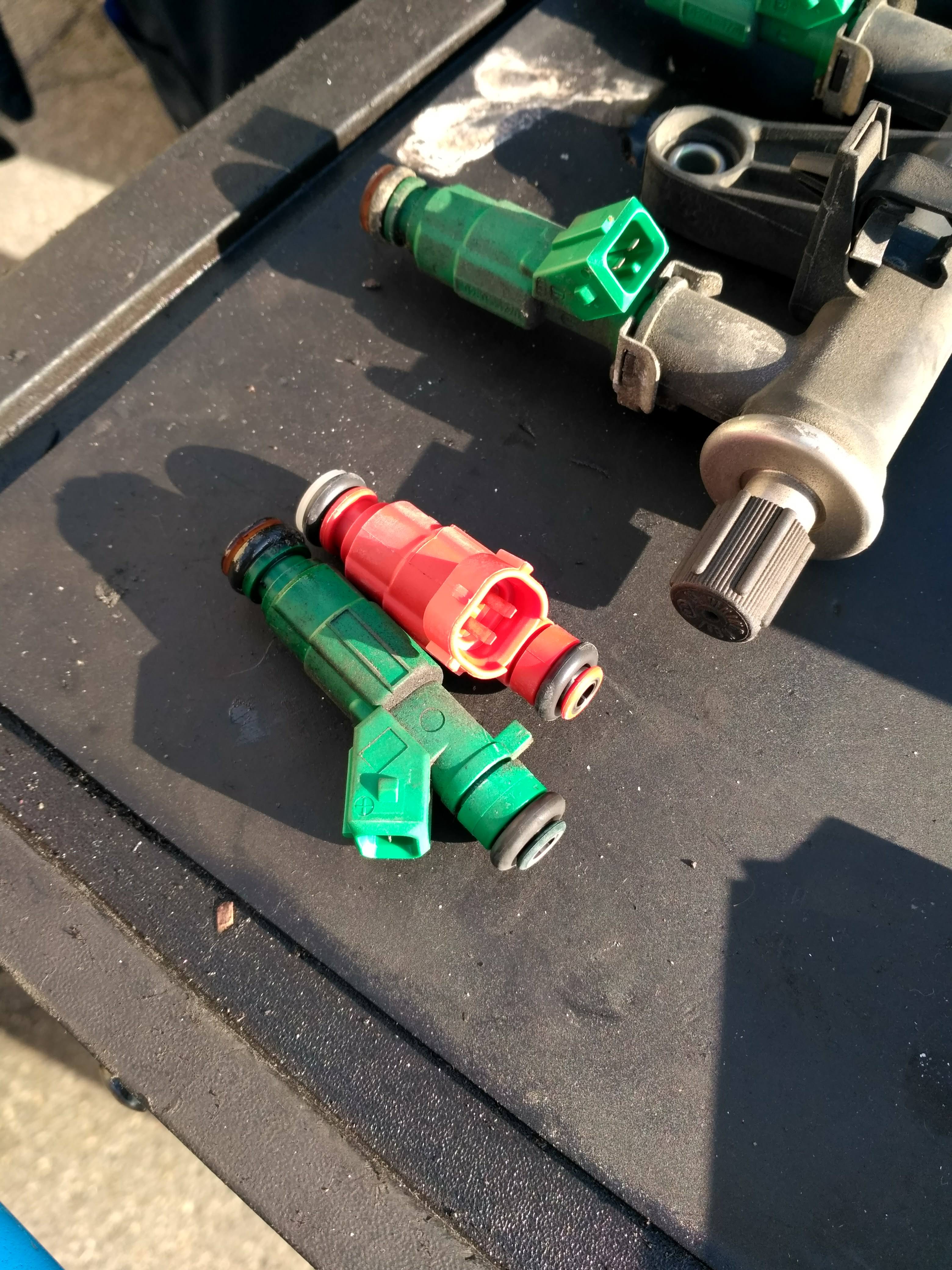

In a mean time, here a few pics when I tried to do that 1 year ago ..
I dirst discovered that buying a EV6E bosch do not mean to have the same geometry ...
The red one is
0 280 155 940, and as you can see is too short
but it was 14.5ohm and 158.3g/min (it was to stay compatible with SP fuel)

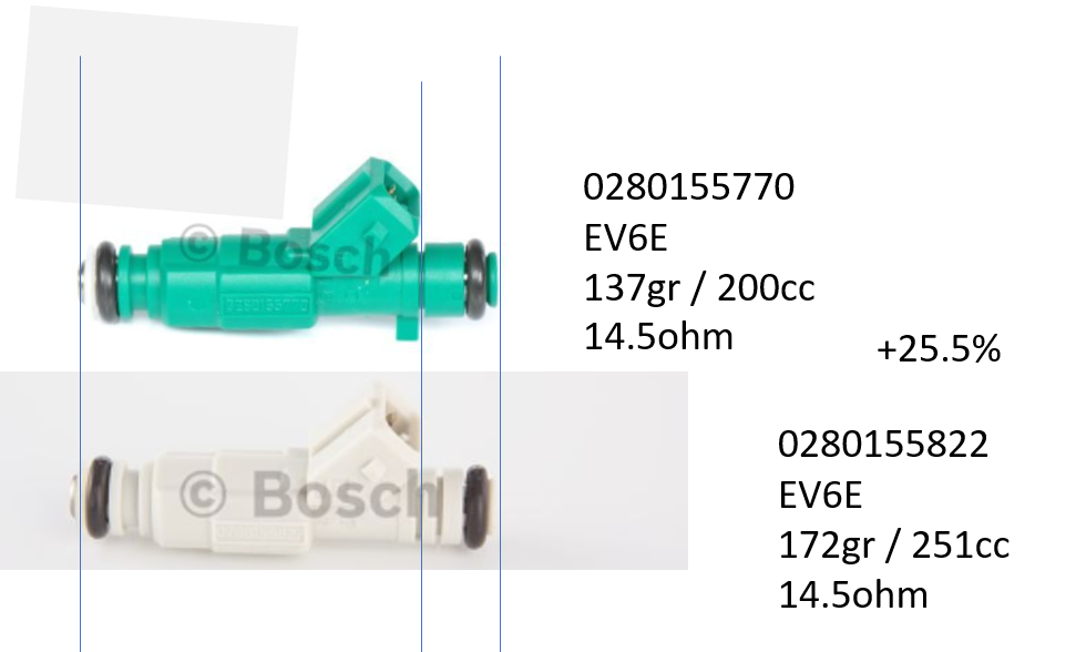

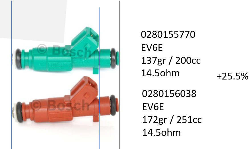

ok so, I've estimated some size ..
See picture
Yeah, ~200cc what I have currently, I would need 30% more ..
