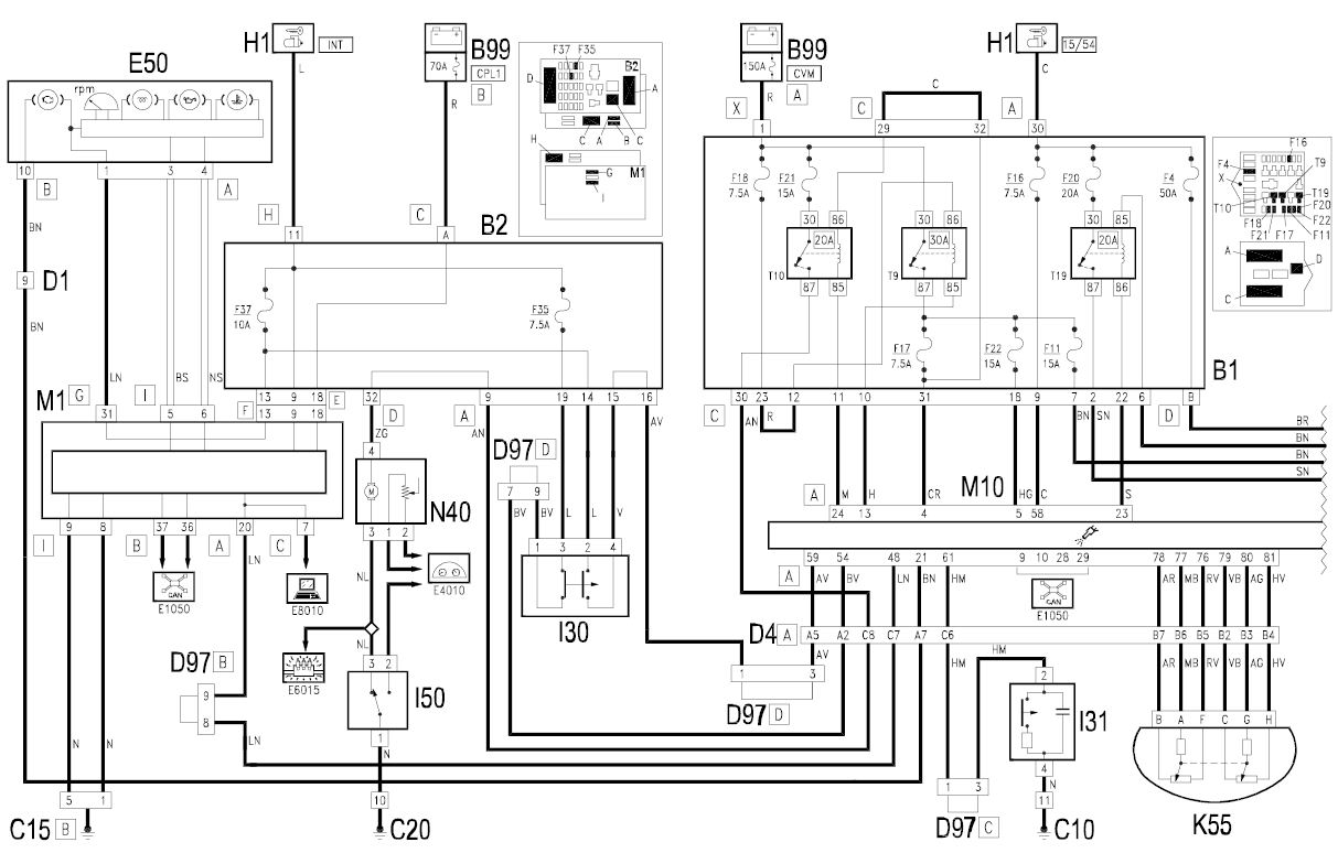

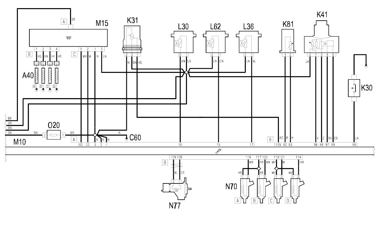

The Throttle Pedal Sensors (K55) get their power and earth supplies from the engine management ECU (M10) via the D4 connector underneath the engine fuse box. Sensor 1 gets power from pin 78 and earth from pin 76 of the ECU. Sensor 2 gets power from pin 81 and earth from pin 79 of the ECU.
As all of the TPS wires go through the D4 connector, it would be a good idea to clean it with electrical contact cleaner if you haven't do so already. There's a guide to locating and cleaning it here: https://www.fiatforum.com/stilo-guides/99828-d4-connector.html
