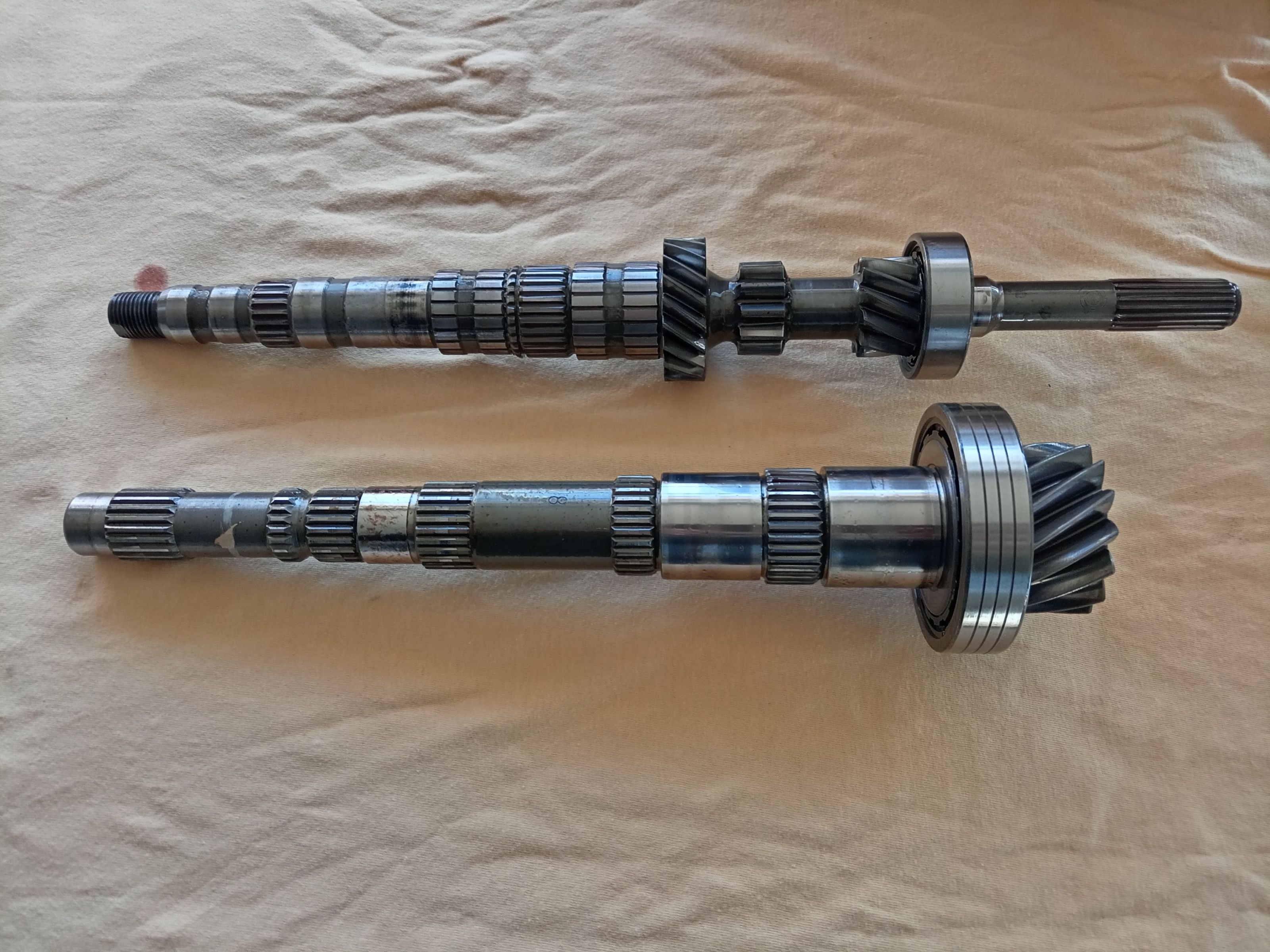

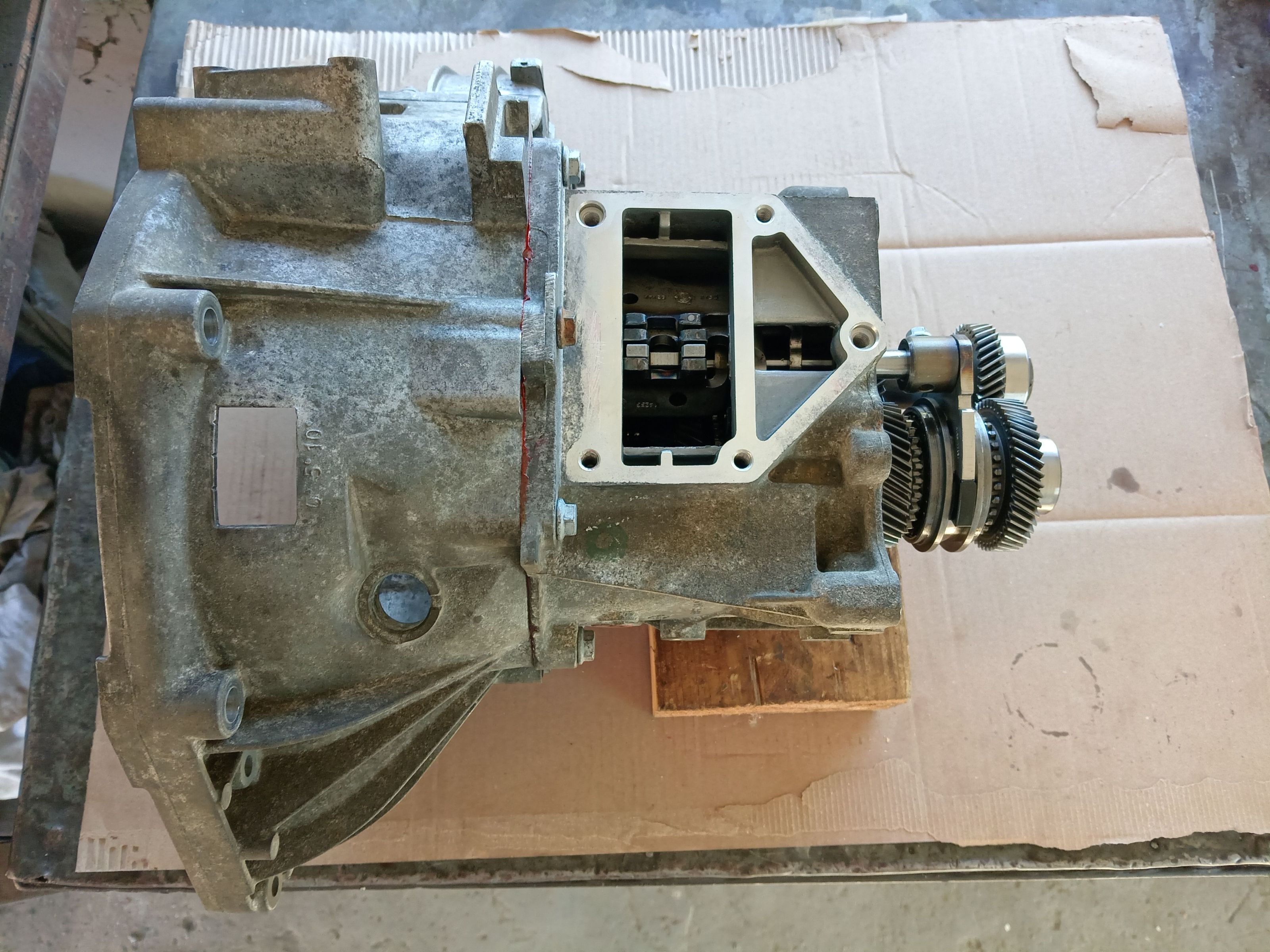

I replied exactly to you, because I do the same job at these weekends. I bought the 1.6 and the 1.2 gearboxes, just as you plan and started to rebuild one 6 speed from the two for a 1.6 16V engine. I can share my observations if you need.
Almost done.

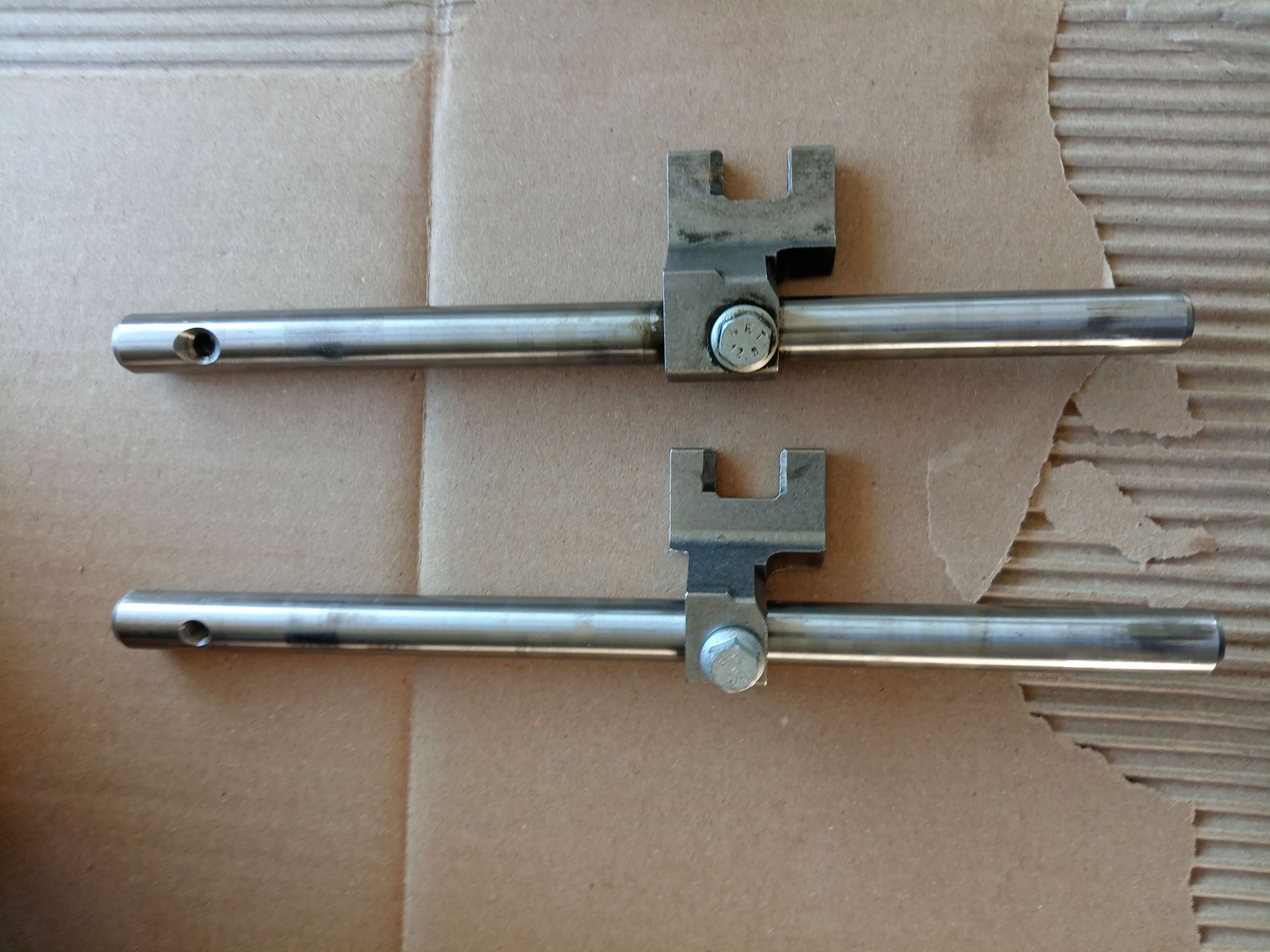

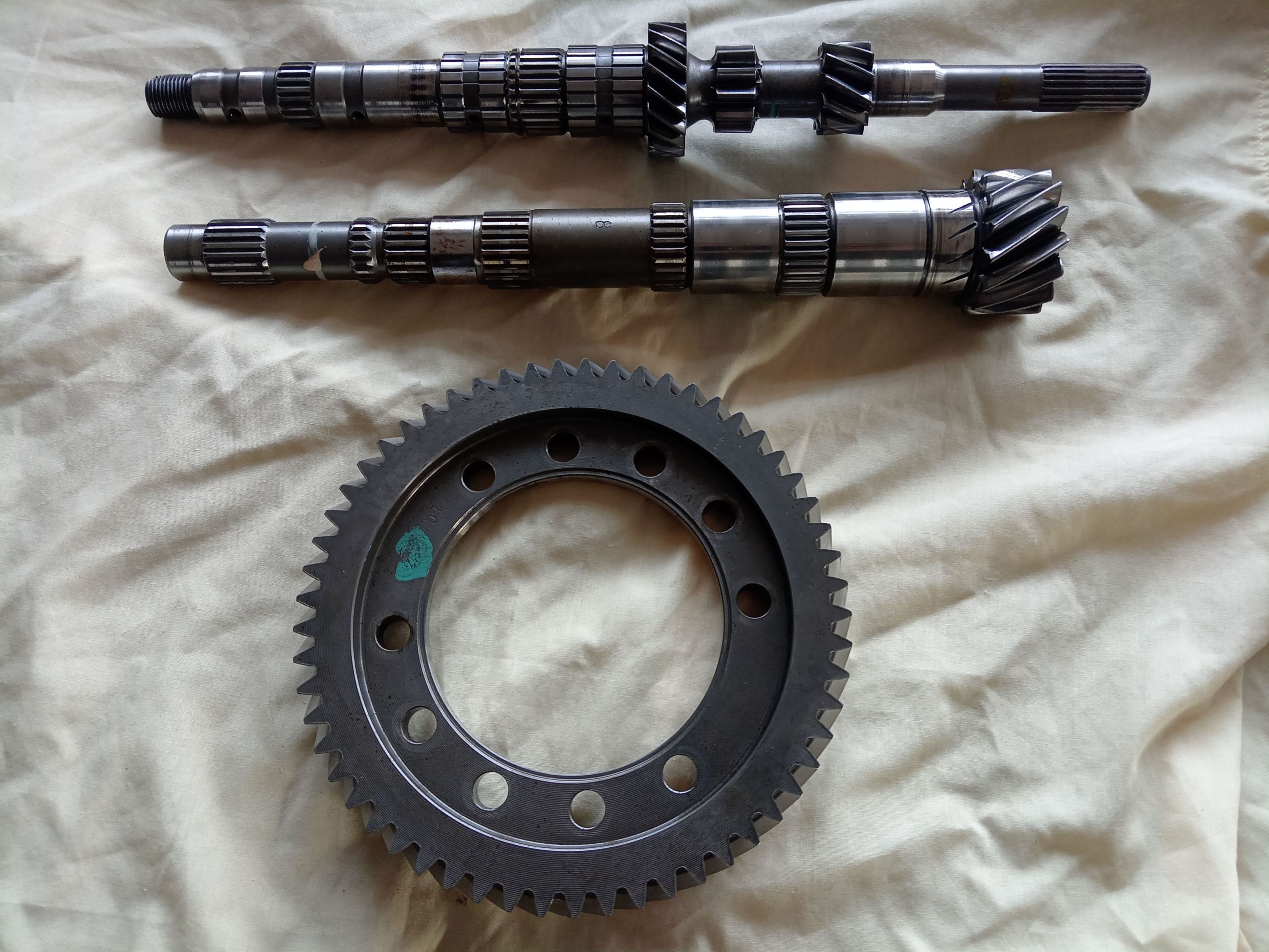

It is just a straight fit. As you take apart the two gearboxes, you can piece together one without any difficulty.
In my case, I used every possible parts from the 1.6 one because that had a low milage. Replaced the two shafts with the differential ring gear and the rod of 5-6th gear with the longer one. And of course you have to use everything after the 5th gear pair from the 1.2/1.4 gearbox.
I hadn't installed it yet, but earlier I swapped a Fiat Bravo 5 speed gearbox for a Stilo 6 speed and you don't have to do anything with the outer control, maybe a little adjustment, but just because you install a different gearbox.

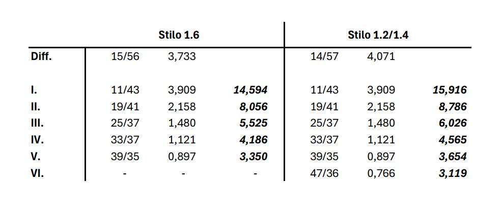

I made a comparison table of the gearboxes, I attach that. So you can see, no difference in the gear pairs only at the differential ratio. Because of this you can select from two sets of almost everything.
