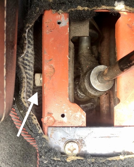

The 2 bolts that hold the gear-lever 'box' in place are on the inside of the car, on the right side of the central tunnel, level with the gear lever. You just slacken them off slightly (13mm spanner ) and gently tap the head of the bolts to move the selector 'box' forward.
Finally managed to access the gear lever box.
Had a look inside the box but couldn’t see anything obviously wrong there.
The bolts on the side of the box are a bugger to loosen without removing the carpet but I managed.
Moving the lever forces the box to move and I think it eventually settled just slightly back (1mm) from the original position but getting out of 1st and 3rd is much smoother now.
