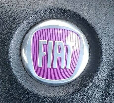

I placed the new badge on the fiat one but there was a large gap around the outside edge which I wasn't going to be happy about.

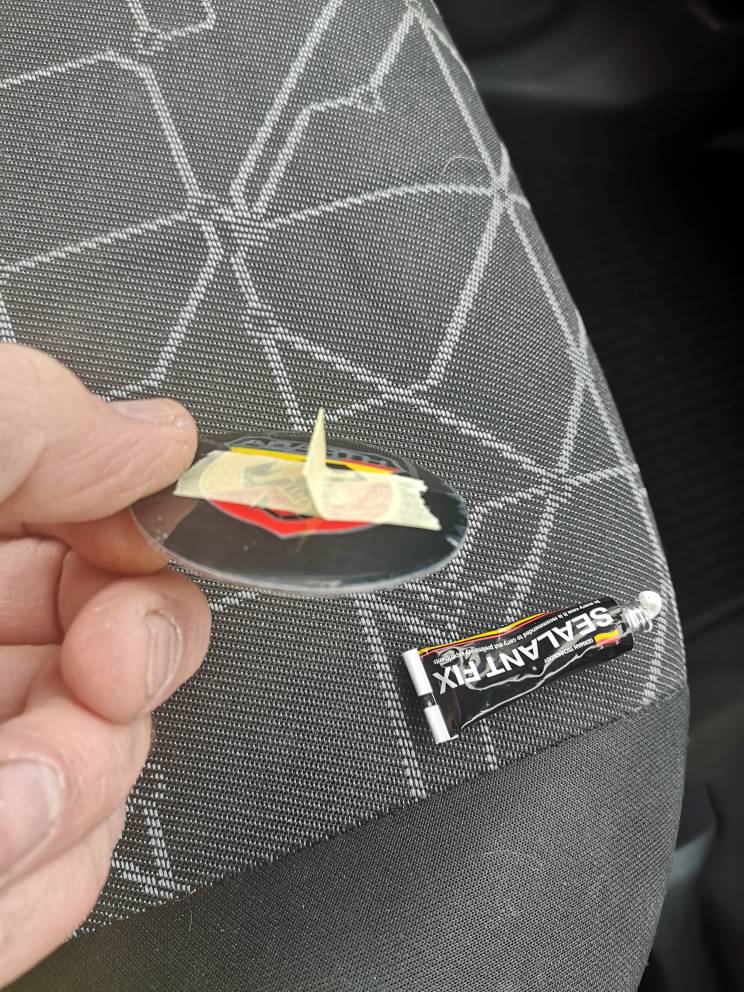

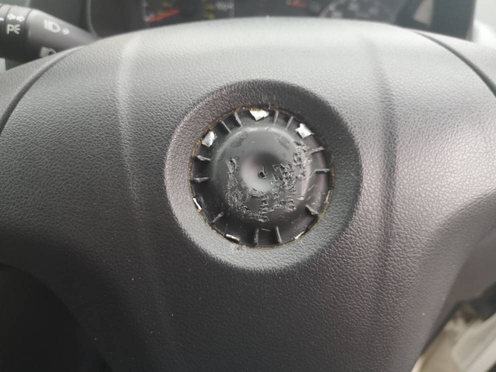

The fiat badge is held on by about six metal tabs and not stuck on, so I got a knife and at an angle in the centre of the badge managed to cut through and with side cutters peel the badge off on parts leaving the tab in place these were then cut close to the mounting area.

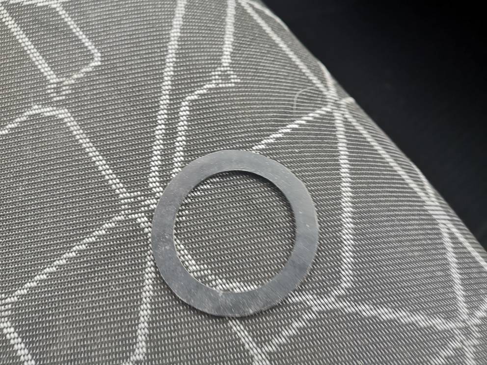

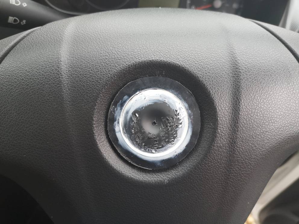

The centre of the area is quite domed and to much for the Abarth badge and needed a small spacer around the outside edge so I used a rubber washer from a bath overflow kit I had knocking about it it was perfect (Any plumbing outlet would sell these)

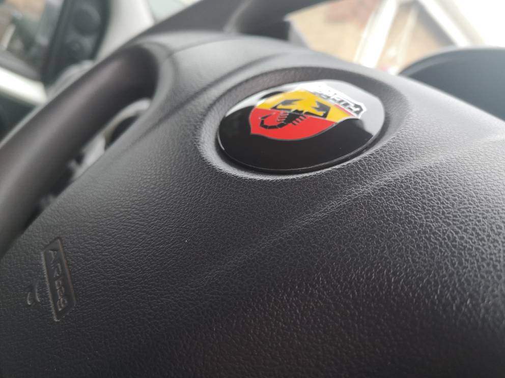

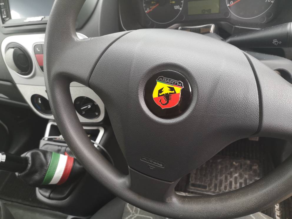

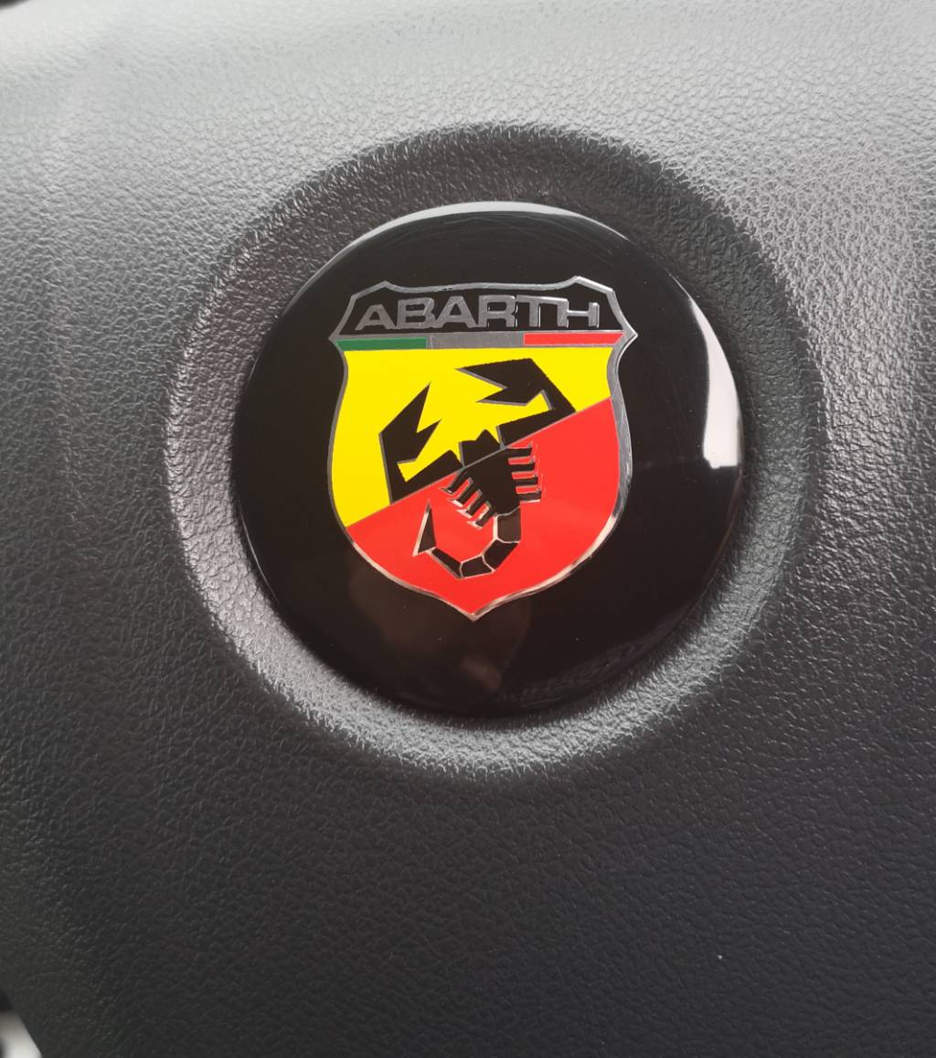

I added a bit of sealant to hold the rubber washer in place and on sticking the Abarth badge using masking tape as a handle I had a perfect fit with no gap

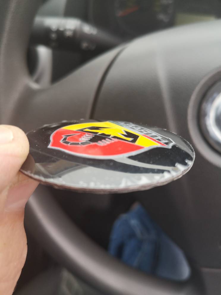

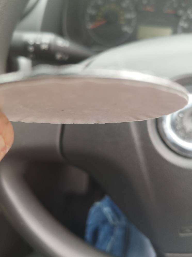

As you can see from the pics the old fiat badge is really thin
The job took about an hour to do and I'm really happy how this turned out
