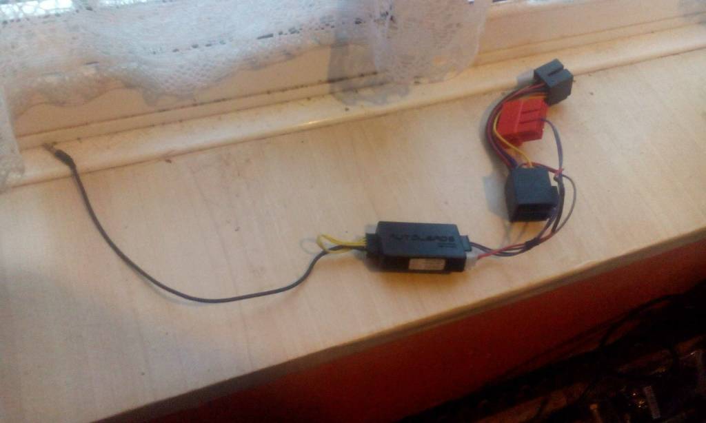

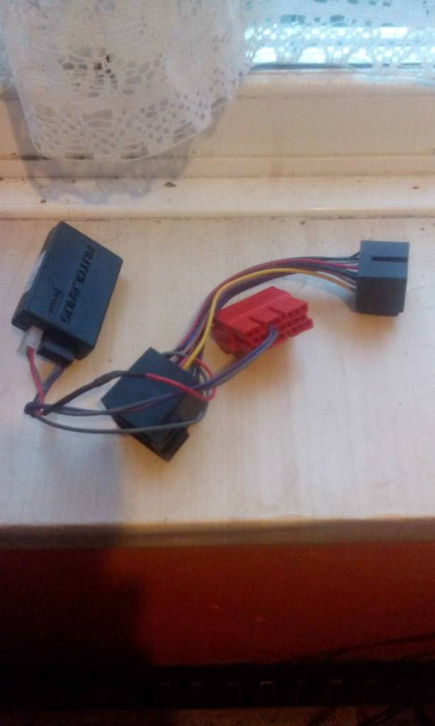

But on the rear side of the Autoleads, we have this
The two small connectors on the left seem to plug into this small black box, and the big black connector on the right seems to be the ISO connector, that will end up on the Kenwood patch lead , right ?
Now my question is, where am I going to plug the Kenwood Sterring control ? on the other side of the small box ? Will I need another interposer cable ??
