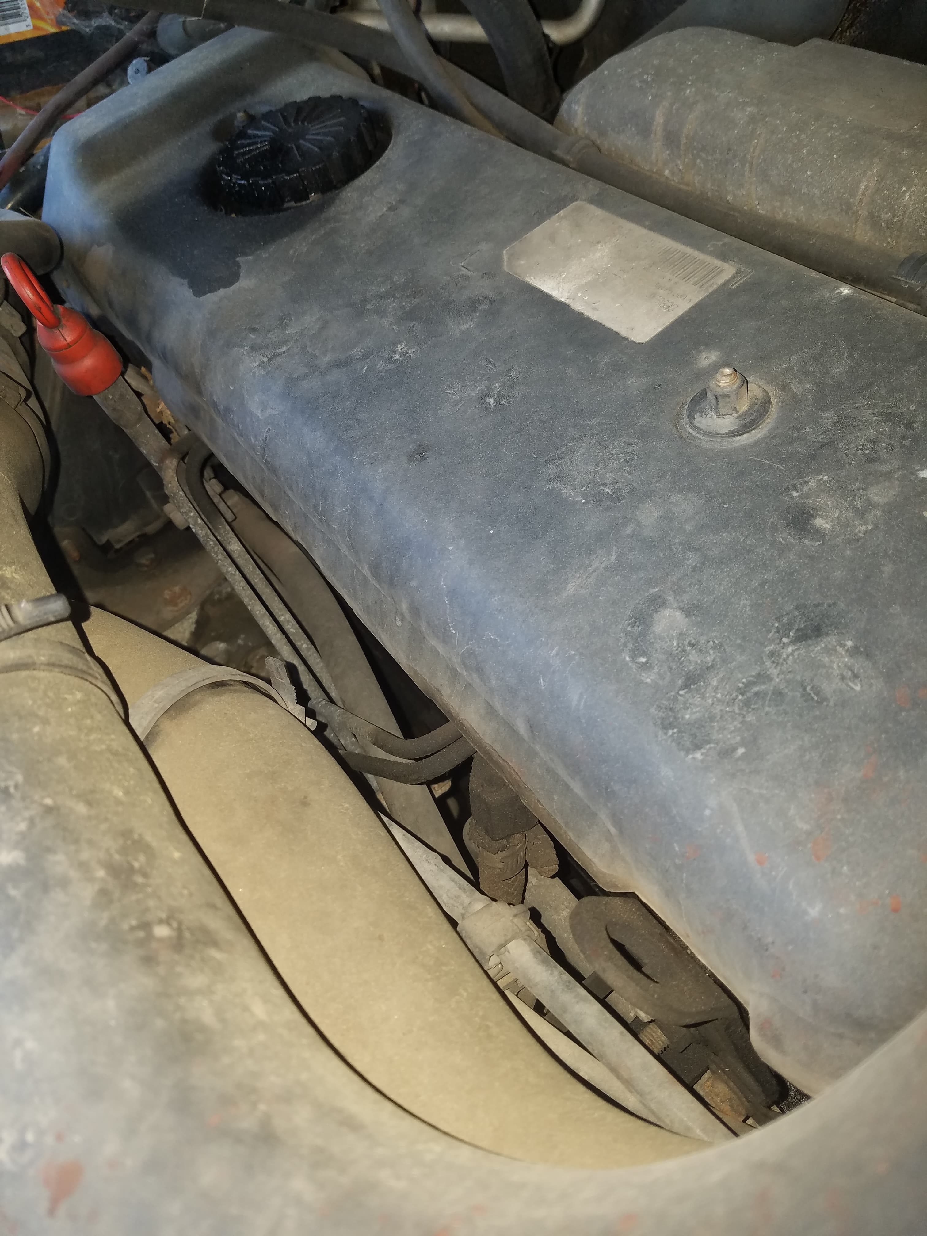

I think an easier check would be to look for the Engine Control Unit (ECU).
The ECU is fixed to the inside of the LHS front wing, close to the air filter. It is enclosed in a black plastic box about 1.5" thick and 8" square, the box has 2 large cable forms connecting to it.
Another possibility is a possible paper label on the plastic cover at the top of the engine. On my 2.8JTD it starts 8140.43S. IDTD will differ.

1.) There appear to be no wires leading to the injectors, just thin steel tubing.
2.) No ECU, anywhere that I could see.
Soooo I'm thinking idTD then.

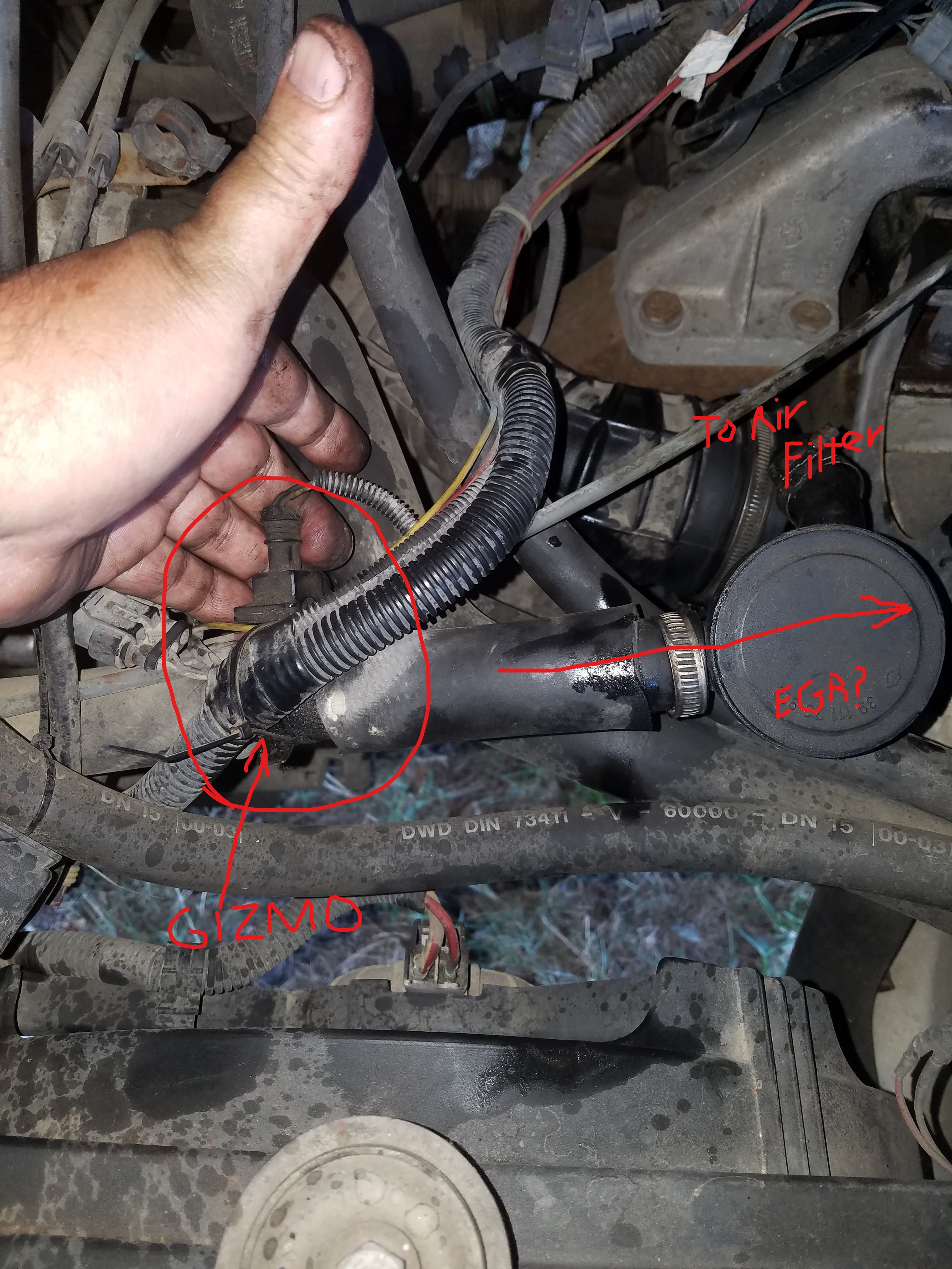

But, just after trying to fire him up and when feeling around what might be the EGR? if there is EGR's on diesels? along the tubing coming from the block to the air filter housing, I felt that the GIZMO about halfway along this 1" tubing is kinda warm. There's a shot of me holding it in my hand, WHAT IS THIS GIZMO? and could it the culprit?

1. Engine must be idTD.
2. Gizmo seems to be an Oil Vapour Heater.
3. Device marked EGR is a non return valve, where blow by gases from the sump are routed into the air inlet, after the fuel filter.
EGR valves are fitted to diesels, but they are usually associated with a mass air flow sensor, and require some form of control system.

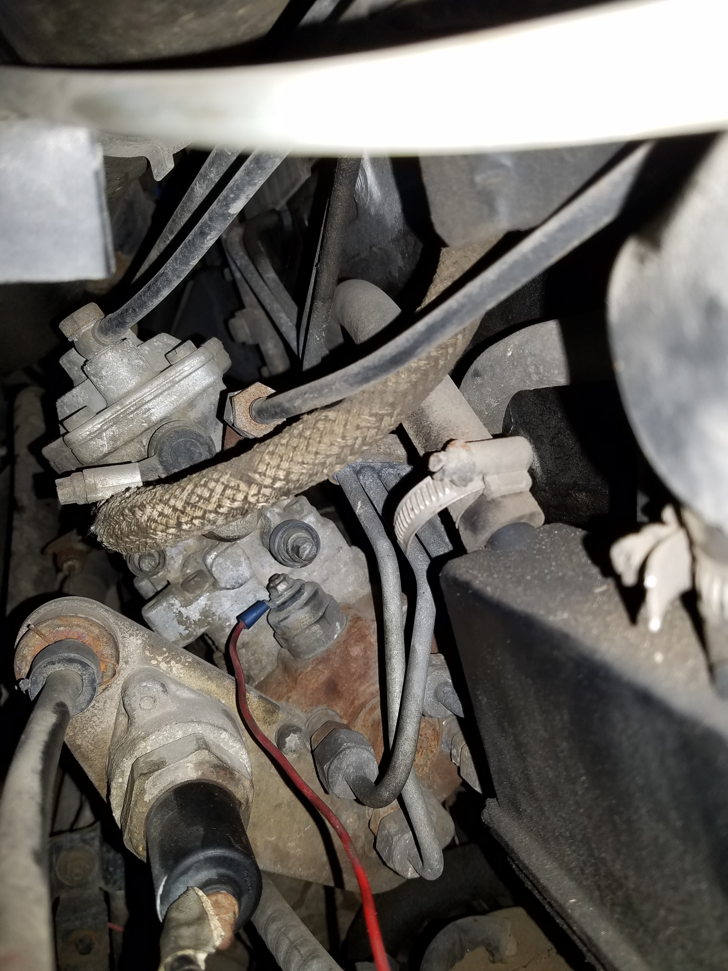

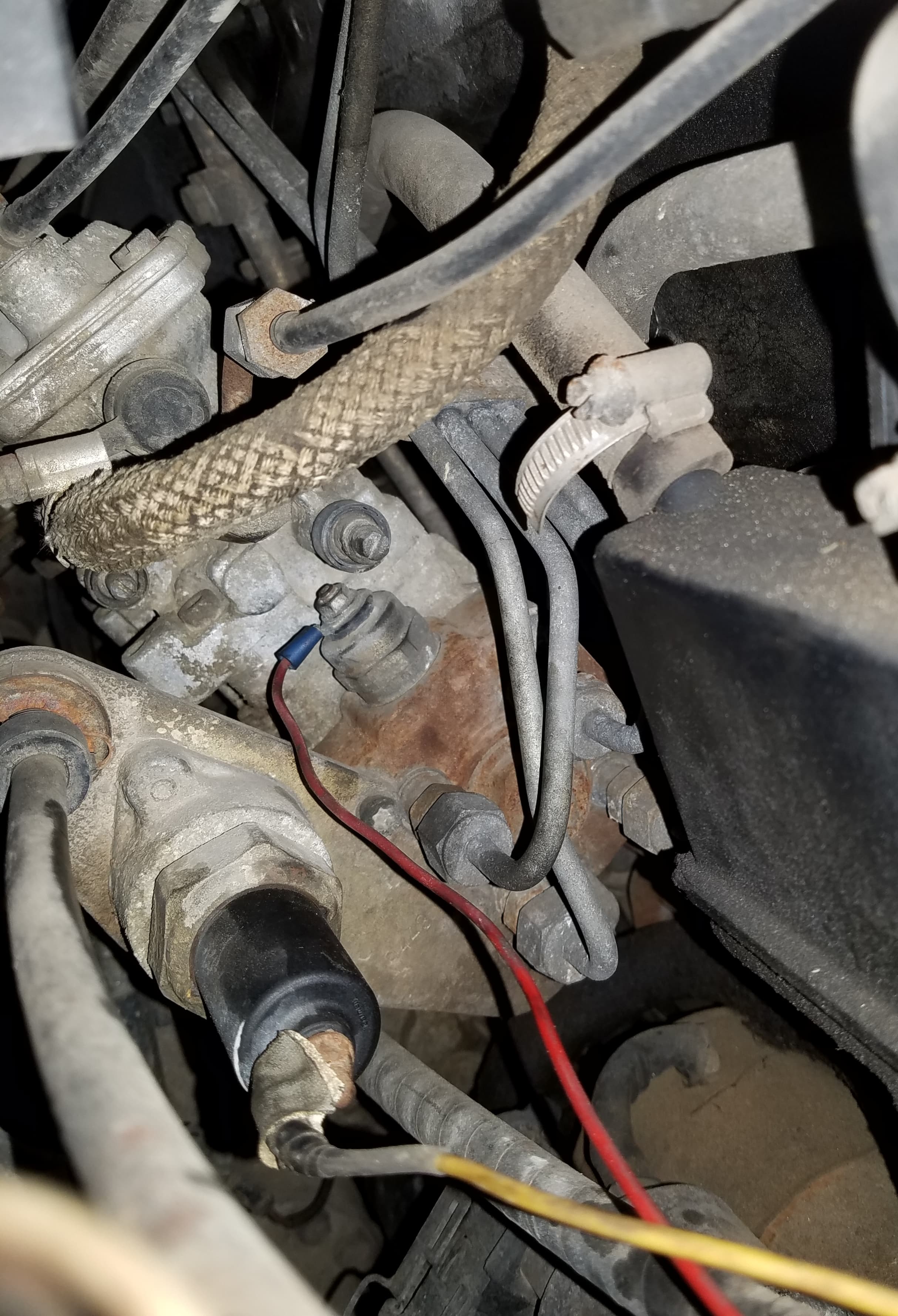

Here's the best shot I could do with the limited access between the radiator apparatus and the engine blocks heads. I can see the Shut Off Solenoid, bottom left, that got exposed when the epoxy immobilizer unit was removed. It is here that I ran a hot wire (YELLOW) to the solenoid from the ignition.
The other wire (RED) was original and leads to a point on the fuel pump but I do not know what that does.

I'm not familer with your injection pump.
I think the red wire is the stop solenoid.
The yellow wire ? Does that go to a unit the slowly pulls on a cable to a lever on the pump when ignition on?
To test what I think is stop solenoid: apply battery voltage to the red wire terminal and listen for a click or tic , it is very quiet. It should tic. Leave it connected for a few minutes , disconnect and reconnect listening for tic (I suspect tic will be absent proving solenoid failing when been energised for a short while) or maybe 12volt feed to solenoid iffy.

At the end of my yellow wire, is the fuel cut-out solenoid that I exposed when I removed the epoxied block that contained the immobilizer receiver that was faulty many, many years ago. Since then I have activated the solenoid with the yellow wire from the ignition switch. I never really listened or took notice to the actuation of the solenoid. Back then I just assumed this wire had to be in place.
Today I engaged the ignition switch while listening to the solenoid. I heard no click. I also removed the spade connector and re-connected it while the ignition was on and I heard no click. And lastly, I have taken a direct feed from the positive battery terminal to the selenoid, and guess what, no click.
I am thinking I should be hearing a click here. Am I correct?
Take a Look at the photos in previous post
The new stop solenoid on eBay looks like your red wire connection. That one should click when battery voltage supplied.
I think your yellow wire connects to a cold start device that pulls on a lever when cold.
If it is then it will not click when supplied power.
