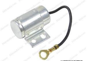

Also, did you replace the condenser that is attached to the side of the distributor? It looks like the picture attached. If the condenser fails it will cause exactly the problem you are having.
