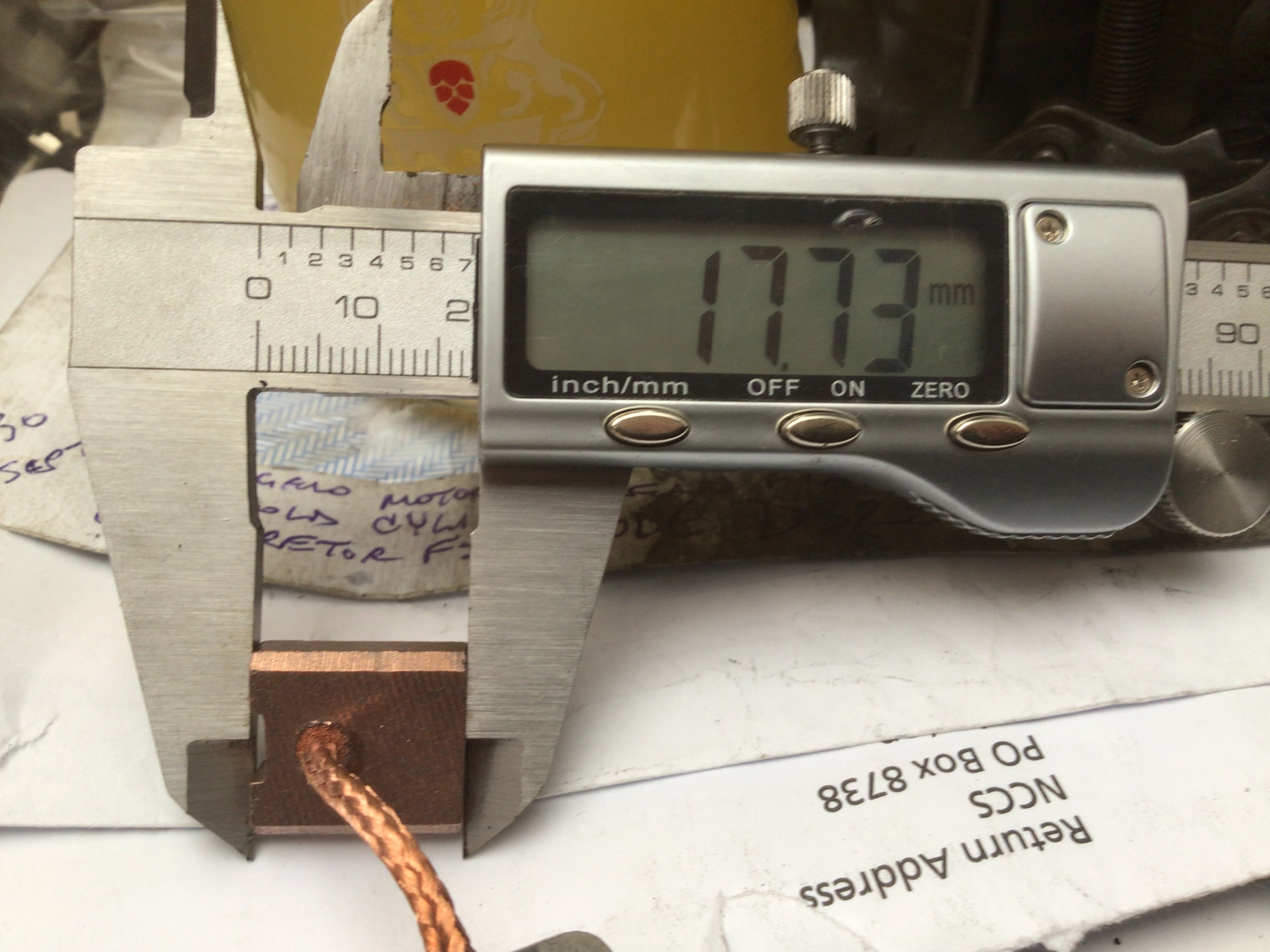

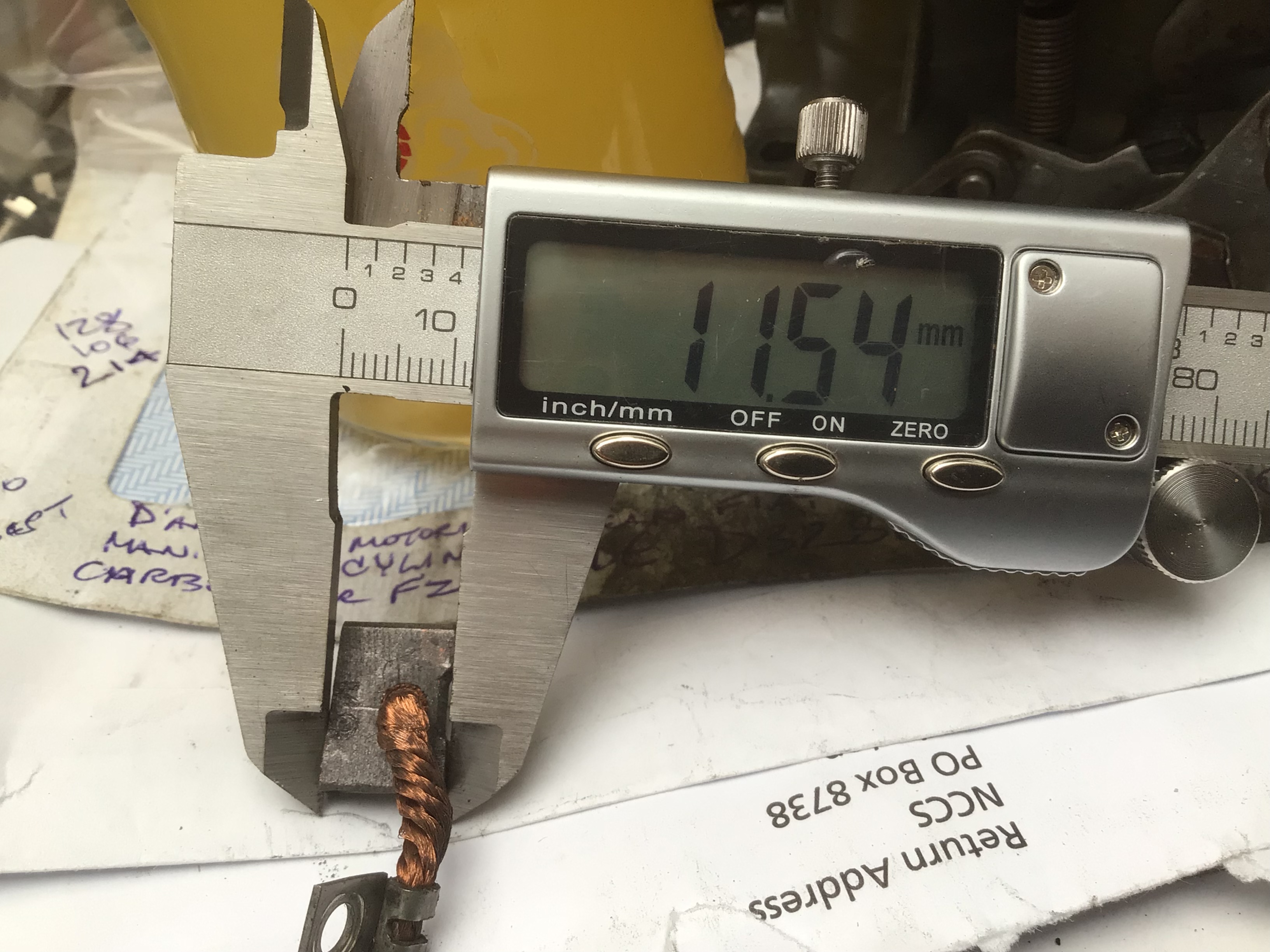

Are you happy that there is enough meat left on the brushes for them to make good contact with the commutator?
If they are too worn the pressure springs bottom out so starter will not work.

If the brushes have worn very low, the spring that keeps it in contact with the commutator cannot exert enough pressure , this allows sparking and damage to the commutator. I not too bad the copper contact area can be cleaned up with fine wet and dry sandpaper, afterwards the gaps between each copper strip must be gently cleaned out so as not to bridge between, then cleaned with alcohol, refitted with new brushes etc. There used to be a tool for the job, but a skilled lathe operator would have no problem.
