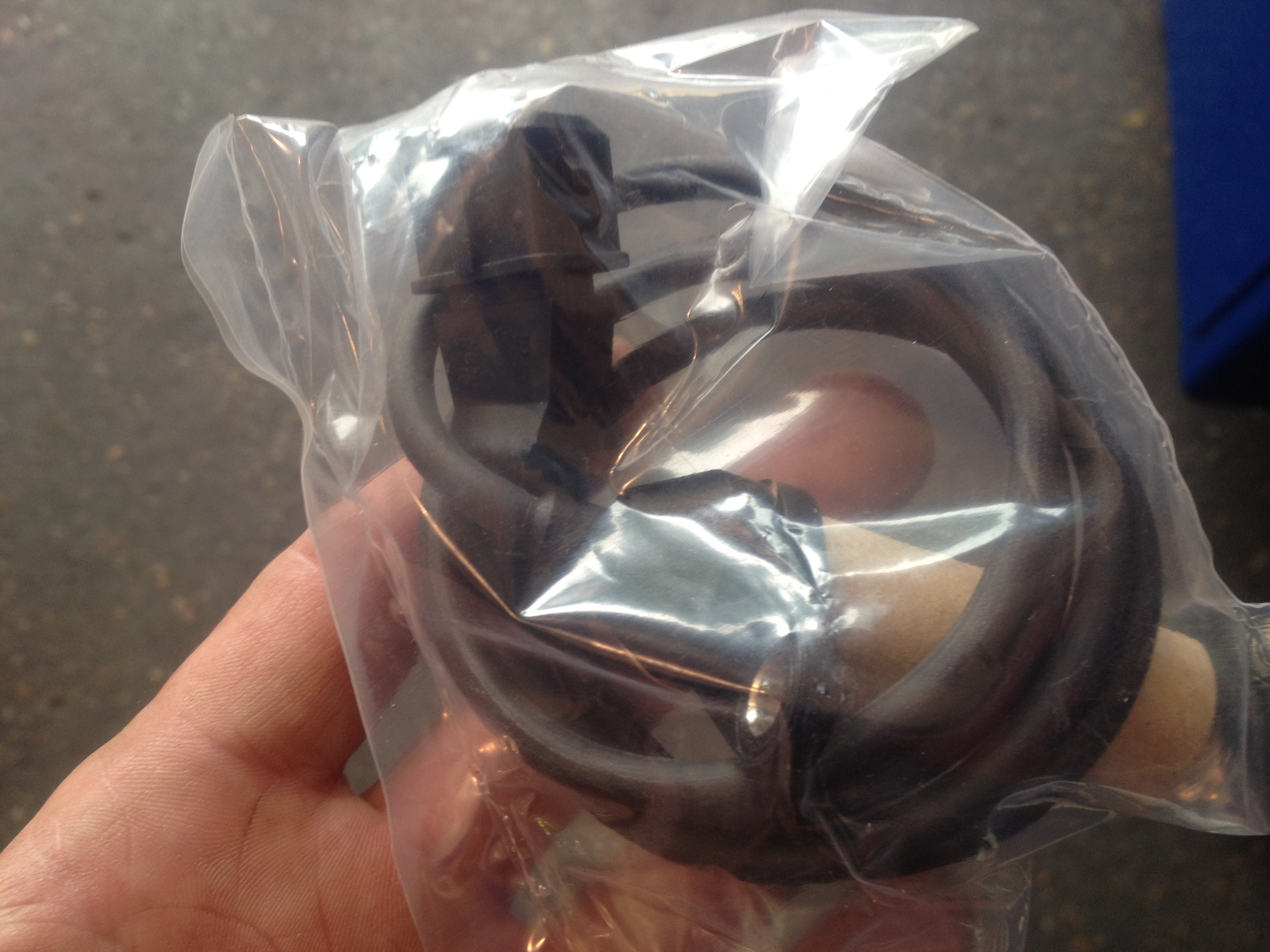

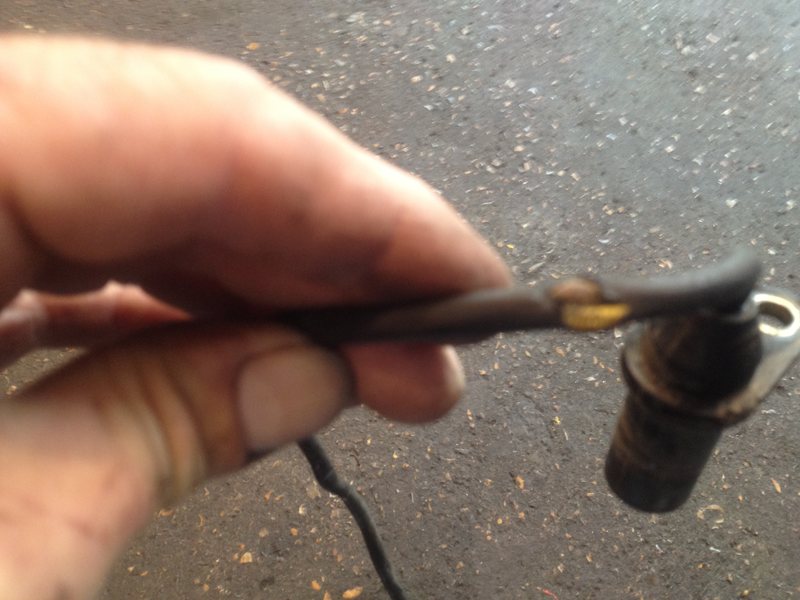

Finally the first problem has reared its ugly head:D:D ive got something to do....was having a problem starting for the last 3 mornings,noticed that fuel pressure had dropped to 2 bar instead of 3 bar so adjusted fpr back to 3 bar and ran it for a day all good and thought cps was playing up as all i did each time was wipe a bit of paper towel over the face and then car started so got a new cps today and all seemed ok until it came to leave work and same problem and noticed that fuel pressure when i switched engine off pressure was dropping very quickly which normally it would take an hour to lose a bar in pressure not less than 60 seconds:bang::bang:
spoken to dan and chris to pick their brains and see if they thought same as me....lazy pump but since speaking to them i have been out and taken the fpr off and emptied the fuel and switched ignition on and fuel just humped out the fuel line so that blew my idea of lazy pump:rolleyes::rolleyes:
turned my attention to the fpr and blew and sucked thru its feeds and then reattached and now its holding pressure again:confused::confused: as it did before........just got to wait now till the morning and see if it starts normally as this seems to be the only real time its guaranteed to play up(n)(n) will report back tomorrow evening after work.......
