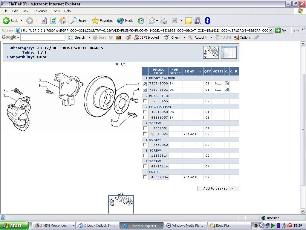

You sure, allanhelen on here thought he didn't have any but just didn't look too hard, they ain't obvious really on some cars with the dirt and crap, if you don't have them then how do you fit the wheels without great difficulty and what holds your brake discs in place?
I found when one side of my bolts sheared the disc was allowed to move about causing unnecessary brake wear and possibly uneven braking.
Heres a pic of what I am on about.
Liam

The spacer appears on the EPR for the Sei as well, I am almost positive that Sei standard Sporting rims are the same specs are Cinq ones.
