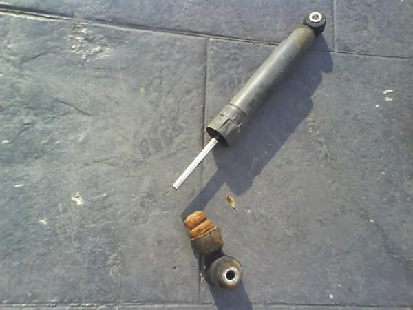

ud be amazed at what it could be, i changed my exhaust, and it suddenly developed a mad knocking noise, obviously i thought id was my exhaust...but it wasnt, it was this:
