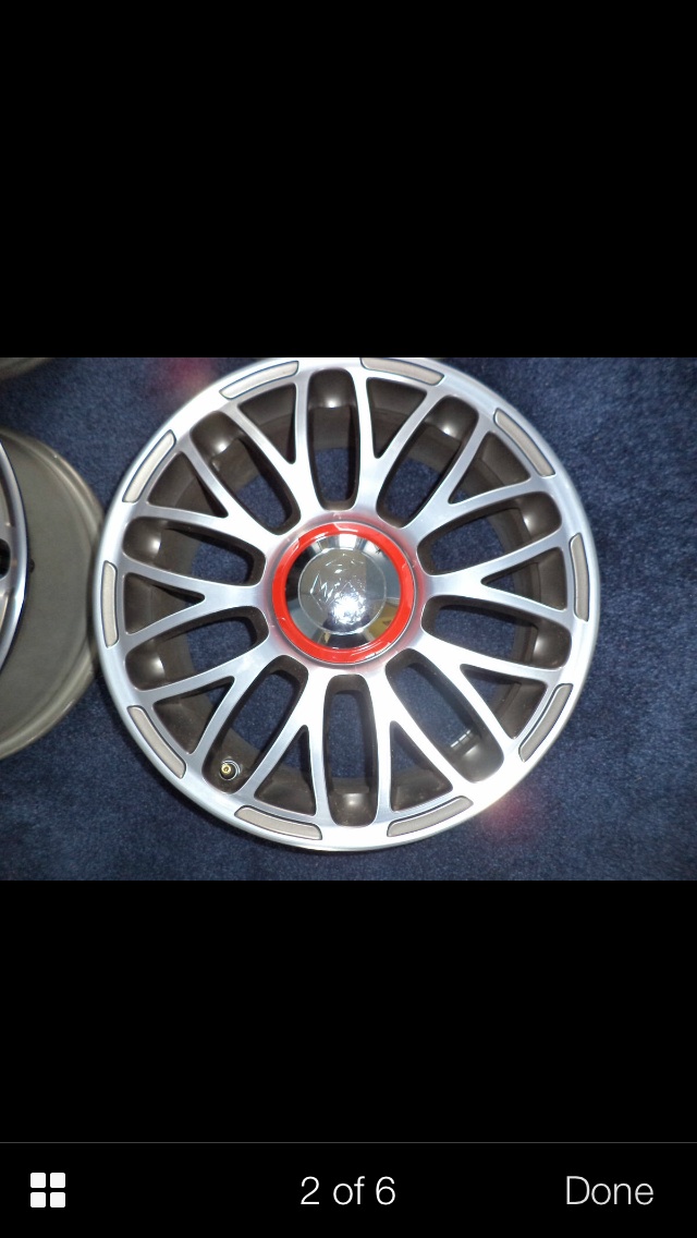

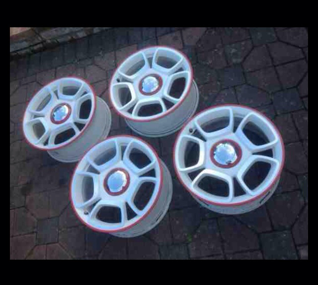

I've just bought some abarth 500 17" wheels to which ones have you got? (Pictures)

Here's my set, do you have the same?
