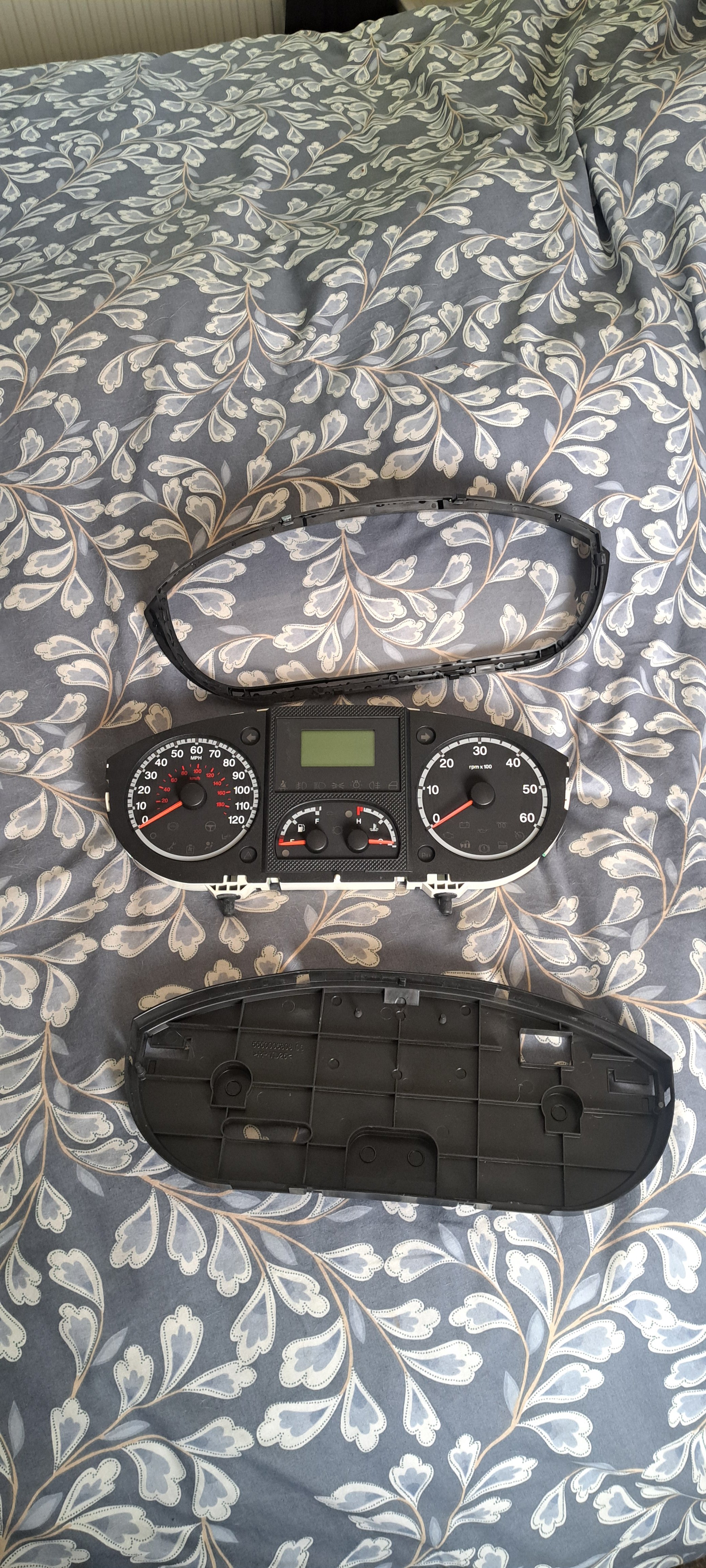

Hi,
I have an 08 plate Fiat Ducato 2.3 TD. Motor home. The Speedo appears to be stuck on 29mph.... (Honest officer I wasnt speeding.... look.....lol)
I took it for a run... the milage is working... so that part still records..??
Anyone had any experience of this??
Im guessing as the milage still records, it's not a good old fashioned cable.... 🫣😮‍💨
🇮🇹🇮🇹 Any advice would be apreciated.....😁😁😃

An "08" plate is a bit vague for positive model identification. The vehivle is most probably a 2.3 Multijet, but could be a very late conversion / registration x244 2.3jtd. Check whether VIN starts ZFA244, or ZFA250.
Have you considered the possibility of a stuck stepping motor spindle. (See guides section.) Alternatively there is a company called "Cartronix" who carry out such repairs.
I seem to remember a recent post similar to yours, so perhaps a forum search?

Vin plate starts ZFA250000
Im in Scotland near Glasgow... were are Catronix based??
I had already done a search & didnt see any thing relating to my year of van... but im human.

Cartronix. Their website locates them at Waterlooville, which is north of Portsmouth.
All sorted..... thanks just needed pointed in the right direction.
