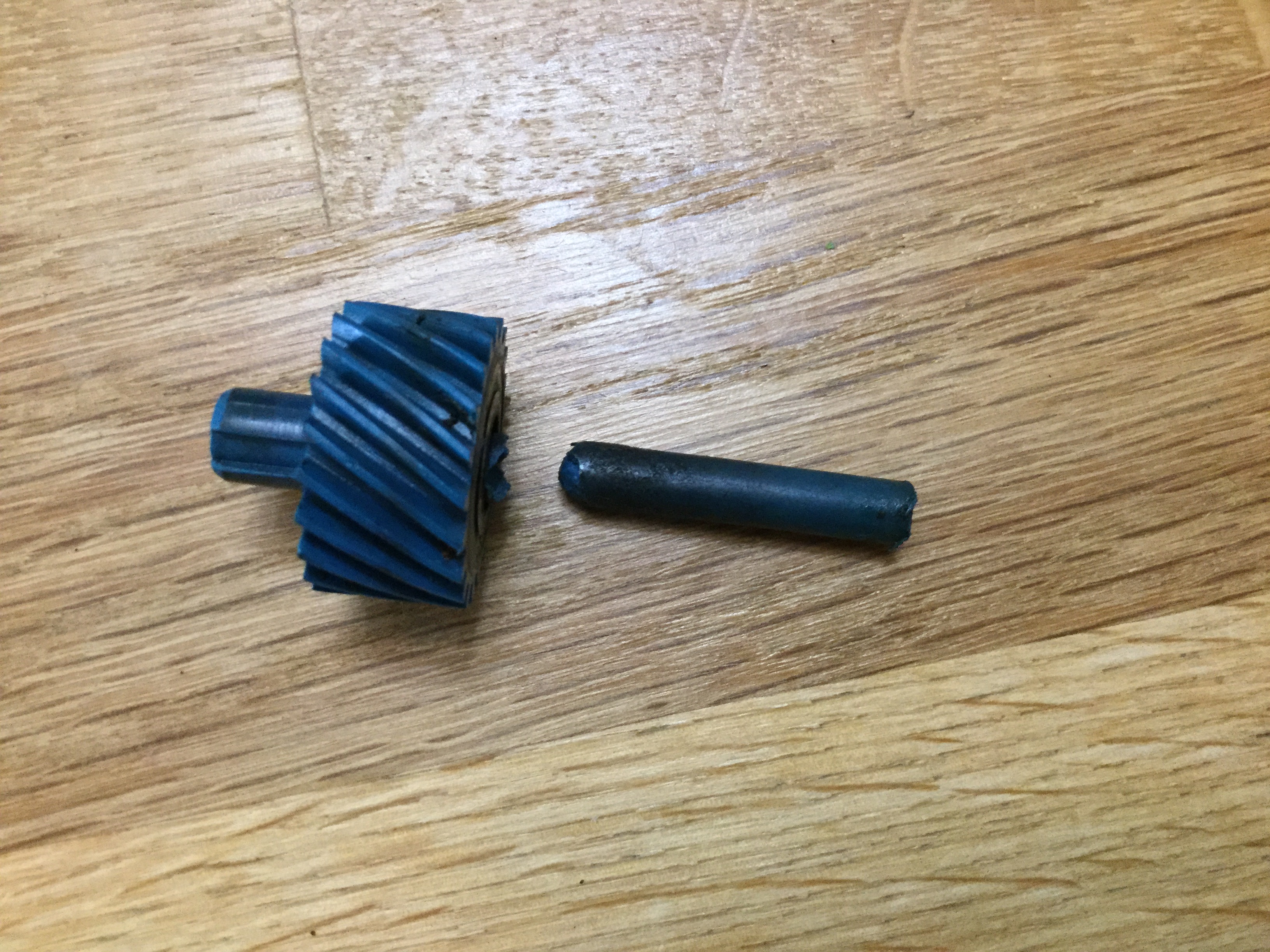

Hi I am trying to track down a speedo cable and sensor (I think it's a sensor or driver ?!?!?) for my 2001 fiat ducato14 motor home. I'vet tried ebay, fiat dealership, scrap yards and europarts but no joy..... I've tried to attach photos of the parts

engine type required and base model would also be good.
VIN even better.
is it a 1.9 diesel?
GEAR
9 600 936 680
That is the part number for the only part that looks remotely like yours on part diagrams . this part has 21 teeth.
when searching that number google images it looks slightly different.
possibly there is a metal sleeve separated from yours jammed in the housing or just not shown in your photos.
FLEXIBLE SHAFT
1 315 432 080
part number or speedo drive cable again only one that looks like what I can see of yours.
good luck

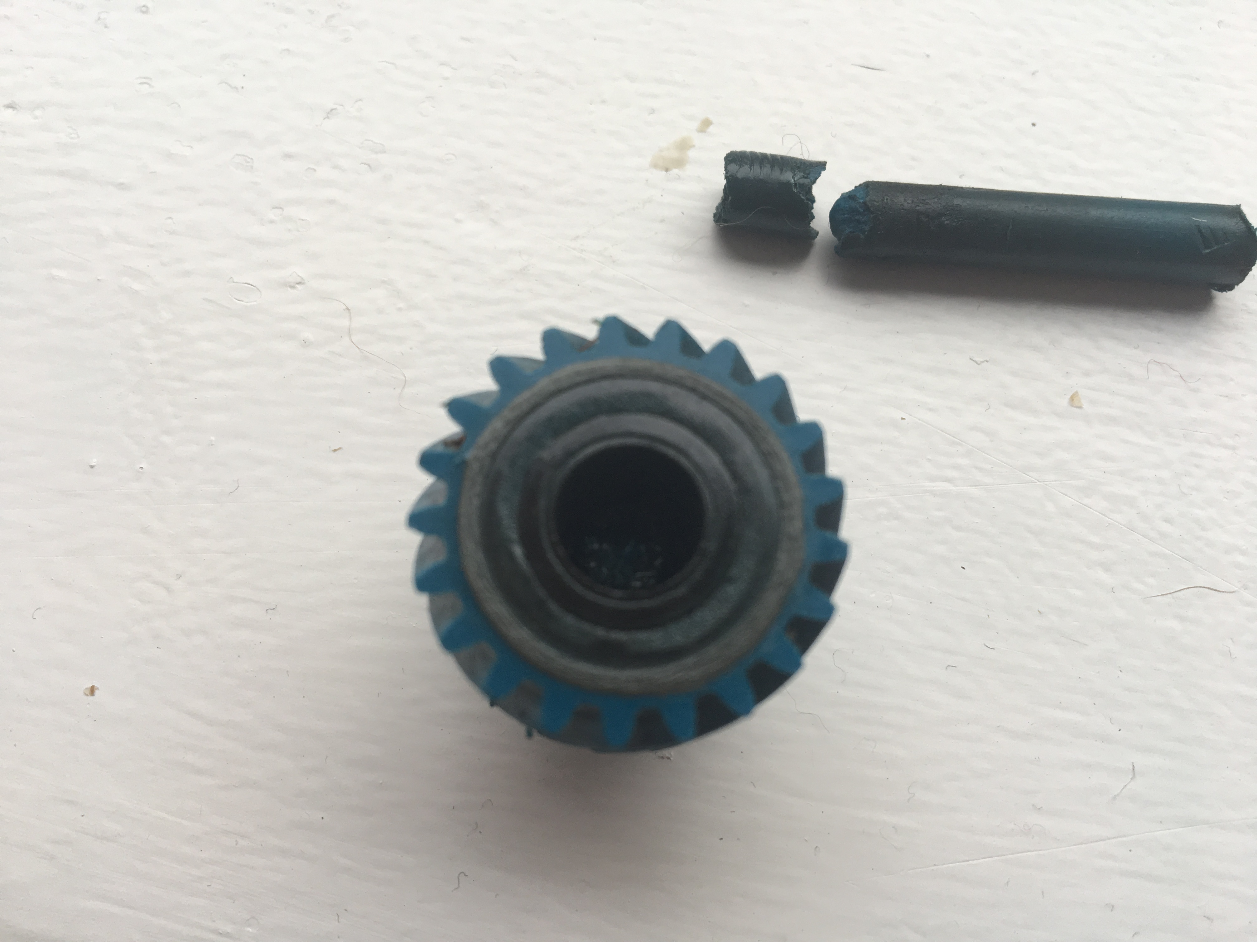

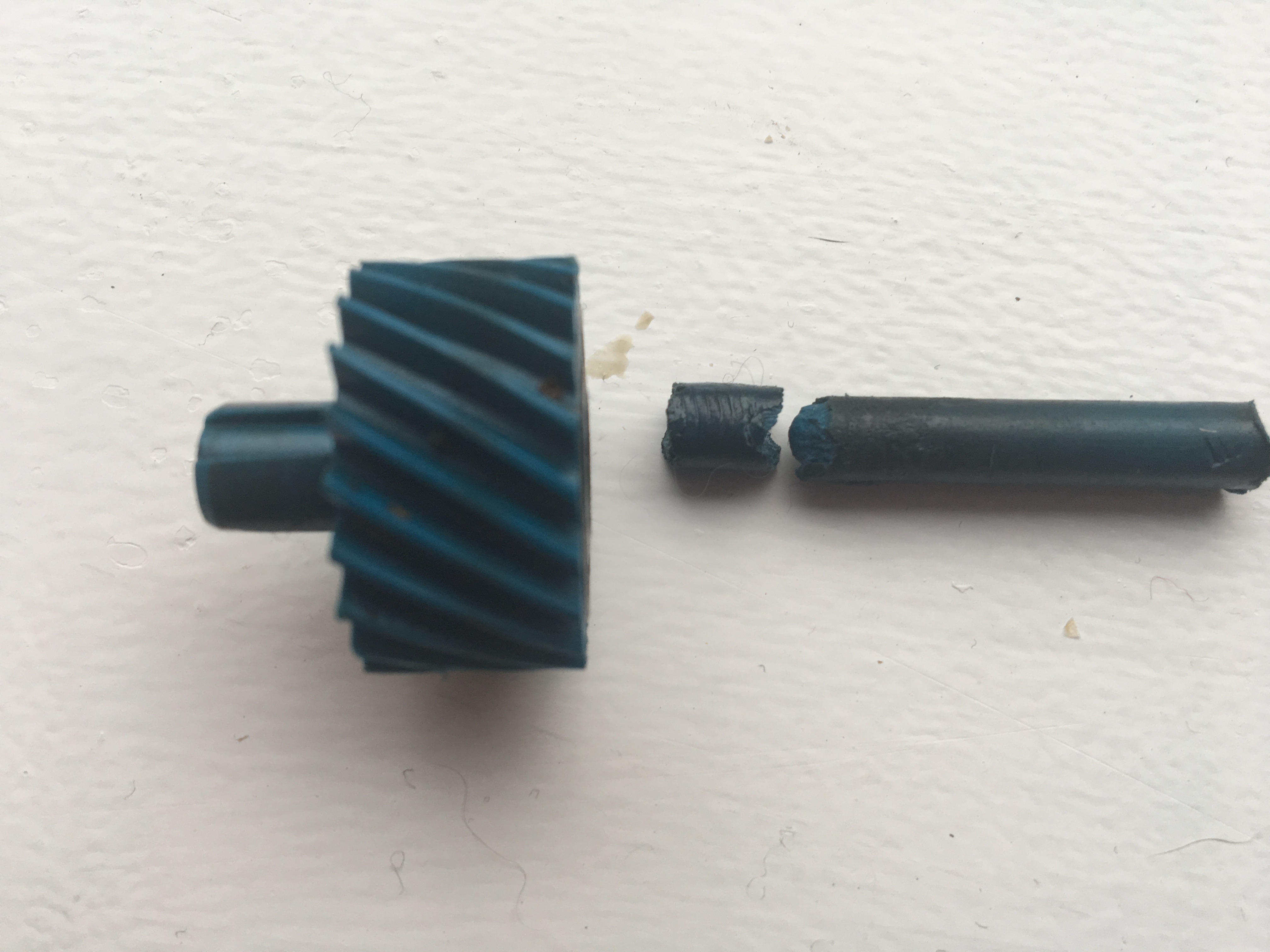

Thank you so much, by teeth do you mean the ridges on the outside of the blue but? It is a 1.9 TD
Just checked has 21 teeth
Here is another
Here is another
Part number is: 9636832480 21 teeth ratio is 27x21.
Unavailable from Fiat since 2015.
Might still be available from citroen for about £10 call citroen and ask can they order part number:2649 52

Base on nealy forgotten experience from many years ago when replacing broken machanical speedometer drive cables, the speedo cable should just pull out of the drive gear, after releasing the cable outer from the gearbox. Typically a square end on the inner cable, inserted into a square centre hole in the drive gear.
