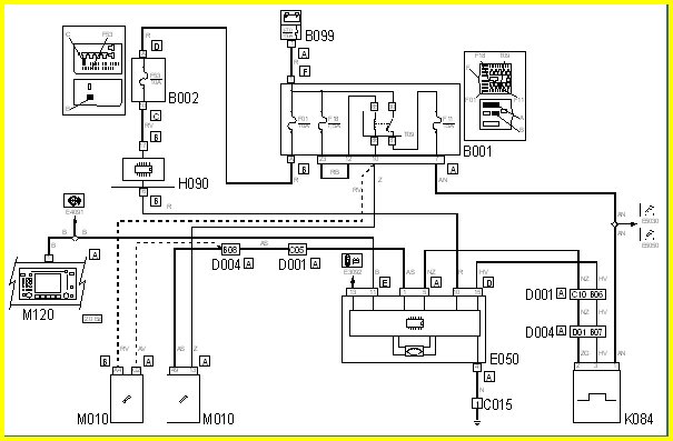

please can anyone help.i need to connect a sat nav to the speed pulse on a ducato 2.8jtd 2006.i dont know how to find or what cable colour is.thank you:)
all versions 2.8 JTD
Control panel H090 is supplied directly from the battery from a line protected by fuses F53 - located in under-facia junction unit B002 - and F01 - located in engine bay junction unit B001 -. The control panel supplies power, from pin 16 connector B, to instrument panel E050, at pin 10 of connector D.
When engine management unit M010 supplies an earth signal from pin 13 of connector A, relay T09 closes its internal contact and supplies sensor K084. The supply line is protected by fuse F11.
Speedometer sensor K084 receives an earth signal at pin 2 from instrument panel E050 - pin 5 connector A -; at pin 3, it sends the engine rpm signal to pin 15 connrector D of the instrument panel.
The instrument panel also supplies a vehicle speed signal to engine management unit M010 - pin 49 connector A - and Connect M120 - pin 1 connector A -;
attached are pics of locations & wiring diagram
Hope this helps
