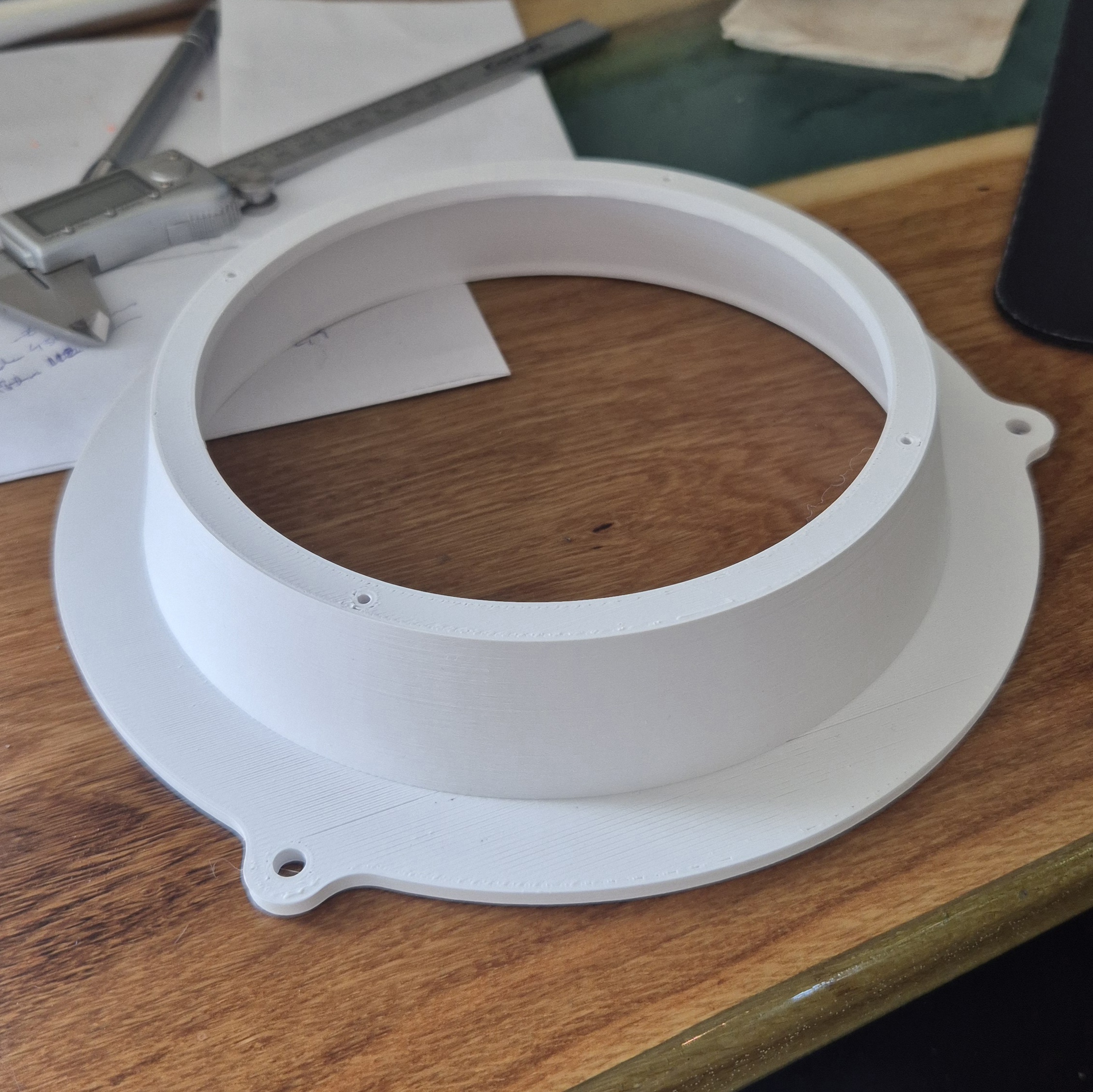

I measured my recently bought adapters. Both front and rear doors can accept 6.5". An 8" could possibly be made to fit in the front doors, but would have to sit closer to the door metal if there is not sufficient space behind the door cards (I presume the front adapters are coned inwards for a reason).
Front adapters:
- Outer diameter of speaker mounting flange: 163 mm
- Inner diameter/speaker cutout: 145 mm
- Screw mount diameter: 155 mm
- adapter height: 37 mm
- outer diameter of door mounting flange: 218 mm
- inner diameter of door mounting flange: 195 mm
Rear adapters:
- adapter height: 20 mm
- outer diameter of door mounting flange: 173 mm
- inner diameter of door mounting flange: 167 mm

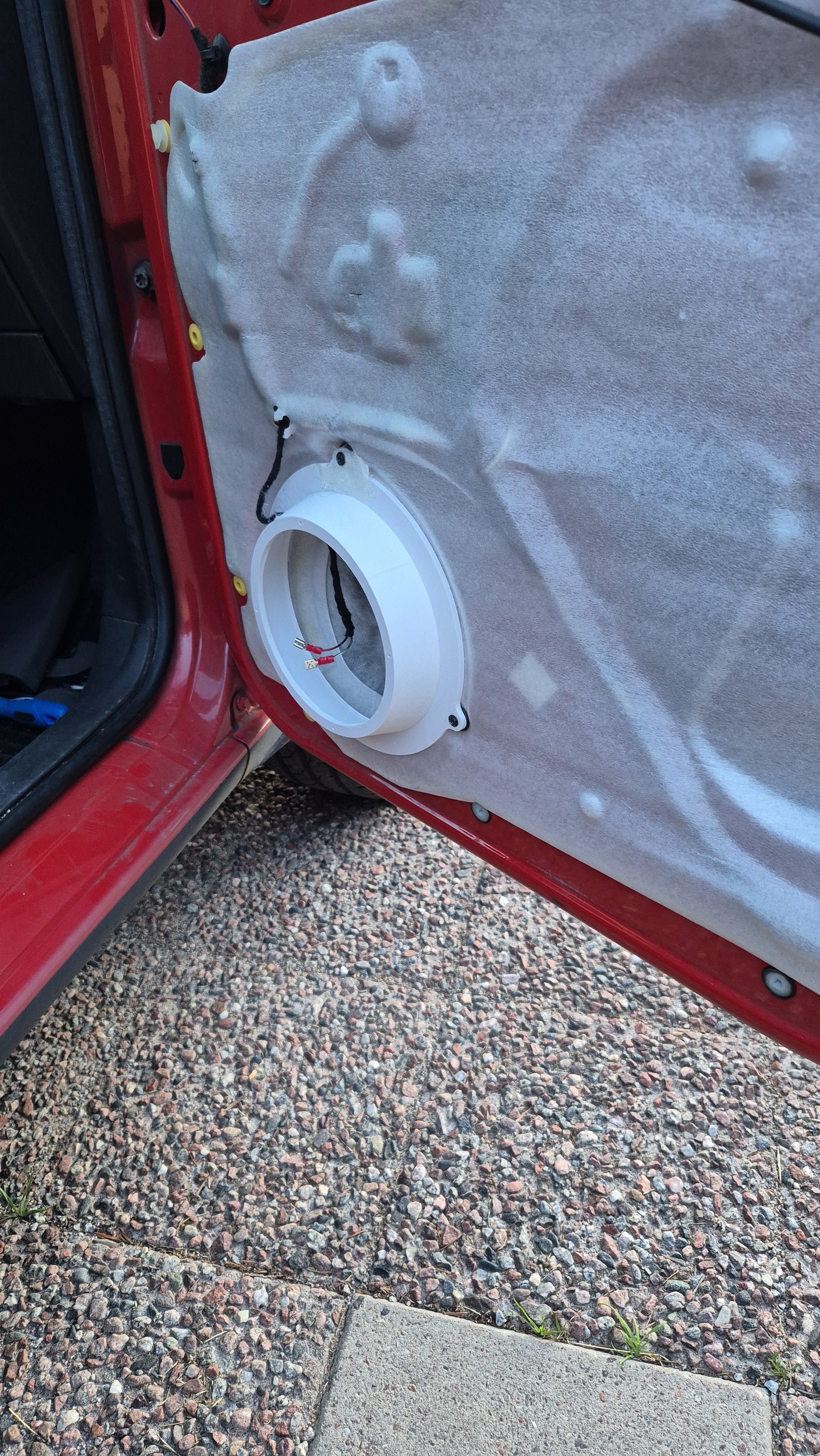

I used your measurements and some additional info for the tabs and then 3D-printed adapters.
I used your measurements and some additional info for the tabs and then 3D-printed adapters.View attachment 469359
Nice job. Might you consider making this design available in thingieverse?

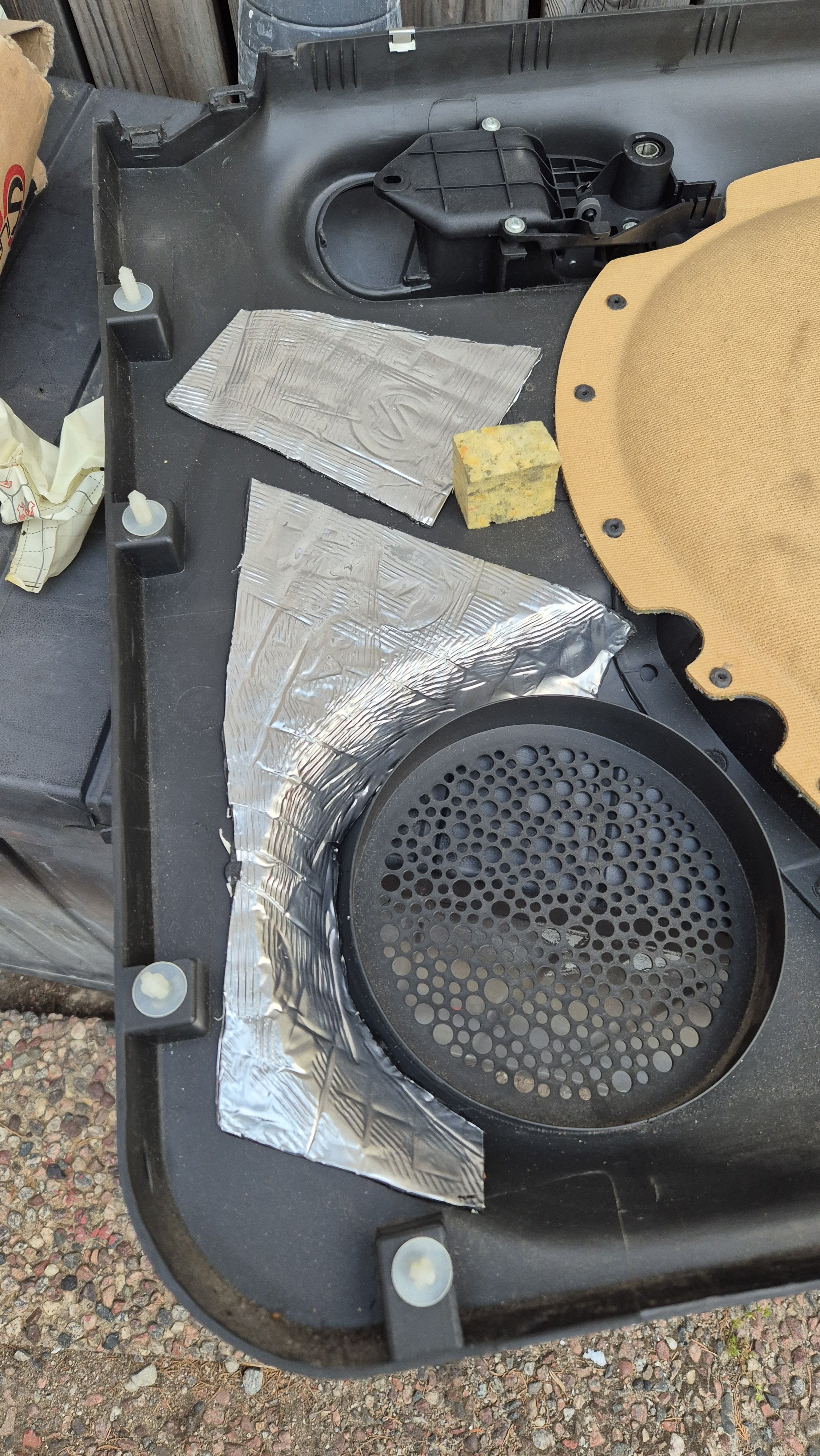

It’s generally beneficial to use a foam gasket to seal the sealer again the door car. This will then make the door card a very loose approximation of a baffle. Adding some felt to the back of the door card (completely covering it, except for the speaker grill obviously) will also help.

Yes yes, will upload them to Thingiverse. Found out today that the three tabs are not evenly arrayed so I need to adjust that on the models before I publish them.
I've added Silent Coat (bitumen) to both the door and the panel. I will spray insulation foam between the panel and the "hard board" backing plate to deaden even more. But not today. 😁
I still have the rear speakers to do. Massive difference now, with the rear swapped too it will sound quite decent.
