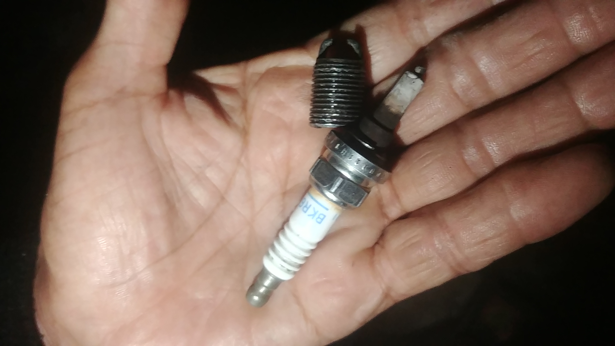

Also after enquiring by NGK as to why my plug broke when it wasn't tightened tight,after giving my car make and model etc they said the plug I've got is the incorrect plug for the car!!!!
Every parts store in Cape Town has this plug listed for the 1.6 stilo!!

NGK is probably quoting the OE standard fit, which is a BKR5EZ, in the UK at least. South Africa could well have listed a BKR6EZ instead.
The 5 and 6 reflect the plug heat rating. The 5 is a hotter plug, since the UK has a temperate or just cold and miserable climate. A hot plug warms up quicker and fires better when cold.. it also burns off soot, since in cold climates cars use more “choke”.
The 6 plug can foul more when it’s cold... which gives less fuel economy/more emissions rather than a misfire... but it can run at a higher temperature before it starts to degrade through heat (the 5 would melt first). So it sounds sensible if you’re in South Africa in summer.. you want a plug that keeps cool, not a plug that keeps hot.
In real life, the difference between a 5 and a 6 is negligible. The heat ranges overlap by miles.. and your plugs don’t look like they’re out of their heat range (sooty or melted respectively).
A too cold plug is also better than a too hot plug.. since a sooty plug is less serious than one that drops molten metal into your cylinders after melting..
Your new plugs are BKR6EK.
BKR6EK are identical to BKR6EZ in all dimensions except that they are twin electrode. Twin electrode gives you more chance of a spark .. the plug fires on whichever electrode gives the least resistance (not both of them at the same time, like the promo photos always show). But it’s still a BKR6.. so it’s fine.
You probably broke the plug yourself when you were unscrewing it, I’m sorry to say.. if the plug socket isn’t on dead square and touching the metal face of the rocker cover, then as you unscrew it, especially if it’s tight, you can inadvertently put sideways bend on the plug body... particularly if the plug is tight and then suddenly let’s go.
The ceramic won’t bend at all, it will crack exactly like your picture shows. It might have been faulty or dropped on the ground before you fitted it.. but statistically... i’ve Only seen a broken plug once, and that was a slip of the wrench when I went to unscrew it, as above.
Any road up.. a plug is a few quid.. fit a new one (same as the others) and why one of them broke doesn’t really matter.

They showed me on the picture that it was previously over torqued.
They only mentioned the BKR5EZ. I enquired now about the platinum plugs if they have for the stilo.
I currently have a previously installed plug in that cylinder. Same type. Looks good still. I remember the set that plug came off I took off prematurely to it failing. So it was still a good plug.

I had a better look at the photo of your broken plug.. I hadn't spotted that the damage was under the hex, not above it.
I've never seen anything like that before... usually the threads would strip (or strip the threads in your rocker cover) rather than shear off the entire plug... so I don't think over-torqueing it is all that likely.. but as I wrote, it's out of the engine and no harm done, so it's not worth worrying too much about.
If they list BKR5EZ for South Africa too, then no worries. The difference between a 5 or a 6 rated plug isn't going to change things so that you would notice, except at extremes of engine temperature. You could put some BKR5EZ in there just out of curiosity.. but you won't spot any difference at all.

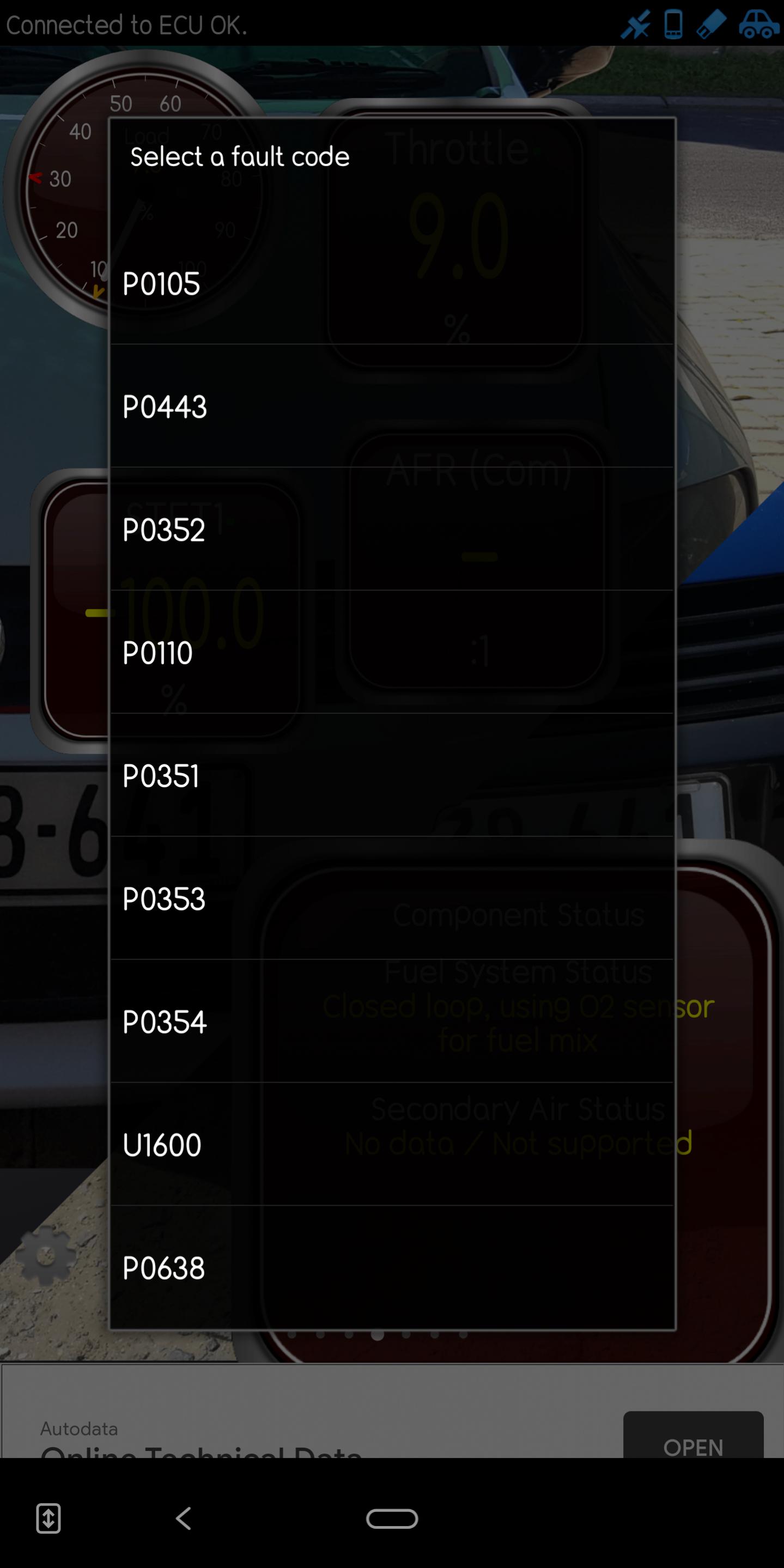

Hi so ive been sick in bed and partners father took him to work this morning with the car.
He mentioned that the car just switched off(in traffic) and wouldn't start after the first try.
Partner also mentioned the car did not want to drive.
I was like what the hey! Anyway take out the scanner and plug him in to see if codes were set. P0638 was set again. In my pic i sent before you can see it's the 2nd time this code is set. I am going to clear it and drive again as normal and see what happens. If it keeps on coming back could our problem lay with the throttle body itself or is a ECU upgrade needed?
Thank you
The P0638 fault is related to the throttle body.. no surprise there I suppose.
I remember that you've cleaned your TB to death, so I doubt that the spindle/potentiometer or the valve are sticking... but it's worth a double check while you have it in pieces.
It's more likely to be a wiring issue though, since you had the ECU brownout a day or two ago. Check the wiring to the TB looking for any damage, especially anything that could cause a short circuit or loss of earth. Trace it back to the fusebox and the relays.
It could you have something loose, dirty or corroded around the fuse box on top of the battery. Anything showing fresh air around the wheel arch liner allows spray from the road wheels up into the bottom of the battery and fuse box area, so even if you have the battery and the separate fuse-box covers, usually the worst area is the under-side.
Before you pull all the fuses and relays out, mark them all up (the relays at least) and take a photo of where they fit, so you have a chance to get them back in the right place. You need to clean the female pins in the fuse tray (easier said than done) and also as far as you can, check the condition of the wiring where the spaghetti emerges from out under the tray.
Ralf S.
Ralf S.

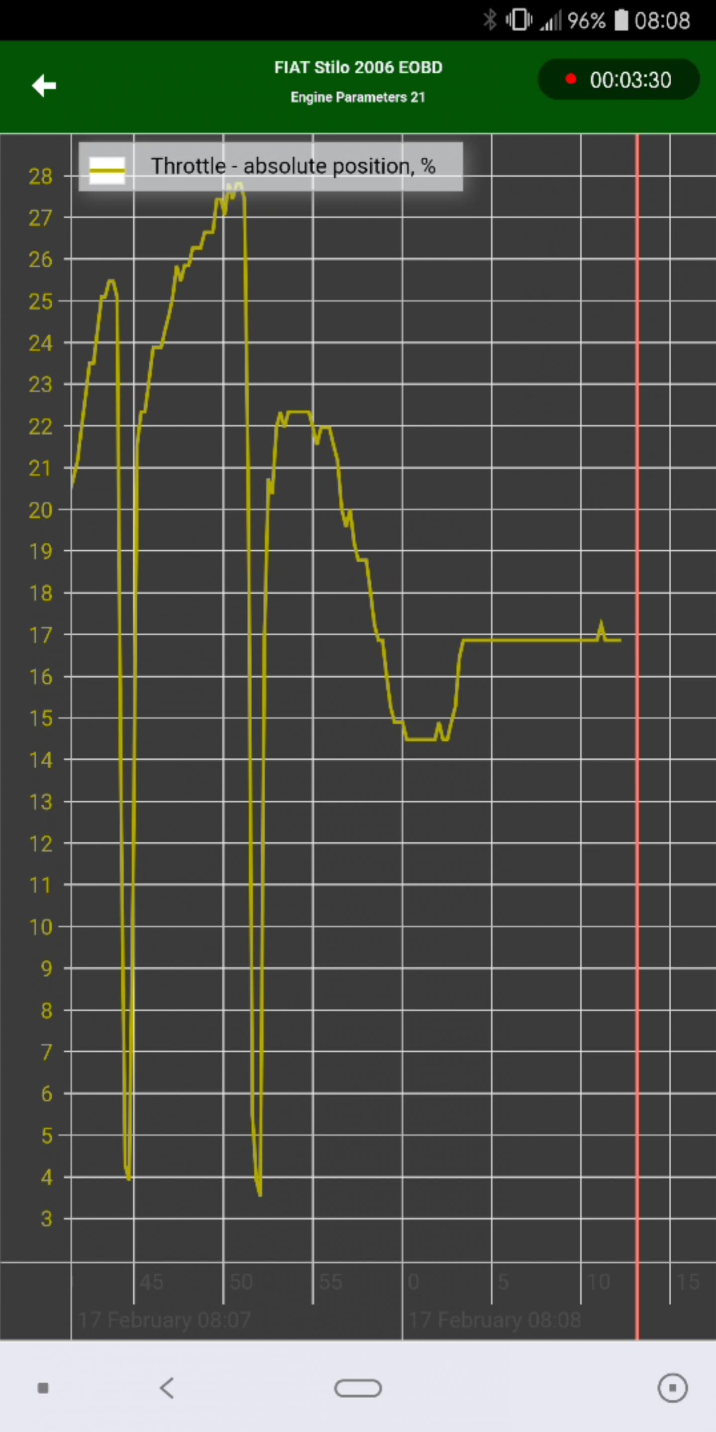

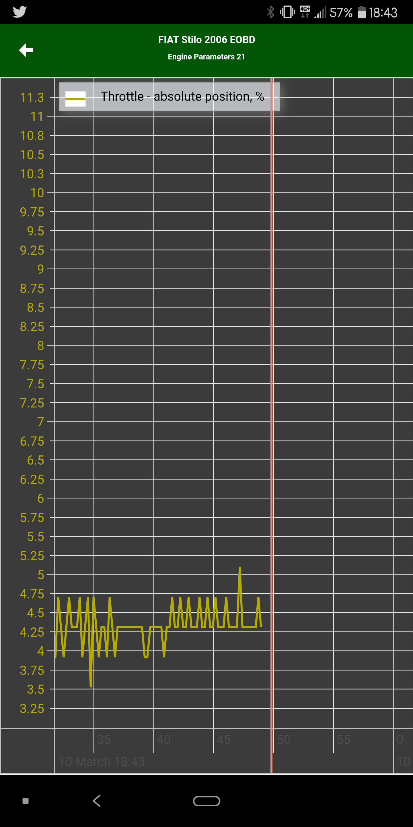

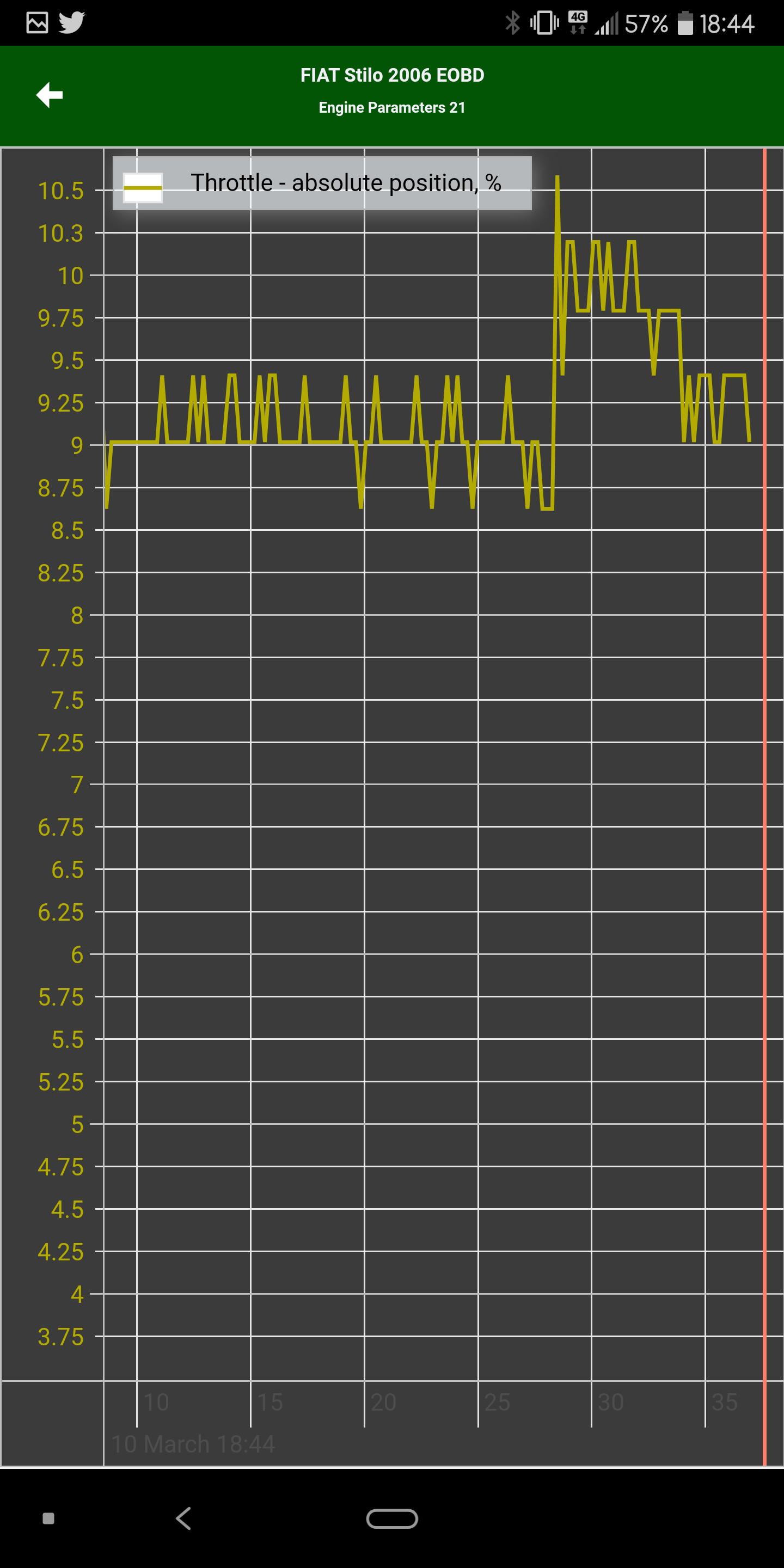

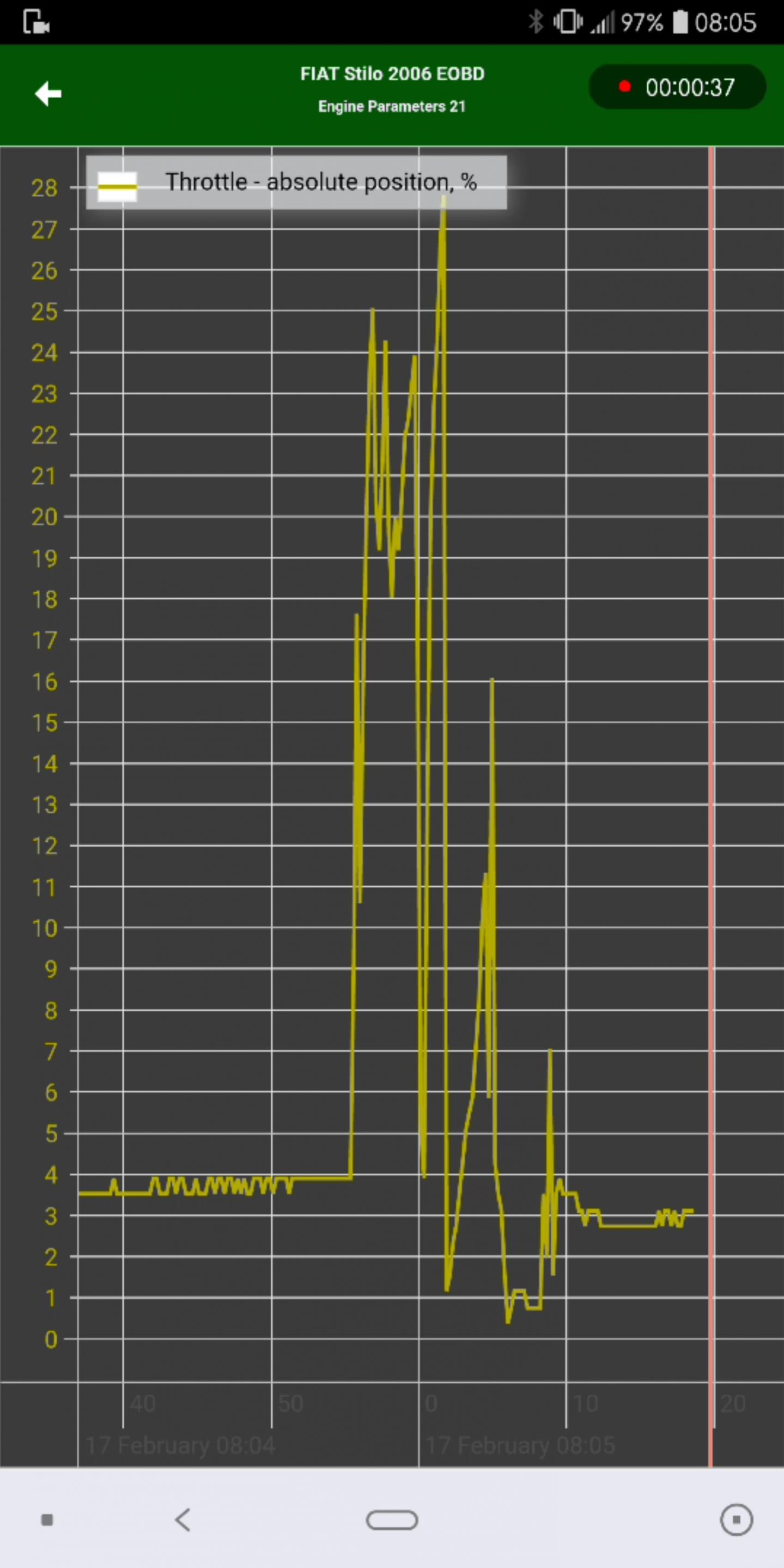

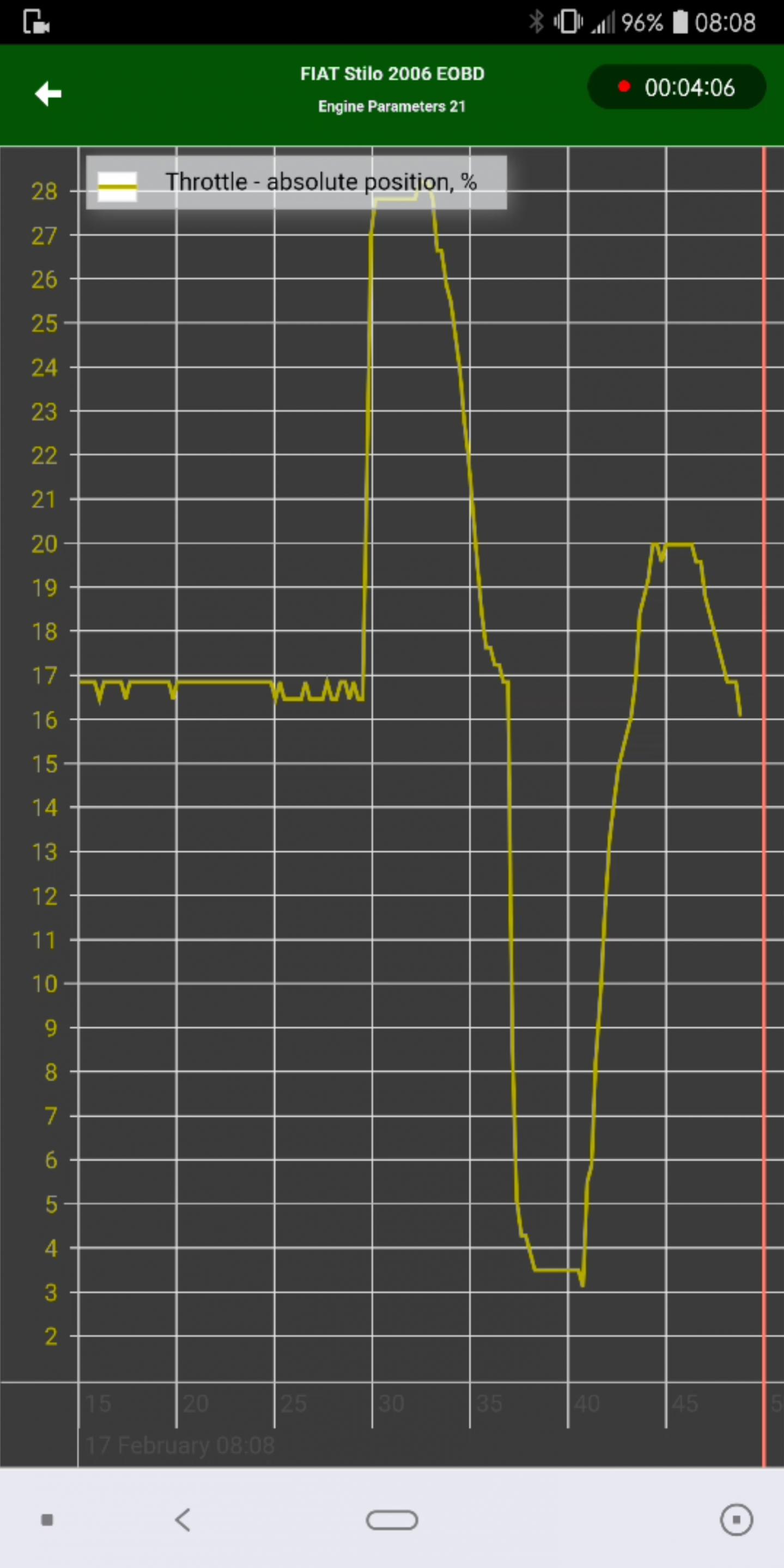

Hi so while driving on high way and I want to accelerate to overtake,it feels like clutch engaged halfway,like the car revs up but does not accelerate. Like the clutch is halfway engaged. But the pedal is fully up. I didn't press the clutch on accident.
Then dropped someone at home and then car didn't want to rev. Check engine light. P0638 again. Reset and it was fine.
I had fault regarding clutch switch. Could my performance(surge and poor acceleration)symptoms be because of this switch? Does the stilo have electronic or cable clutch? That the switch telling the ecu the clutch is being pressed when its not.
This only happened when i want to overtake or speed up. When at constant it doesn't do that.
Thanks
Thanks

The 0638 is related to the throttle body.. it doesn't sound like it's linked to the clutch slip or the switch error.

I've got a better software to log data(using a elm327 obd2),decided to see what the throttle is doing because its becoming more and more clear that something is going on there and almost everyday she goes into limp mode especially after starting with no acceleration and only revs up until 2000rpm. Then I must clear codes and switch off then on then i can go. Sometimes she runs in open loop because of a system failure then I reset codes that may be lingering then im back to closed loop.
Anyway,logged some data while driving and wasn't happy with what I saw. Forgot to video or record the data. Found a pic though of what mine looked like. It would go kind of smooth and then would spike either negative or positive and then smooth then at idle the graph wouldn't lay flat, it had drops here and there. Sometimes when driving it would drop down to 'closed throttle' and back up.
Also past a certain point on my pedal,the throttle body is dead as if that was WOT. I could push her to the floor after that point and no change. Like a complete dead spot. Hence remember when I mentioned in other threads that she does not rev to her limit.
Putting motor straight onto positive and negative terminal,she goes completely open and completely closed when I let go off terminals but the problem i think is lying with what is telling the ECU what the angle is of the throttle,the TPS. Not the motor in the throttle body.
Could this have been our problem all along and wasn't setting a code until now?
Here's the pic,however mine read in percentage but a bad waveform like that is what she showed. Maybe but more spikes
Thanks for the help

Btw I have got a code for clutch switch once or twice.
No I don't have cruise control and yes it starts without clutch pressed in.
Anyway screengrabbed some live data. Will post on you tube so you can see in video form what's happening.

Heres more pics of my throttle body readings.
At 9% is the car at around 2000 rpm.
At 4% she was idling.
Just posting these pics so you can see and tell me if my TB is bad or not
Thanks
