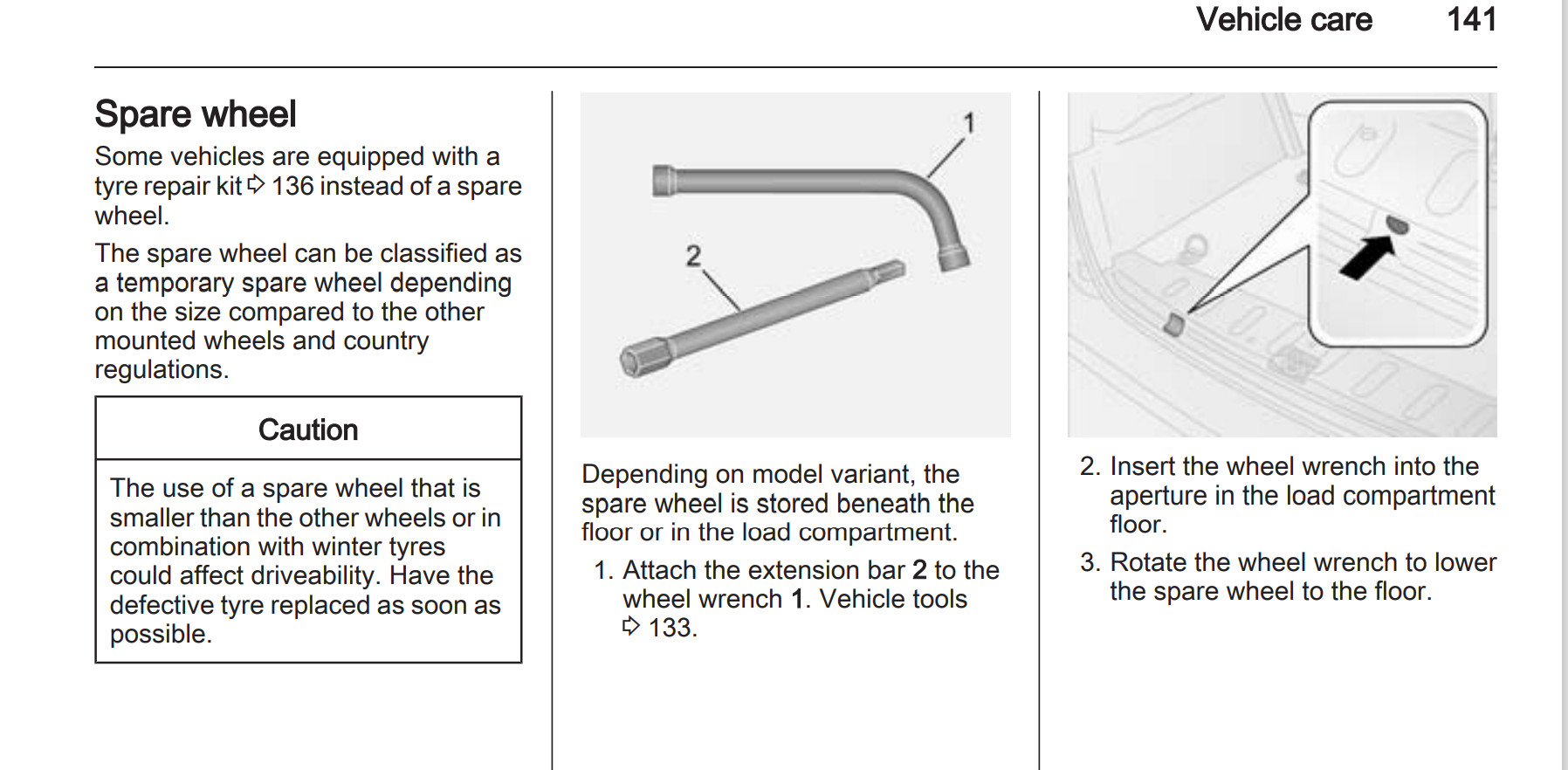

Just.found out that there is no spare wheel or anywhere to put.one... is there anyplace to buy a spare wheel carrier.for.a 60 reg 1.3 multijet doblo van...tia
Look under the back end of the van, the spare in mounted there, there is a hole in the rear bumper when the rear nearside door is open that allows the jack handle in to lower the wheel to the floor.
What? A doblo multihet? There is nothing there
Just looked in the handbook, some were supplied with a repair kit, others with a spare wheel and carrier.
Mine is rebadged as a vauxhall combo 2013 and has one, the only thing non fiat on it are the vauxhall badges.
