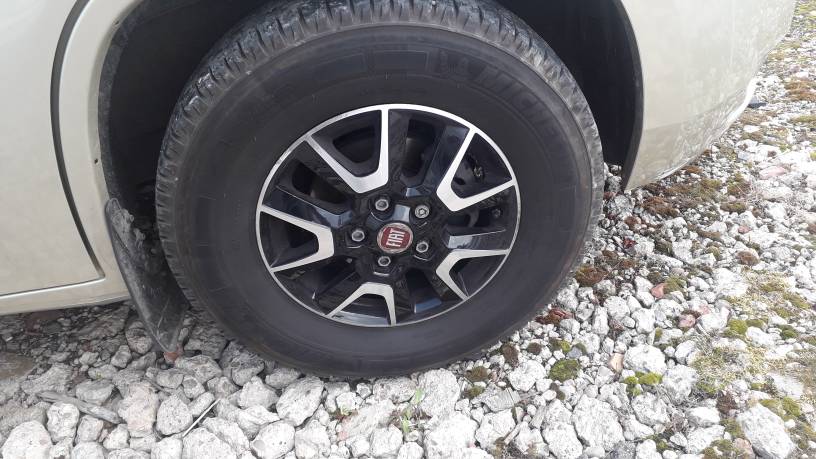

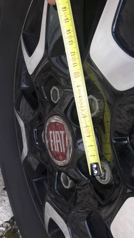

Thank you for that update. I have attached my pics for any help. My van is a swift conversion. 18 plate. I will look at the axle weights under the bonnet. That's a great help. I now Hope the winch fits after all this. Cheers [emoji106][emoji106] 20210803_115450.jpeg20210803_115708.jpeg
Thank you for that update. I have attached my pics for any help. My van is a swift conversion. 18 plate. I will look at the axle weights under the bonnet. That's a great help. I now Hope the winch fits after all this. Cheers [emoji106][emoji106]View attachment 219506View attachment 219507
They look the genuine Fiat 5 x118 alloys to me
Thank you for your help mate. [emoji106][emoji106][emoji106]
