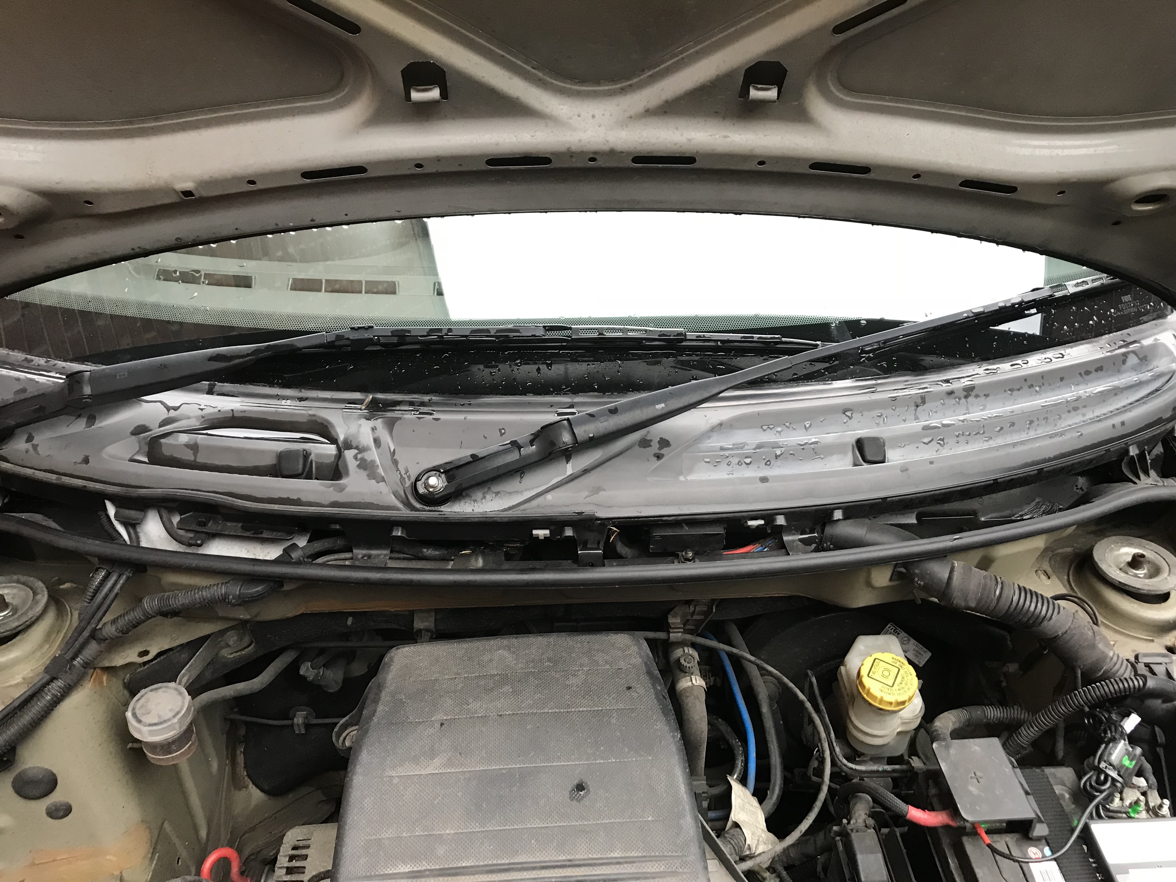

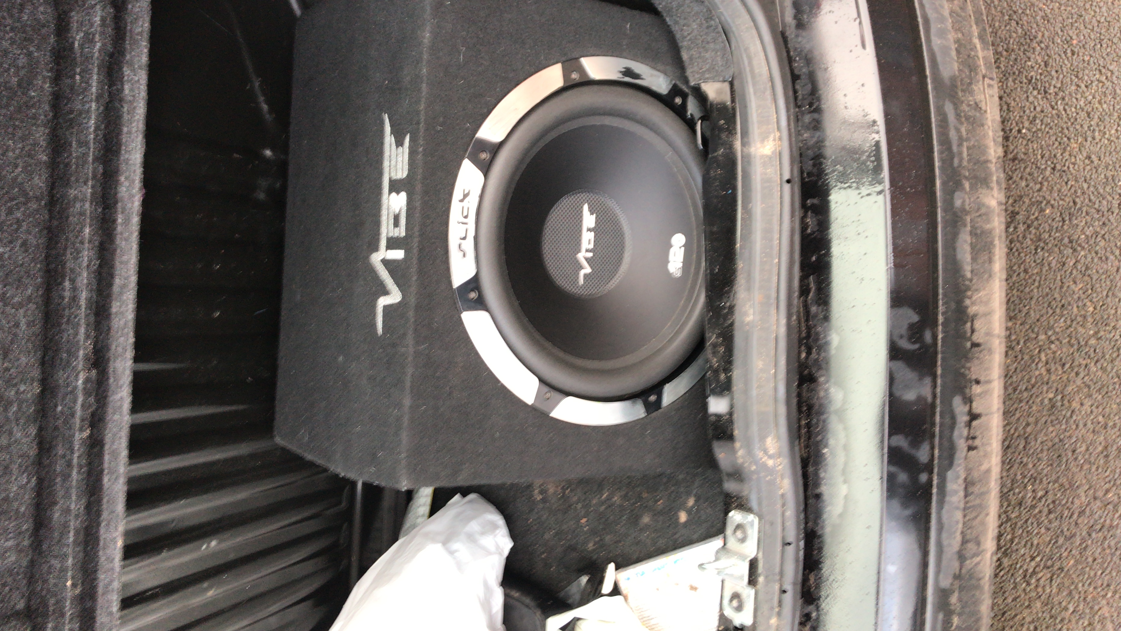

When installing the sub i struggled to find the firewall gromet but after some research I found that it was under the black trim with the washer jets and wipers on, this was held on by a few screws (4 i think?) and a load of clips, this pulled straight off (after removing wipers) to reveal the firewall grommet, I just cut a hole in this and pushed the power wire through for the sub which I then pulled from inside (You can see the grommet from the hole behind the glovebox), from here it was really easy, ran the power cable to the boot pushing it under the trims. For the ground in the boot i've used the rear seat (I think this was a 15mm bolt - Same as wheel nuts)
The rest of the sub install was simple, I ran the 12V power cable from the battery along the left hand side of the car, and I ran the RCA and Remote cable down the right plugging into the back of the head unit in the appropriate places.
Overall, its sounding amazing now! even though I only have half a boot its worth it! :D
